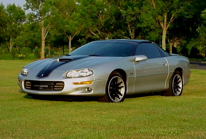

My buddy had all aluminum had sanded the spokes, taped everything off....here's a picture....

if you do it right paint hold up quite well. the hades and most inprotent part is preparing the metal. you want to remove all contaminants from metal. sand or bead blast. then etch, then prime twice. and paint. i used an industrial grade paint. i cant find a chip after three years. i have to warn you though..........you'll be cleaning black every day. does not look good with any brake dust on it.
.........tk 14 ss.....those look hot!!!
