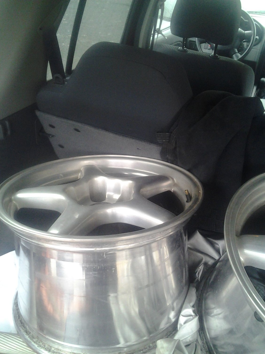

Picked these up for less than a hundred bucks. After some fronts now, and then some powder*
