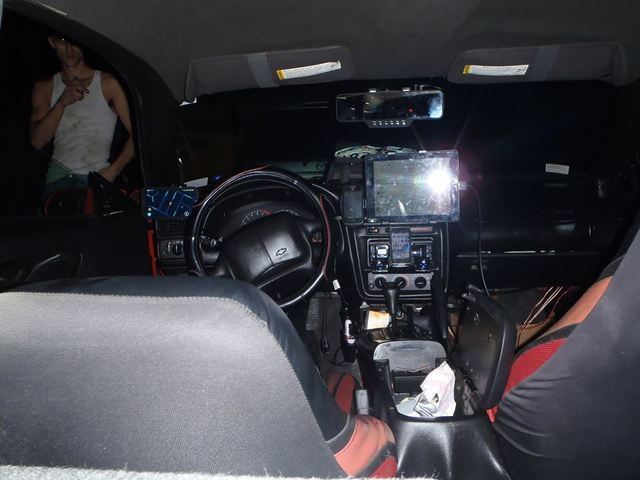

Current pics: After T-Top & Halo Light Conversion
