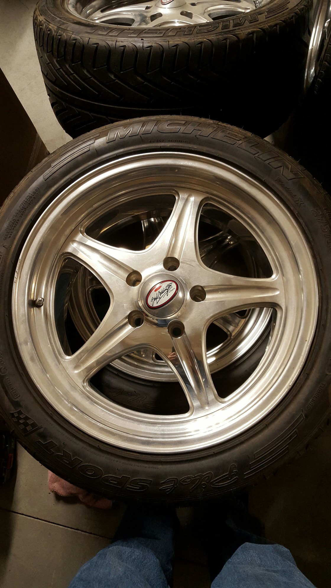

What do you guys think it would cost to fix this wheel. I picked these up dirt cheap and this is really the only issue with them.

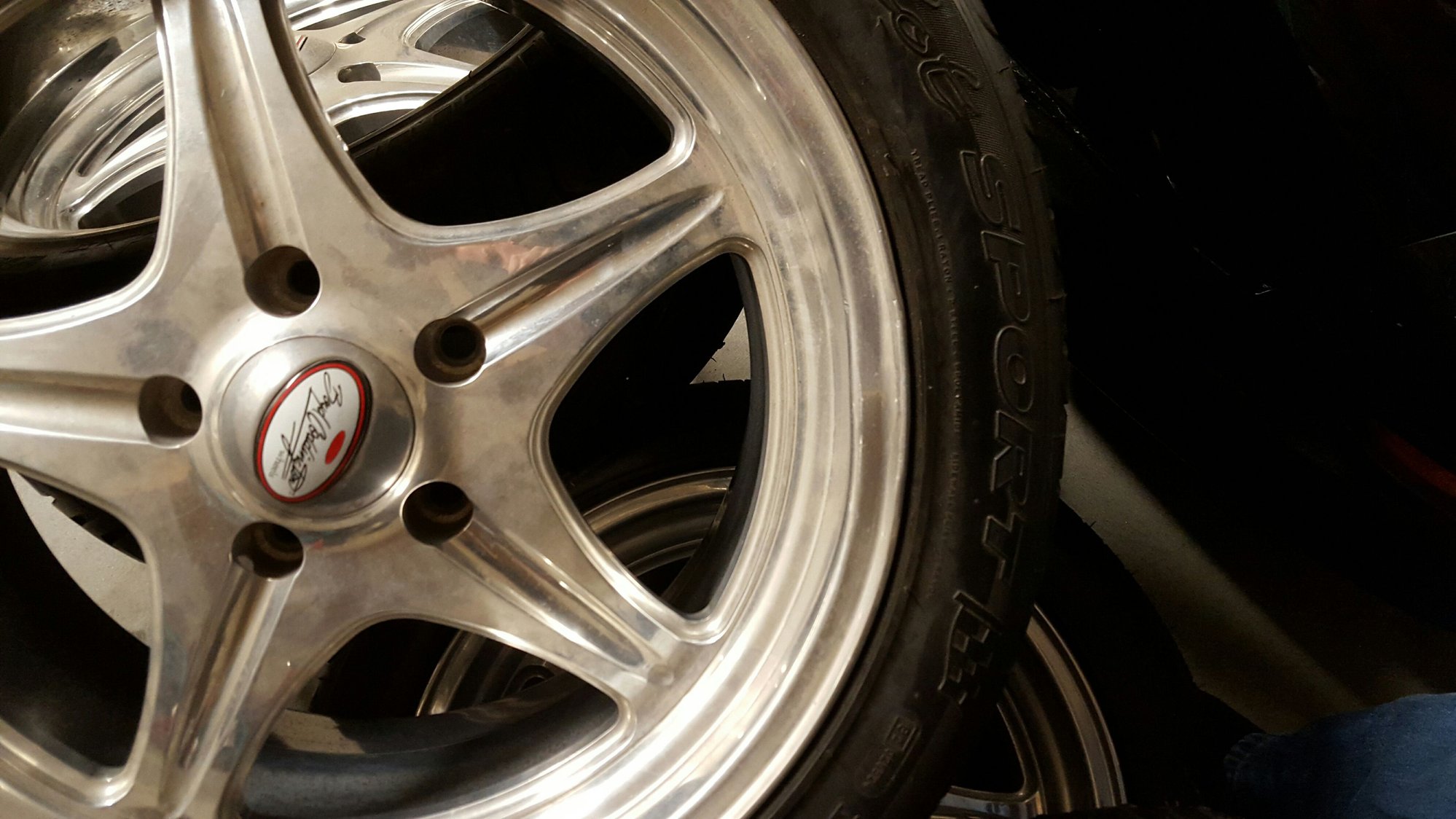

Are you talking about that little bit of "curb rash"?
Get yourself some wet or dry sandpaper and a sanding block. Start with 400 grit, maybe, then 600, then 800. After that, use a Mothers 'power ball' and either Mothers or Blue Magic polish to finish it off.

On the first pic there is a dent on the far right. It is slightly out of round.

$125 to straighten and polish the 1 wheel

I was hoping around a 100 bucks. Thanks for the info. I wonder what the name of these wheels. I'm curious what they are worth all cleaned up.
I noticed it, but it's not that big a deal. It can happen when mounting the tires. Get a wire brush, because they have long, strong handles, and put the long end of the handle against the "dent". Then hit the other end of the brush with a hammer.....the dent will move out.

Here's my local wheel repair company:
http://hubcapnwheel.com/
They've got a lot of interesting info on their site about the repair process as well as a price list...

depends where you are located in the tristate we have plenty of good places around to take care of that.. $125 a wheel

I will try the wood brush handle. The more I clean up these wheels the more I like them. I as thinking of flipping them but I might keep them.

I'd recommend a good sturdy rubber mallet or dead blow. Shouldn't affect the finish and might get it pushed out a bit.
