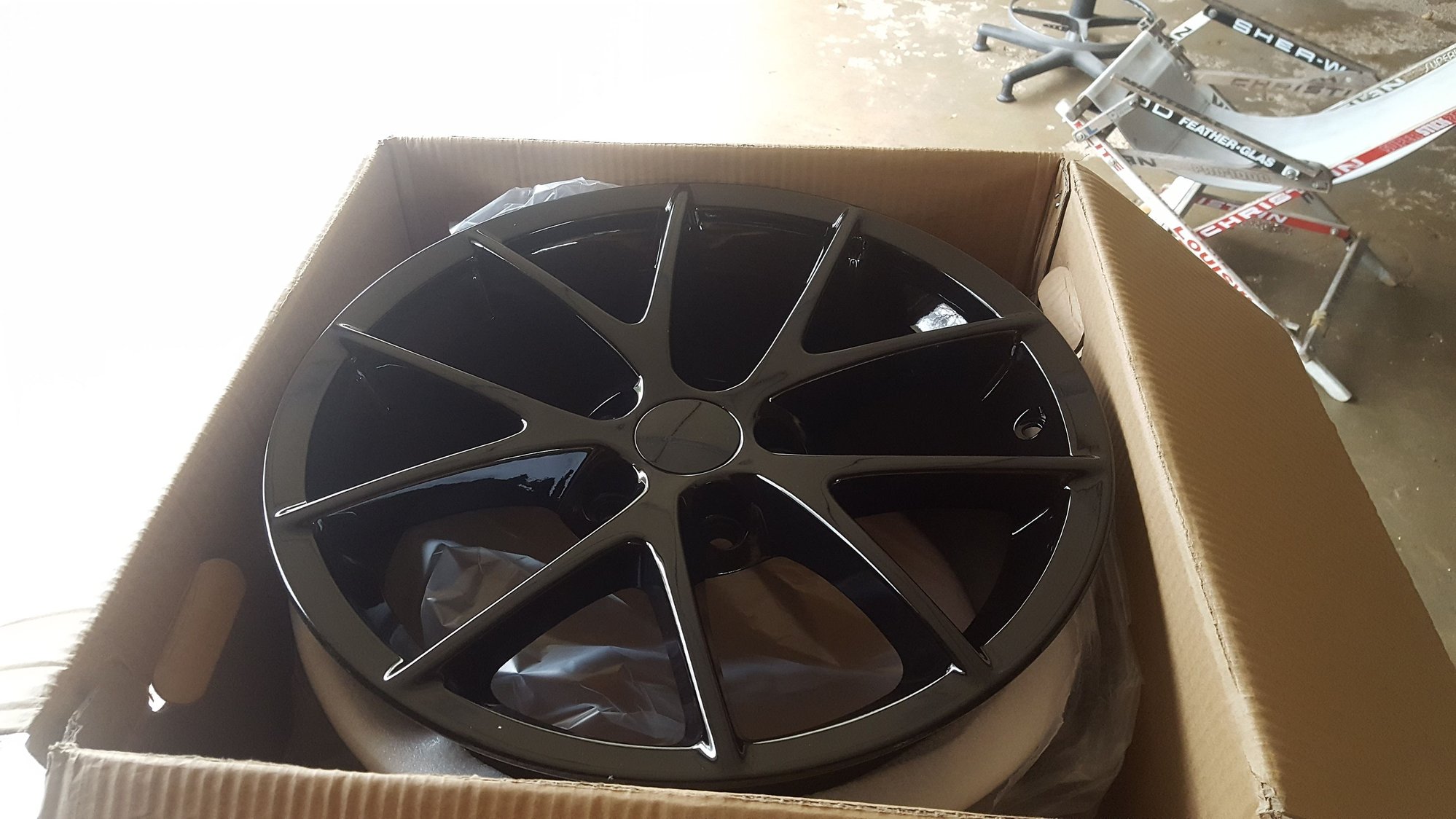

1998 black Z28 Vert with black top. I bought a set of black 18 x 9.5 56mm offset Z06 Spyder Factory Reproductions. Also have Strano Springs waiting to be installed. Car is only driven in summer.
Based on what I read, biggest tire in front without issues would be 275 or 285 35 18. Anyone run a bigger tire on rear then front 18s? I'd like a slight rake on the car with rubber tucked in nice and tight.
I'm open to tire brand and size suggestions.

Nice looking rims. Where did you buy them?
6literdesigns. Got em mounted today!!!
