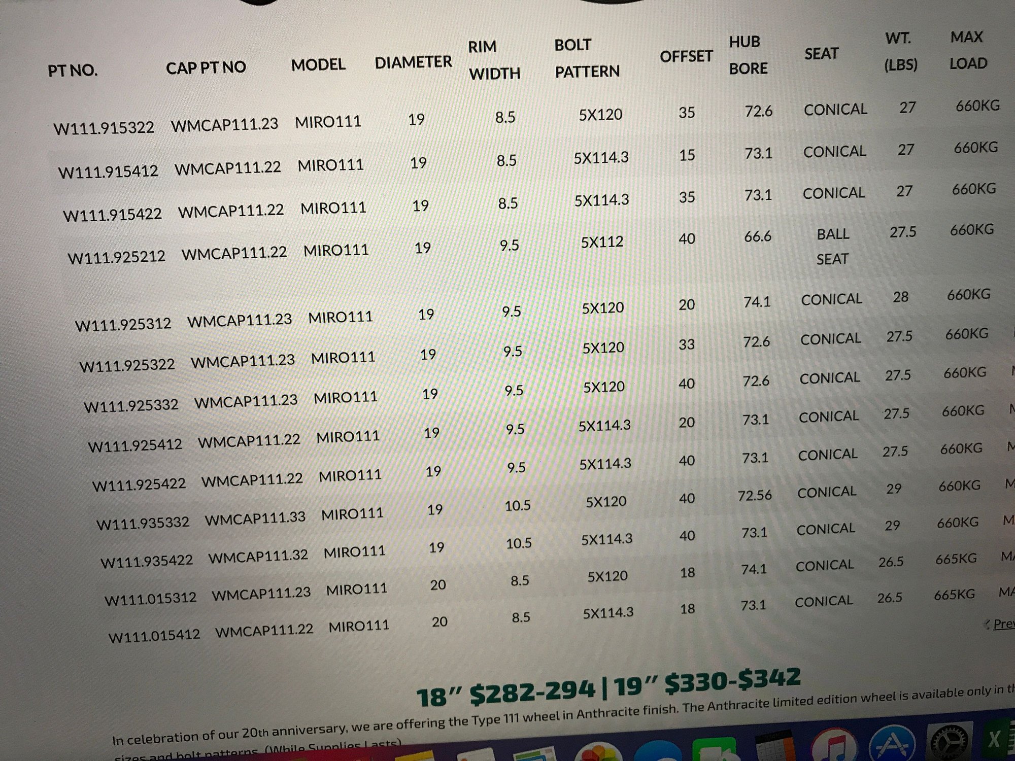

Hey wanted some help. Looking into these wheels and looking for offsets.
Im going 19x10.5 in the rear and there is only 1 offset (40).
Im going 19x9.5 in the front and there are some choices (20,33,40)
Anyone chime in for some help? Thanks

40 on the rear and 40 on the front will tuck the fronts 1/2" compared to a "square" set up. The 33 on front would look closer to a "square" set up. It is the outside of fronts that rub on anything under a 7 5/8" backspacing.

just do a square setup. not worth the hassle for 1" of rim width from a 10.5 to 9.5... no reason for a staggered setup
