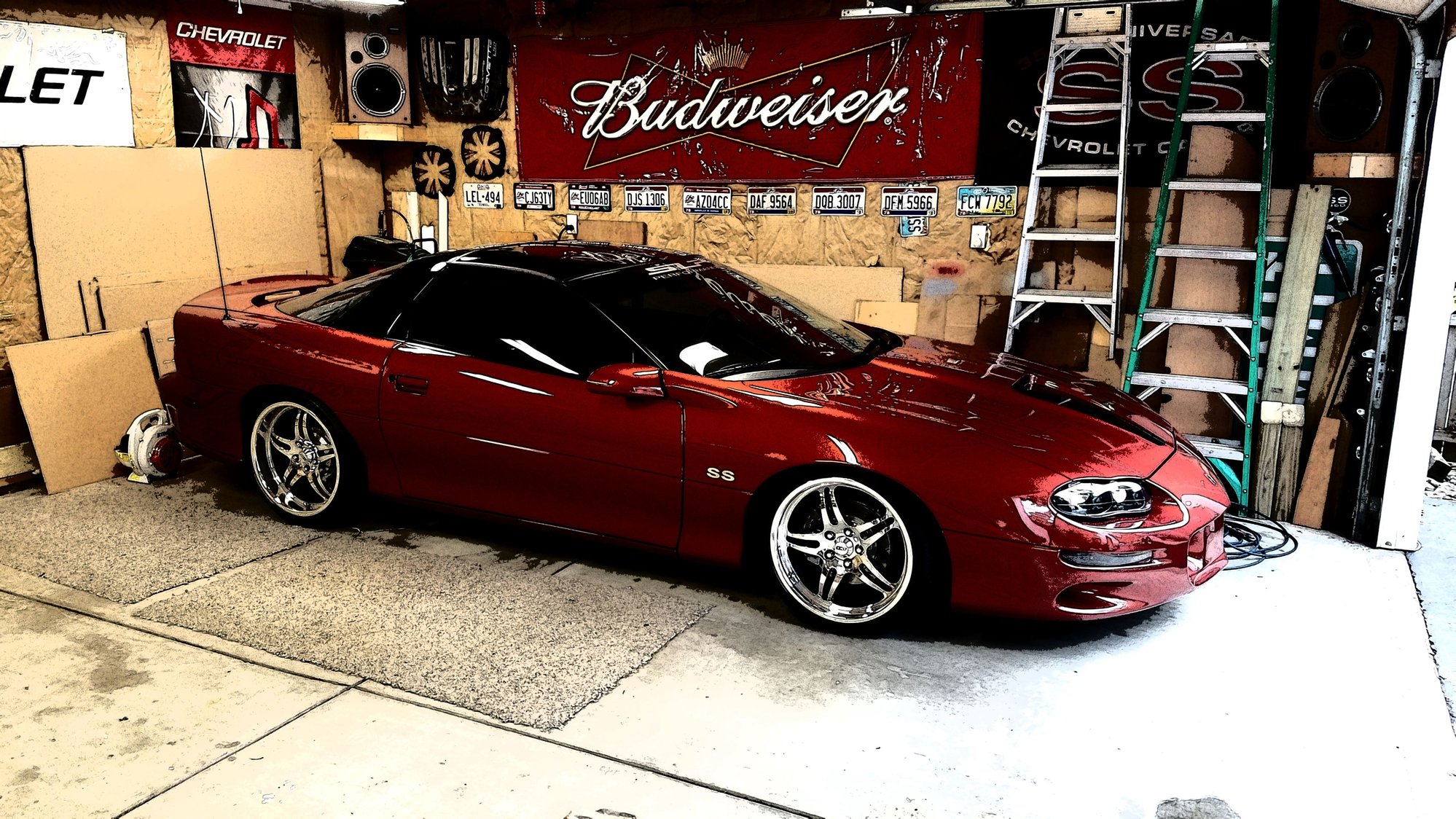

CCW will make you wheels with custom offset where you won't need to run spacers. I'm running 19x8.5 wheels up front with 40 mm offset 245/35/19 tires and they fit perfect!

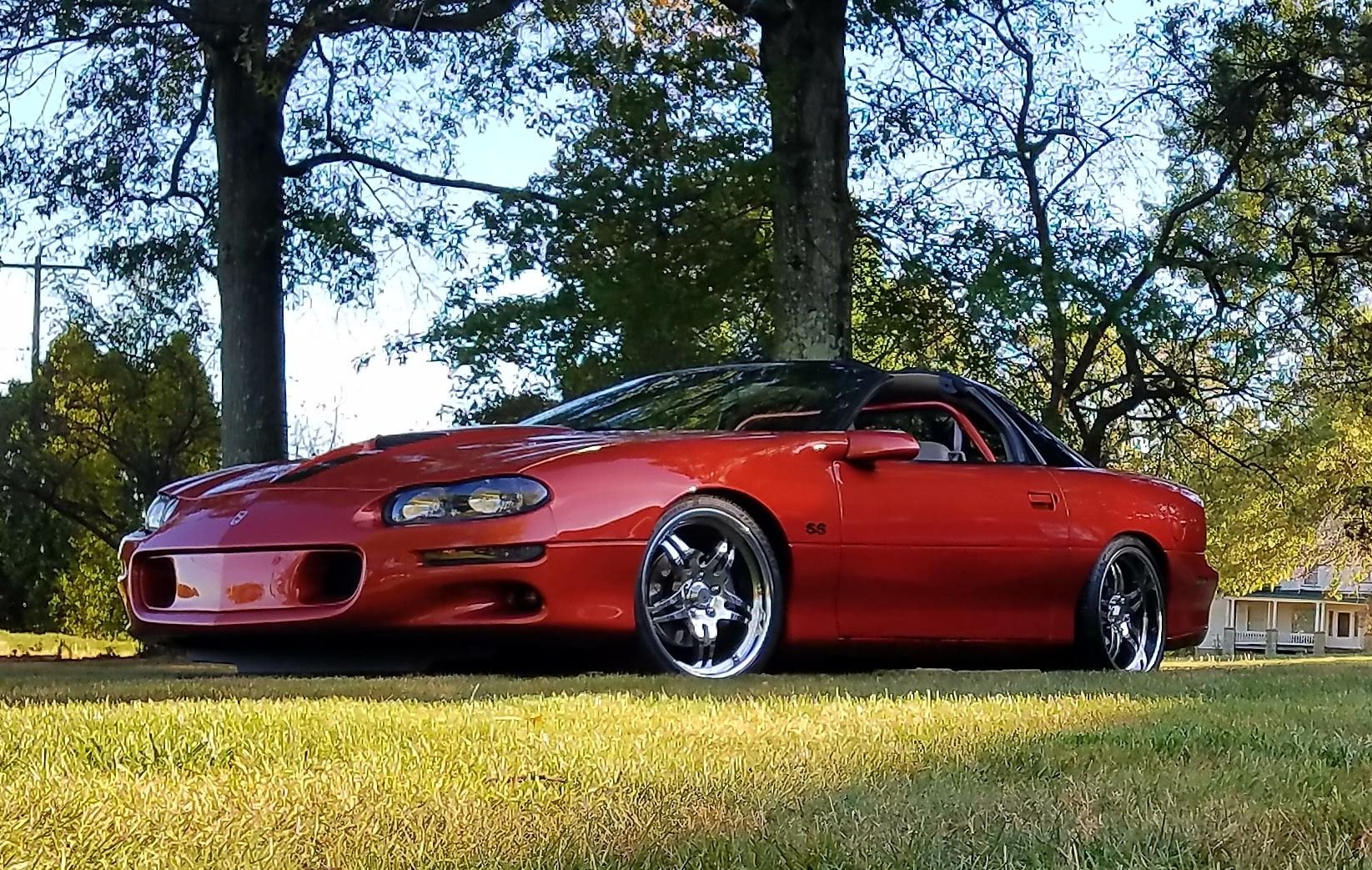

I run 19x10 AND 19X11s with 275/30 and 305/30s
don't ask me the offsets cuz I don't know lol, just call CCW
I'm pretty slammed also, no rubbing issues
