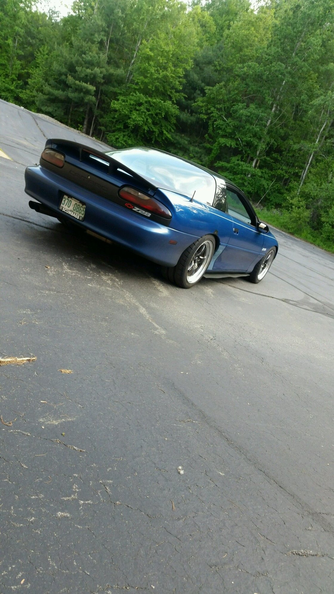

I'm running nitto NT05's on my car, 295/35 on all 4 corners on 18x10.5 wheels and love them. get about 5 seasons on a set (I rotate front to back every season). I agree with blk97z28 about the front tire size, but would say do a 35 series on an 18" rim instead of a 40 series that way the tire height front to back is the same( I'm guessing he thought you had a 17 rim in the back too). you can fit a 295-315 on a 10.5" wide rim, my 295s have a very slight stretch on a 10.5" rim but it is barely noticeable. 315 will need some massaging of the wheel wells and rolling the fenders, depending on wheel offset a 295 can tuck in there without all that
Correct I thought he had both 17's. Nice pic! Tires look awesome!
