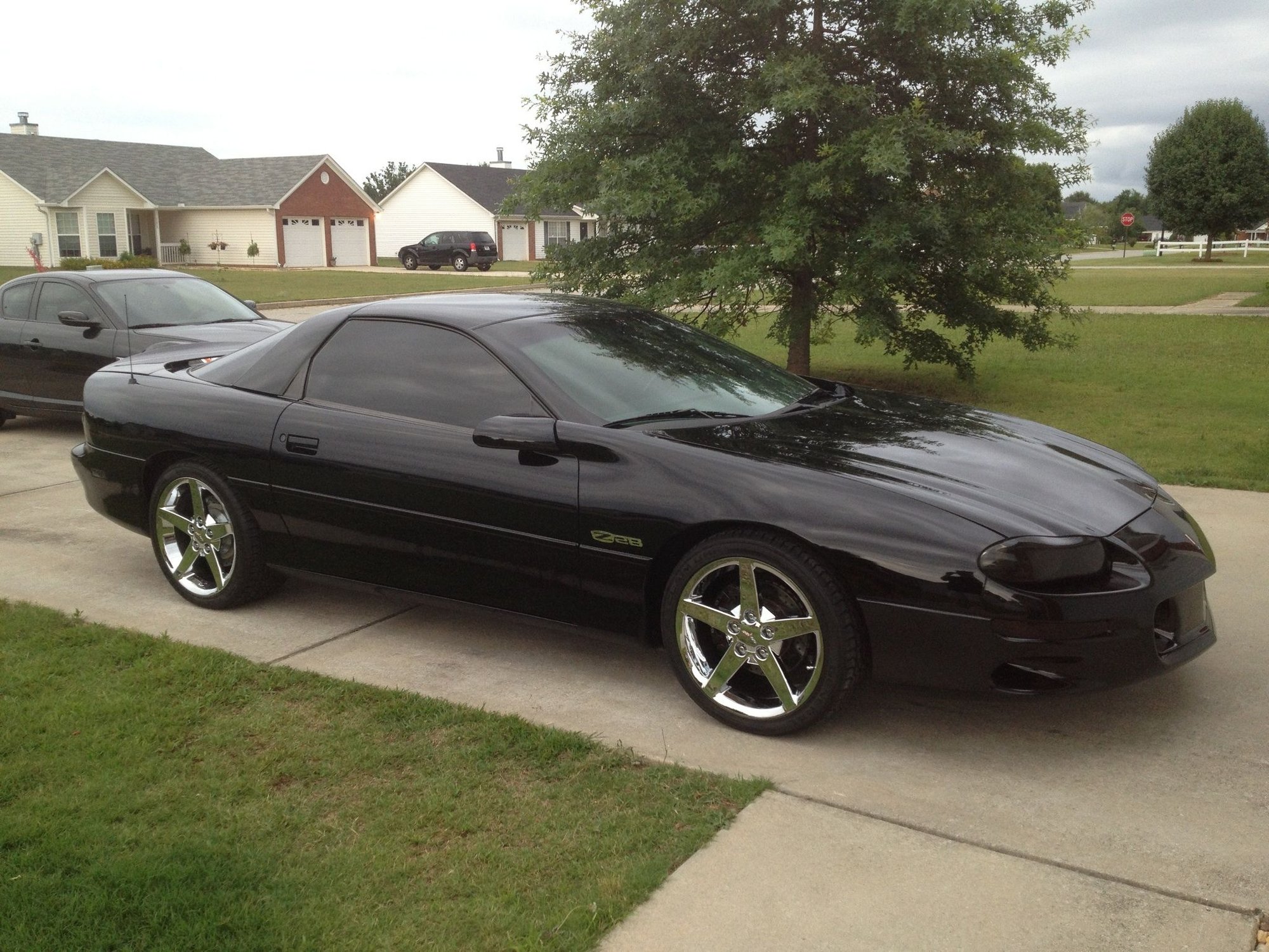

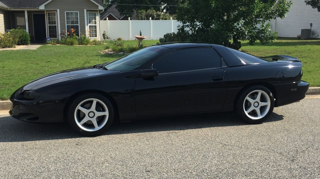

The Eibach Pro-Kit in the pic in my previous post on 275/39/19’s I believe lowers the car 1.25”...if you look closely, you’ll notice that the rear is slightly sagging which is also typical of the LS1 Eibach Pro-Kit. However, I’ve corrected that with Strano Springs & Koni 4/3 shocks as well as all the suspension mods to go along with lowering: Relocated LCA brackets and Adj. Panhard Rod. It’s with those additional mods and red light launches I’m referring to about the difference between the 275/40/17 tires and the 275/35/18.
This is how she sits now with Strano/Koni & 275/40/17 Nitto NT05’s on 17x9.5 OZ Monte Carlo rims.
...and this is how she sat on the same Strano/Koni set up, but with 275/35/18’s on C6 replicas...
