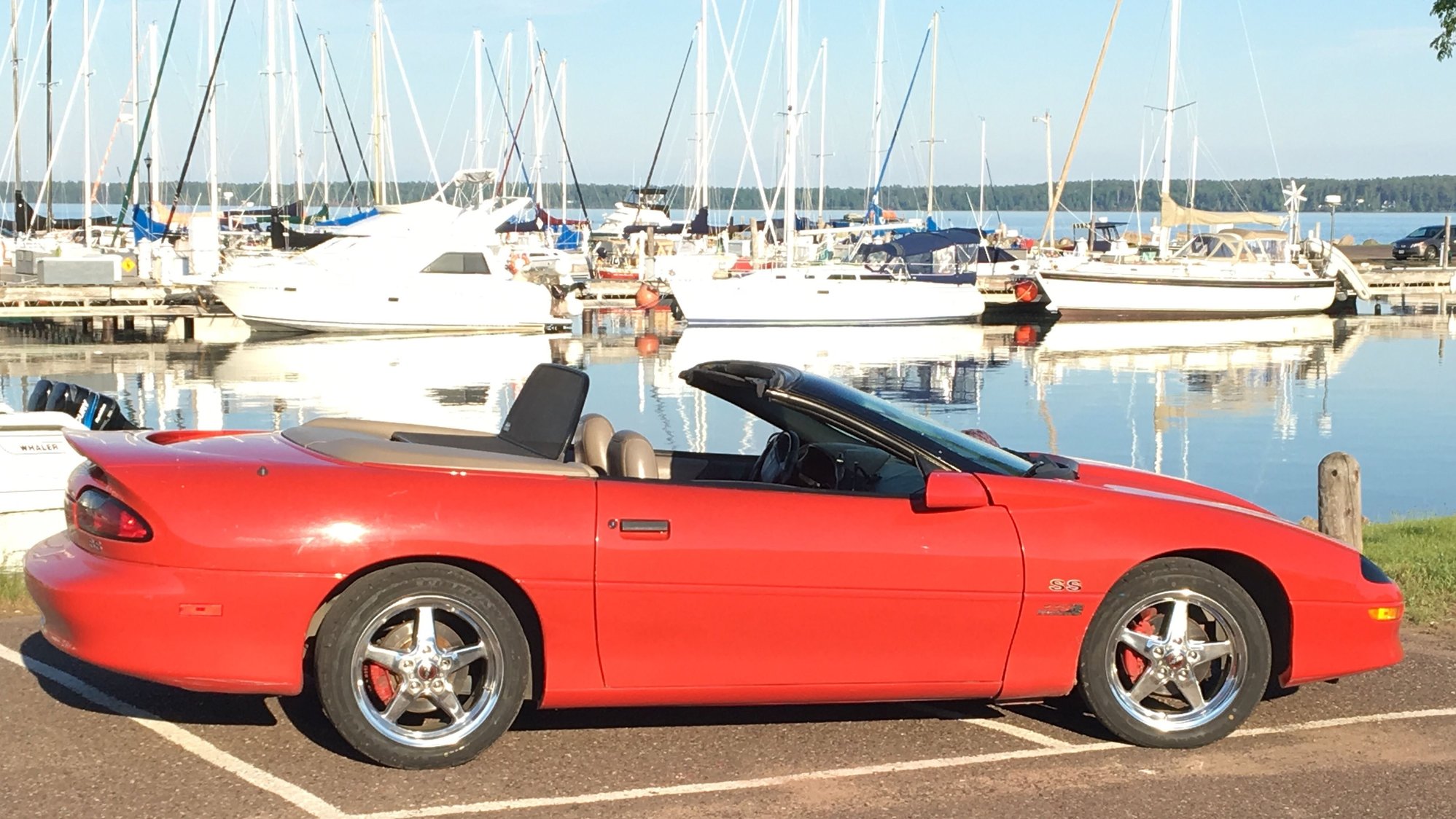

Don't know if this helps but these are RaceStar Drag Star 92 Polished on my 96 SS. They are 275/40 on 17x9.5 rears & 245/45 on 17x8 fronts with Firestone Firehawk Indy 500's all around. Everything bolted right up with absolutely no mods. I know its not the same setup as you're looking at but maybe it gives you an idea. Good luck
