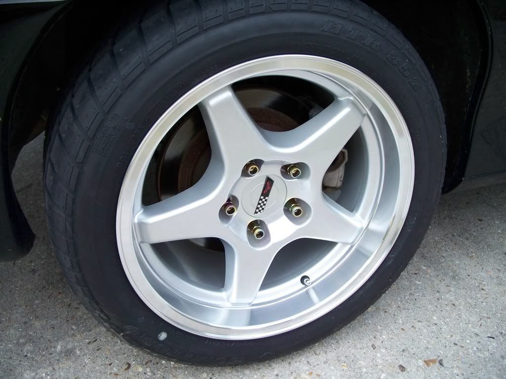

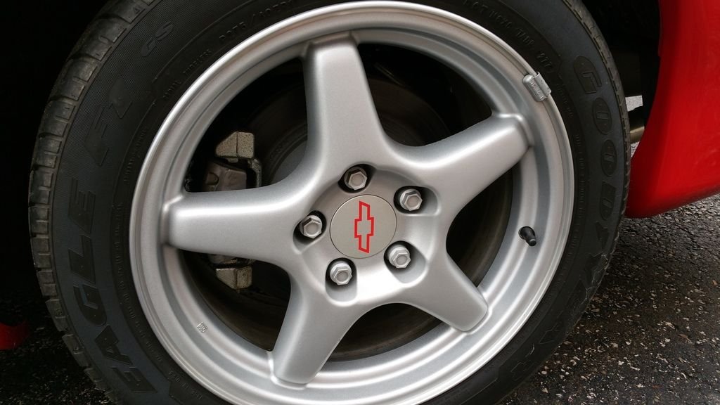

No problem, always glad to share these little details whenever I can.
The first picture is a factory 17x9", +50mm offset SS wheel. The second picture is a modern repro "deep dish" wheel, so the lip is obviously very different due to the dish but this picture was a good angle for spoke comparison to the other. If you look specifically at the edges of the spokes you can see the difference (modern repro being sharper/more square vs. factory original being more smooth/rounded). Older repros matched the factory smooth/rounded spokes, so your repros were most likely from an earlier era if they were a perfect spoke match to the originals.
Originally Posted by Chevyy1212
Perfect exactly the info I needed. I honestly couldn't tell much of a difference except for a few with what seemed to be sharper edges. There was enough squinting tho to not be too sure
Hopefully the pictures above are clear enough to give you a good idea of the difference. Regardless of the width, I think all the current repros use that newer, sharper spoke design. The difference is small and probably not noticeable to most folks at a glance, but can be seen by someone who is very familiar with these wheels. Having said that, it's likely going to be even less noticeable if you're doing deep dish in the rear as the deeper lip will draw some attention away from the slightly different spoke design - even more so in chrome as there is no concern about color match or variance in how much of the lip is polished, etc.
