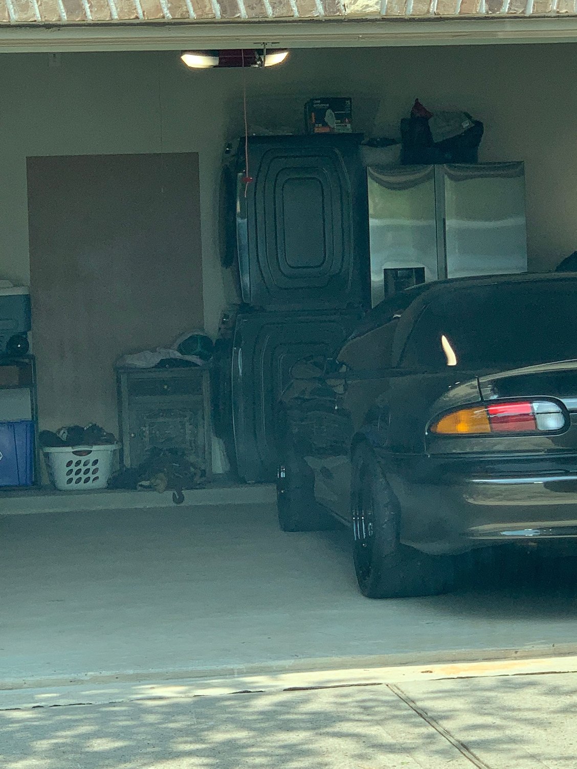

Probably 10.5" on the rear 9.5" fronts.
Currently I have 17x9.5 all around lowered on stranos and bilstiens
