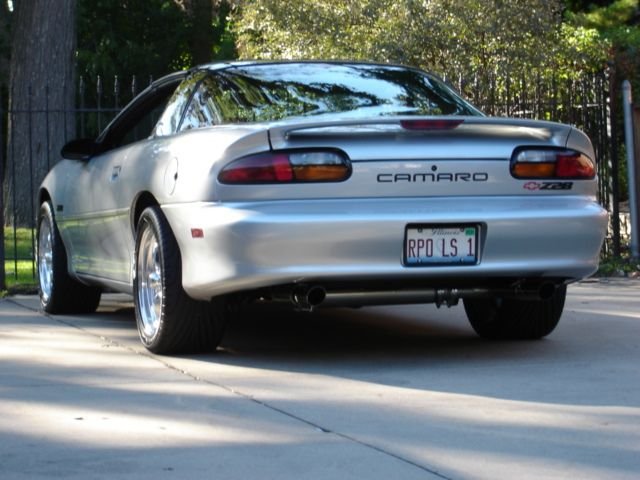

IMO, what looked best of all the setups I've had (in terms of rear fitment) was 9.5" wide, +46mm offset, 285mm wide tires. That put the tire flush with the top of the wheel opening in the rear, but this was for a Camaro (I think the Pontiac body is just a touch wider, so that might need to be taken into consideration). Here is a picture of mine with that setup (fronts are the same +46mm, 9.5" wide but with a 275mm tire - which looked good at certain an angles but honestly would have looked better at +50mm IMO):
