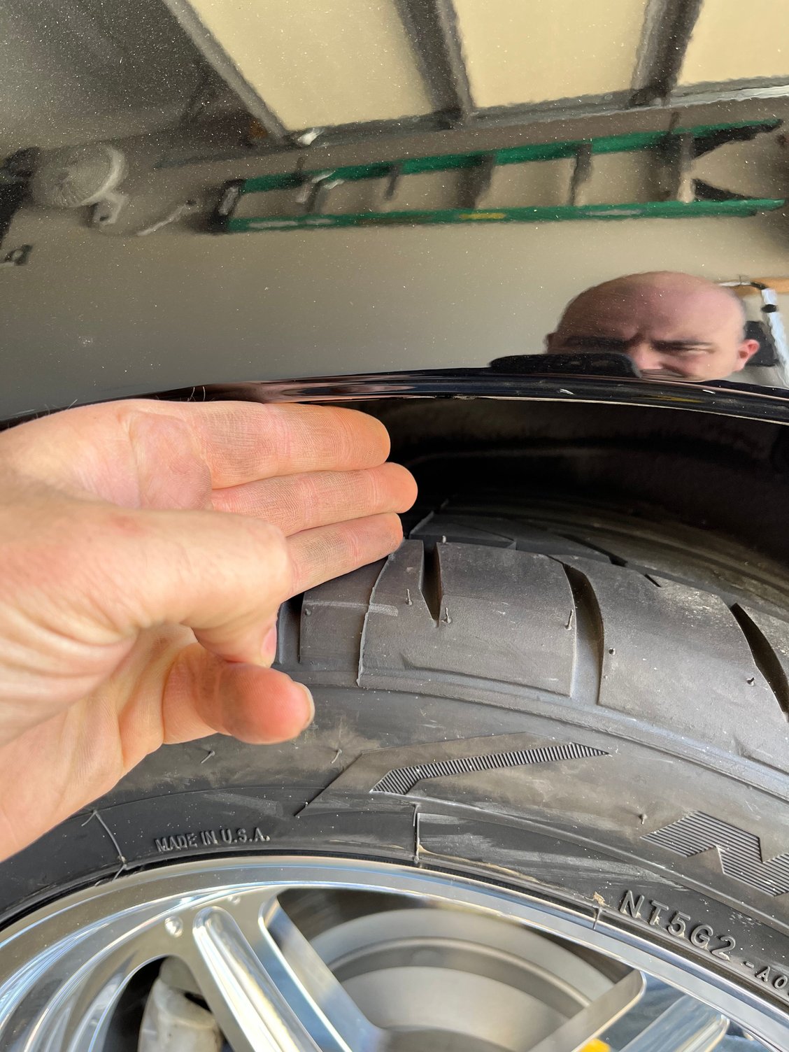

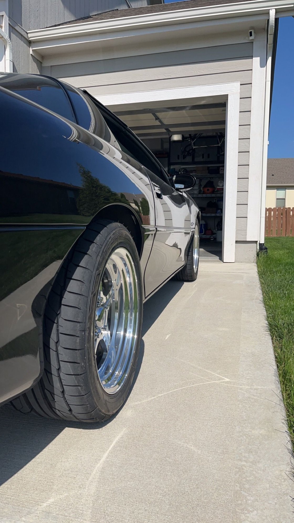

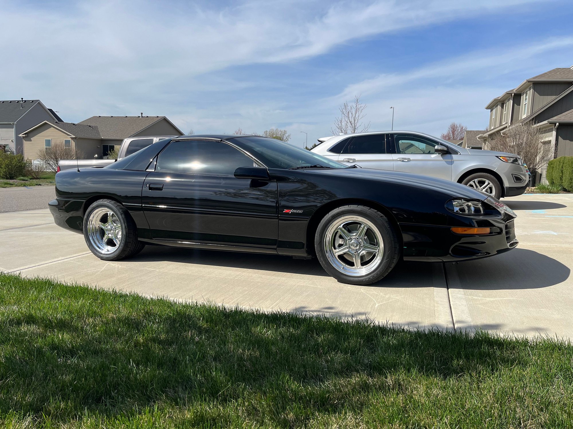

Old Oct 30, 2023 | 08:03 AM
99Silver6.0's Avatar
Joined: May 2002
Posts: 4,440
Likes: 93
From: Spring Hill, KS
17x9.5 and 17x11 (7.75 BS in rear) Street Lites. I hammered/rolled nothing.
