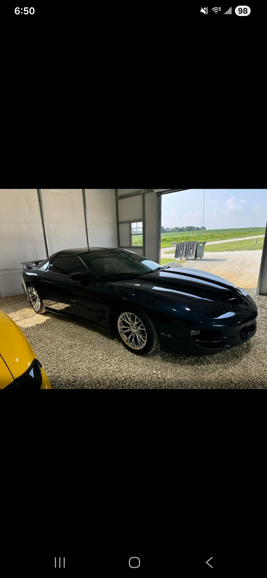

I'm looking at getting rims for my 02 Firehawk. So I'm looking at the the chrome C7 Z06 rims in 17x9.5. However, i cannot find pics of those rims on a 98-02 car. Is anyone running those rims that has pics they can post? Thanks in advance.

They do exist. Lol. Do you have a pic from the full side?

No it ac5ually just randomly popped up on a Facebook post and I was like oh im gonna send that on here... it's a horrible picture but that is the only one he had on his page.
they look like something off a lexus sedan when they are smaller than 18

No photo description available.
Old Nov 28, 2025 | 06:01 AM
Ls7colorado's Avatar
Joined: Jul 2005
Posts: 2,119
Likes: 610
From: Henderson, TN
Joined: Jul 2005
Posts: 2,119
Likes: 610
From: Henderson, TN
17s on front
Old Nov 28, 2025 | 06:02 AM
Joined: Jul 2005
Posts: 2,119
Likes: 610
From: Henderson, TN
17s on front 18s on rear
