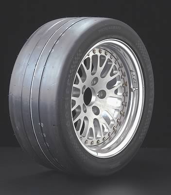

The hoosiers aren't very rain friendly, well the MTs aren't really either, but the MT's would definitely do better if you were caught in the rain.
The hoosiers are lighter though (by about 7 or 8 lbs per tire), and a softer compound with a lil more sidewall flex. The MTs are heavier, stiffer sidewall, more street/rain friendly pattern to them and hook great too. They both come in 315s, hoosiers running a little wider than the MT, and the hoosiers do come in a 335, but you'd have a fun time trying to get them to fit, they're pretty freakin wide.
Hoosier:
New style MTs:
