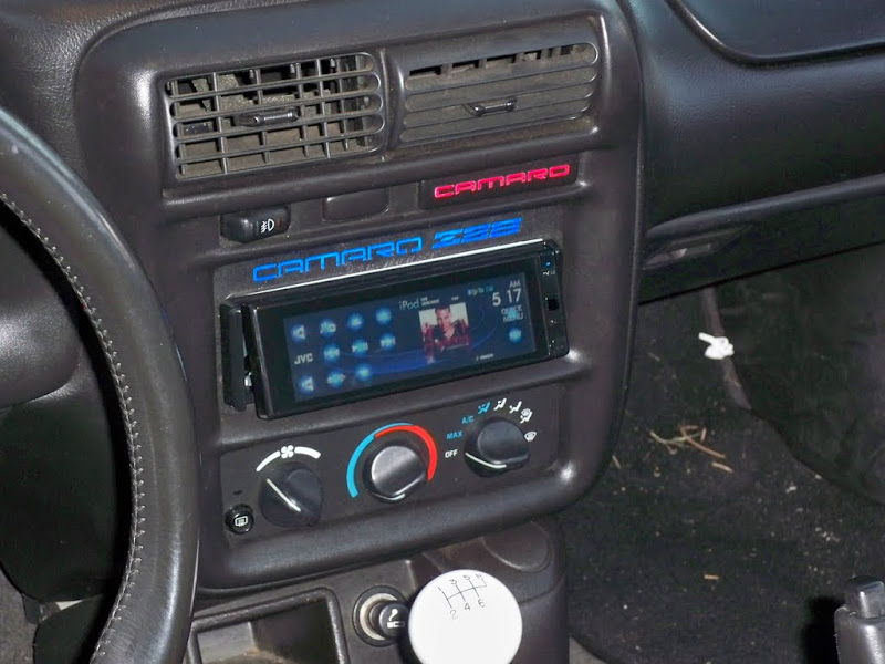

That's what it looks like if ppl don't know their part number. Lol.
I had to modify it to fit but i like it

On the HUmounts, how are the LEDs wired and illuiminated? Are they switched or on all the time?

t depends on how You wire them in. I wired mine to the orange wire I think, the illumination wire.

You can wire them to the orange or brown (can't remember exactly) for Power and then to the black for ground. If you wire it up you can have it dimmable with the interior lights and will only be switch on when the lights are on. Very easy to install and looks awesome.

It is a standard 12v light, i have mine wired to the stereo ignition power lead with a toggle switch, so it comes on with the stereo and i can turn it off at will.
