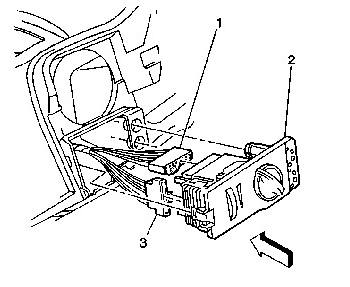

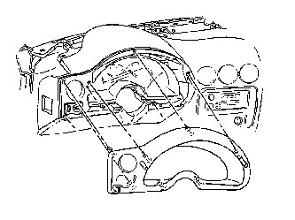

No, you don't even need a 7mm socket. Removing the headlight switch (including the dimmer dial) is just two steps...
Pull off the instrument cluster bezel:
Snap the headlight switch out of the dash:
1 = headlight switch connector
2 = headlight/dimmer switch assembly
3 = dimmer switch connector
