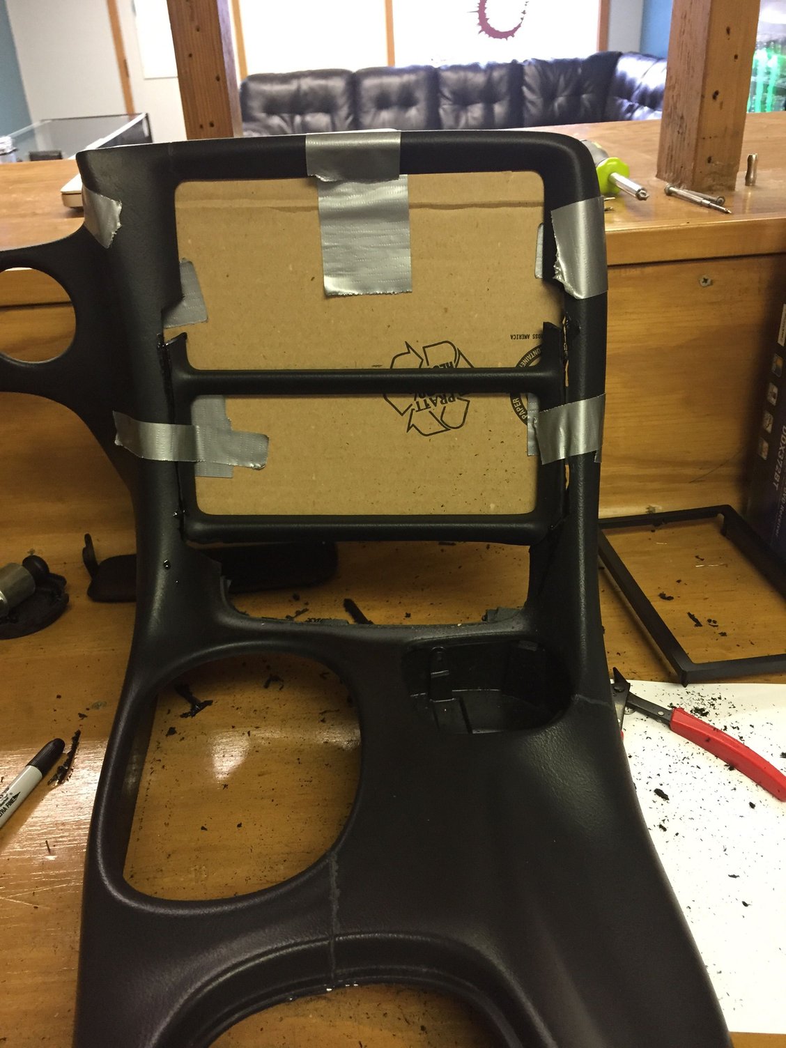

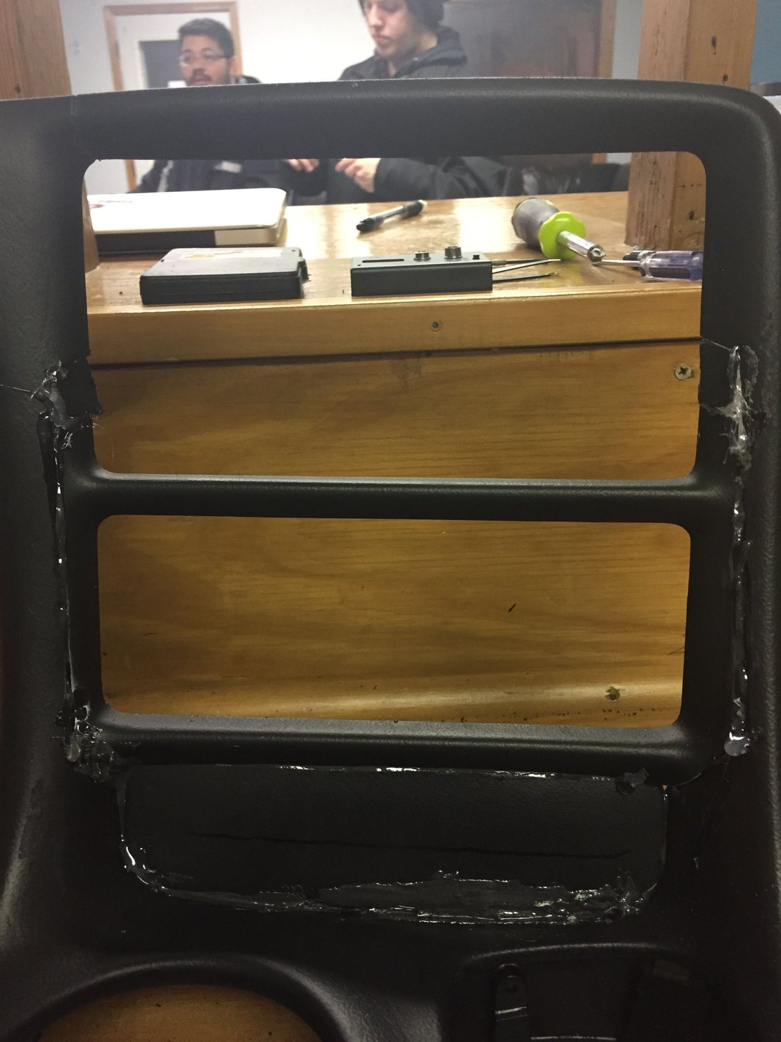

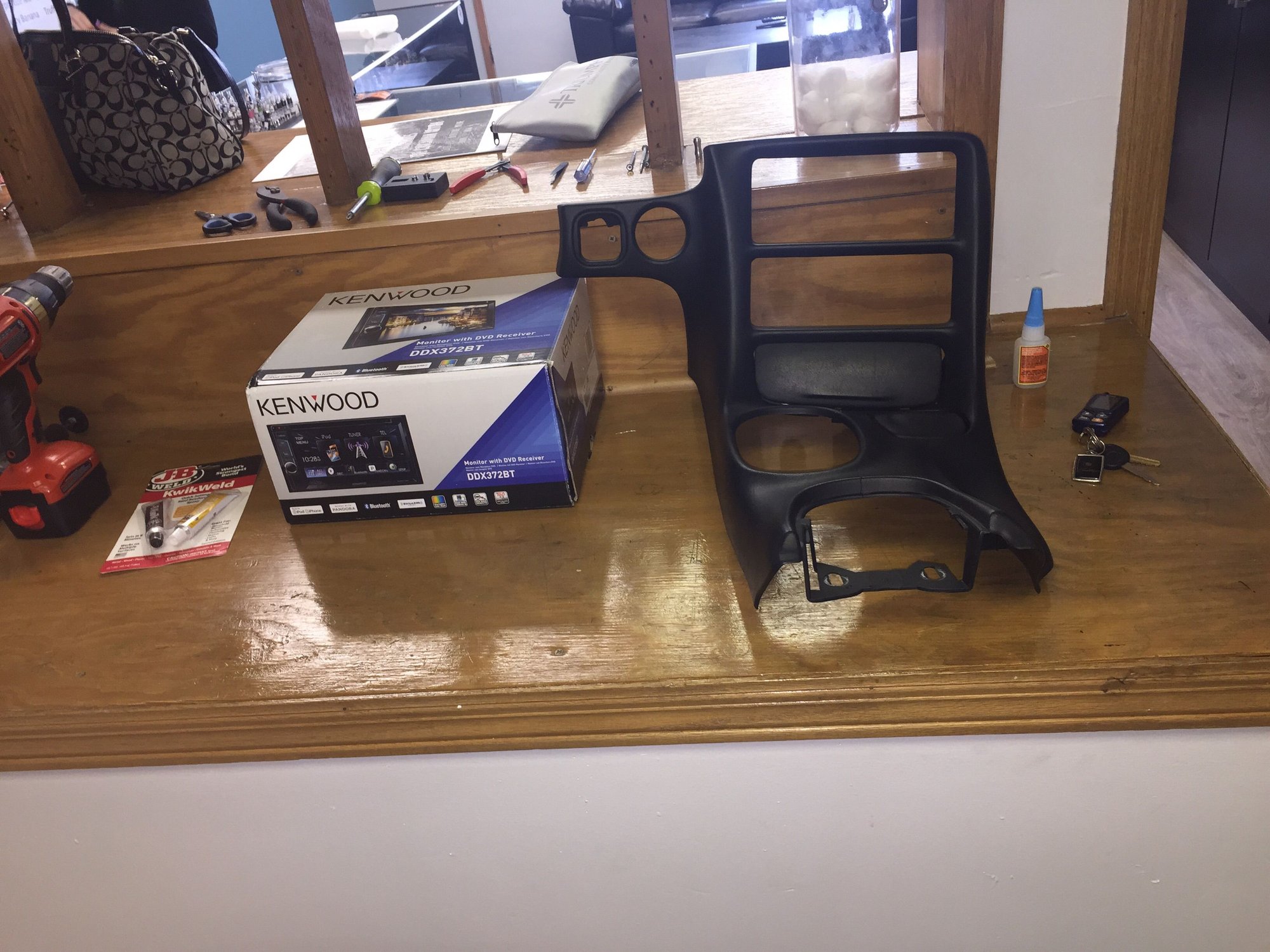

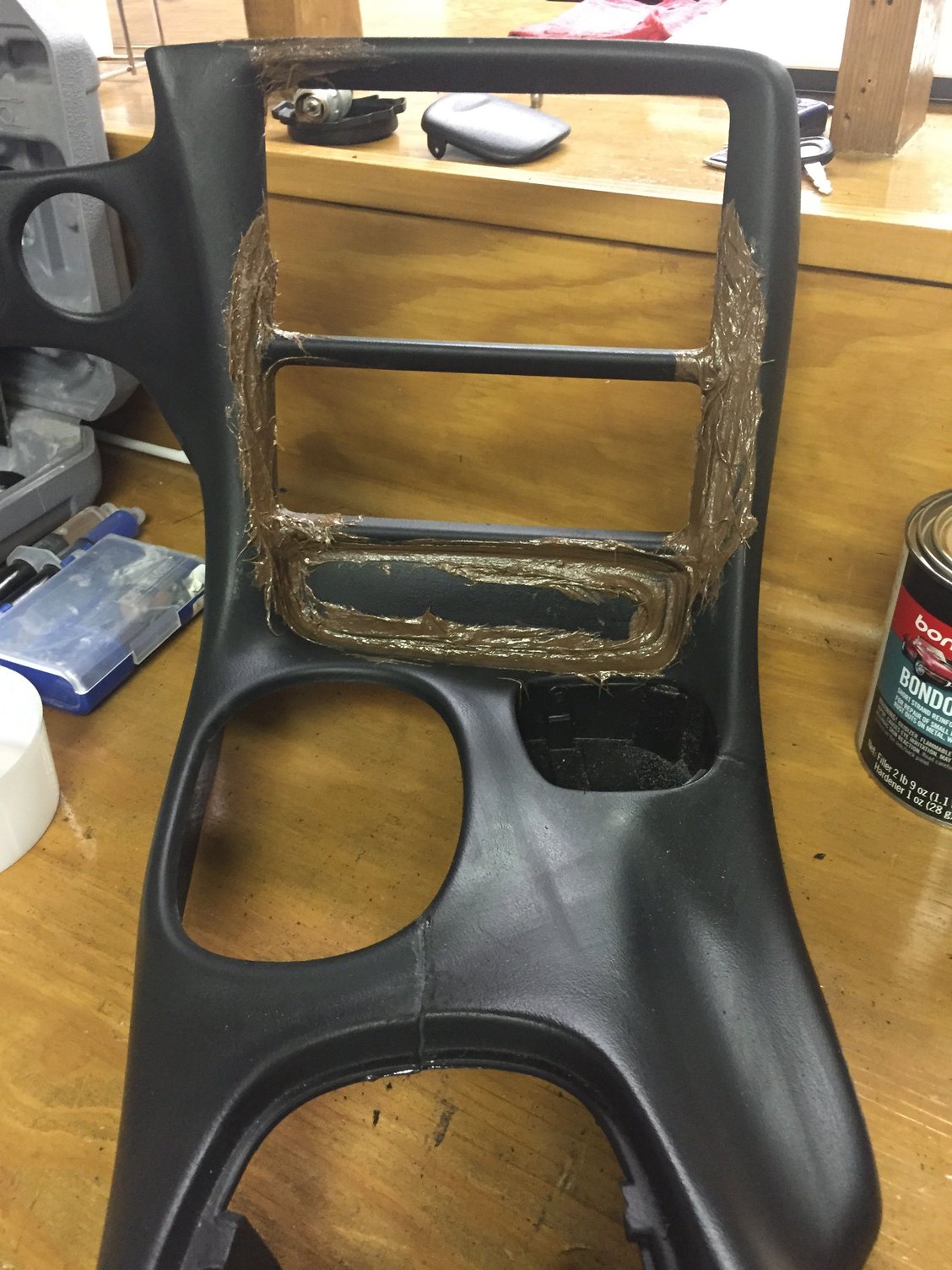

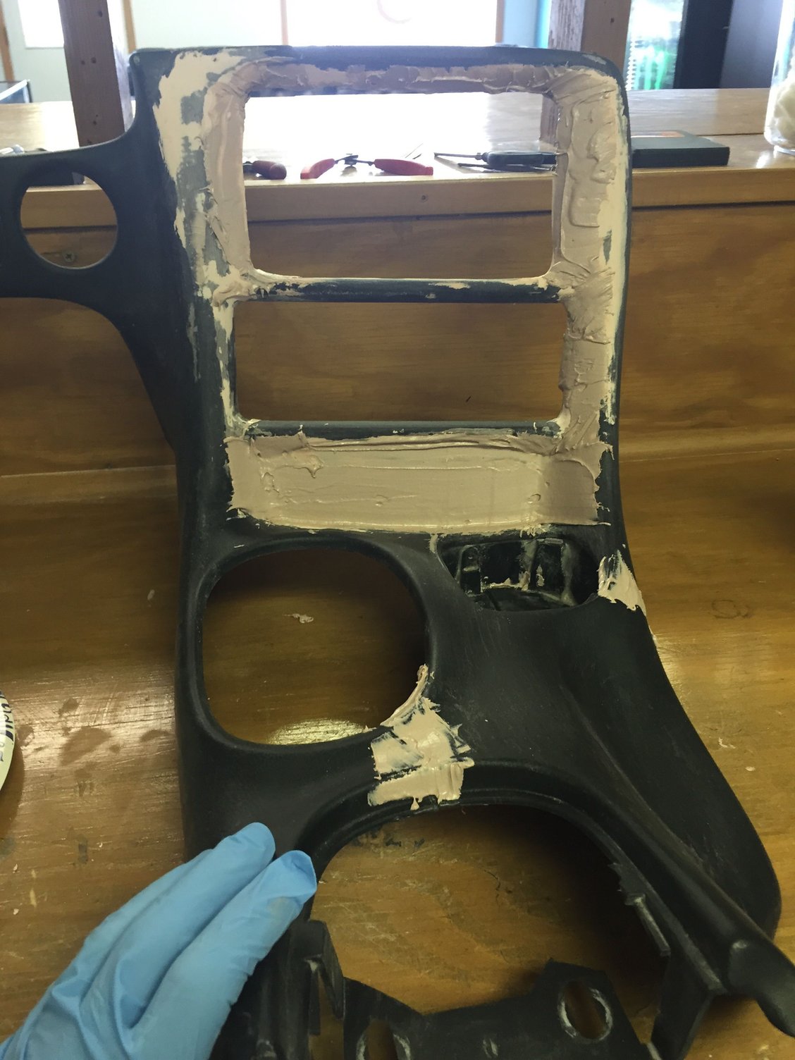

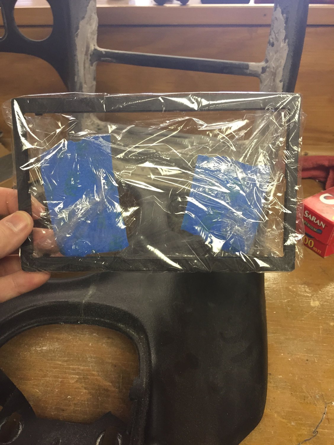

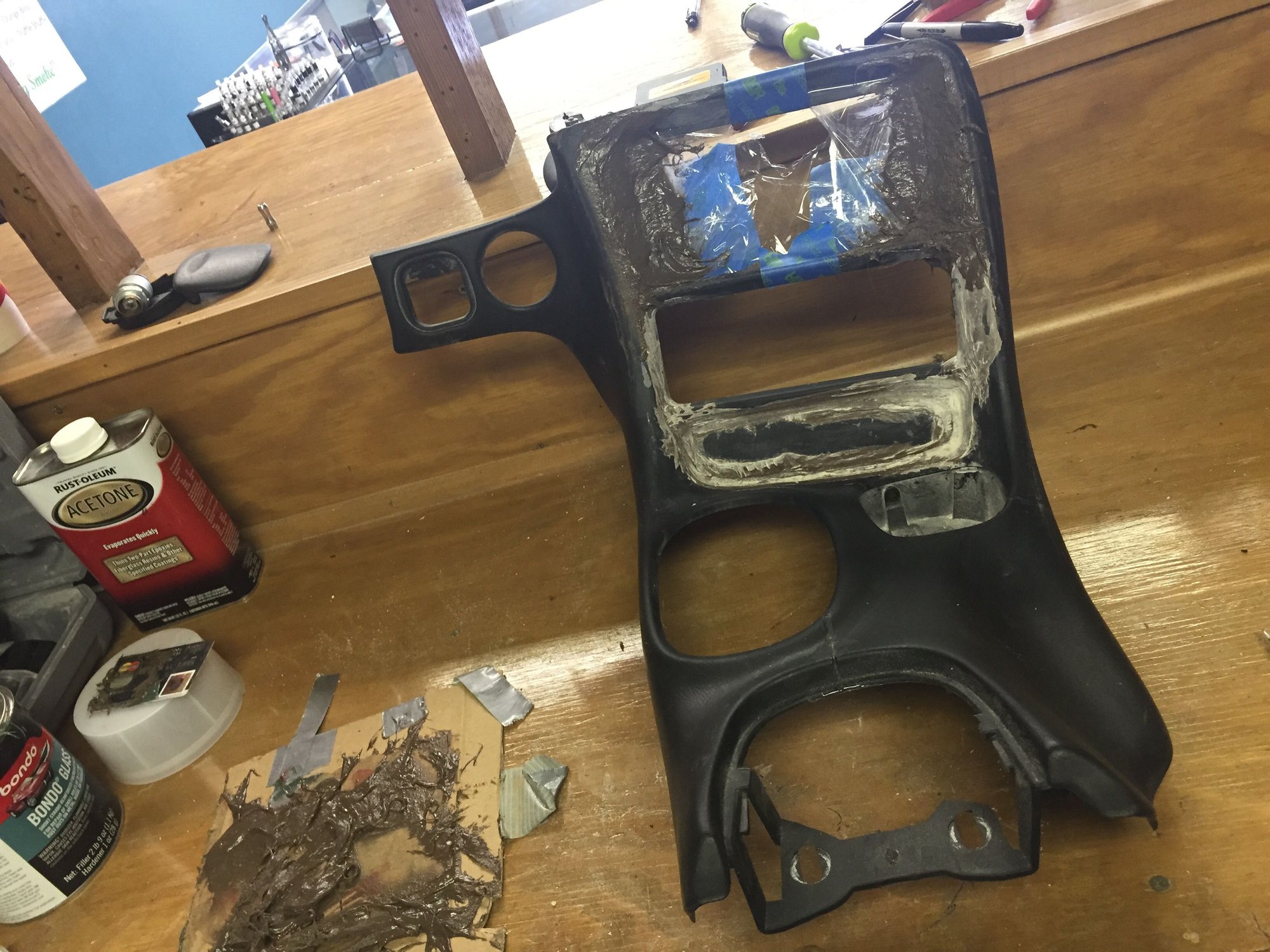

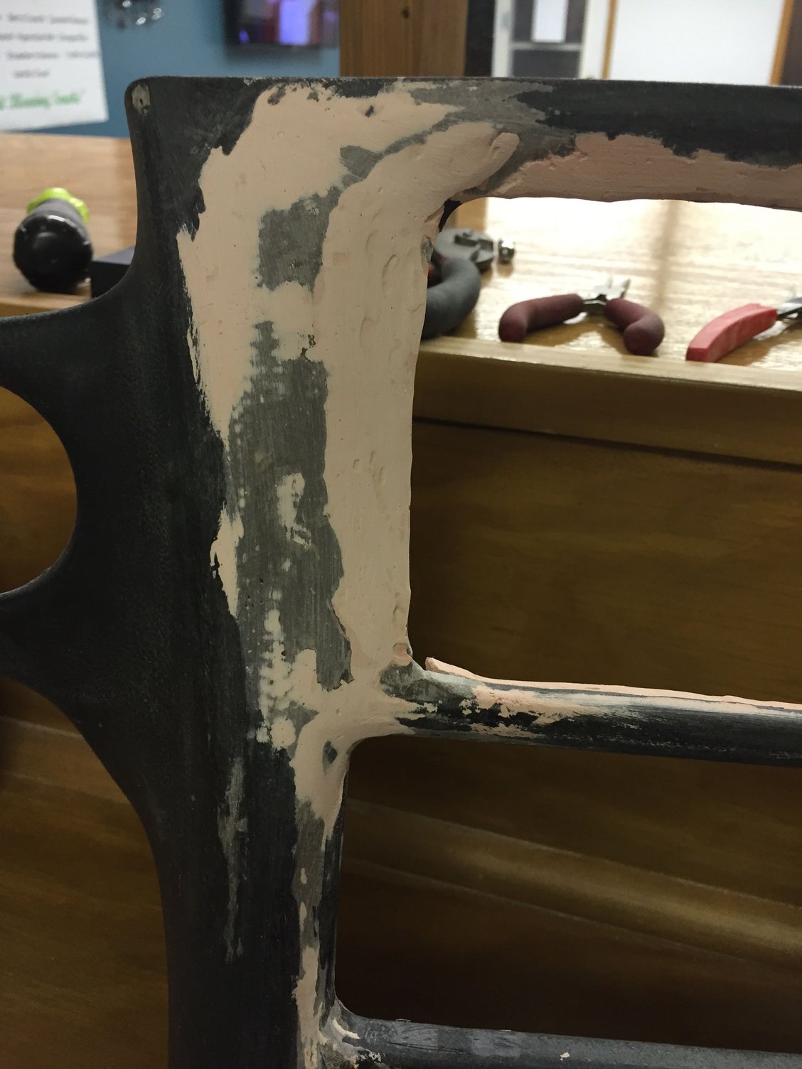

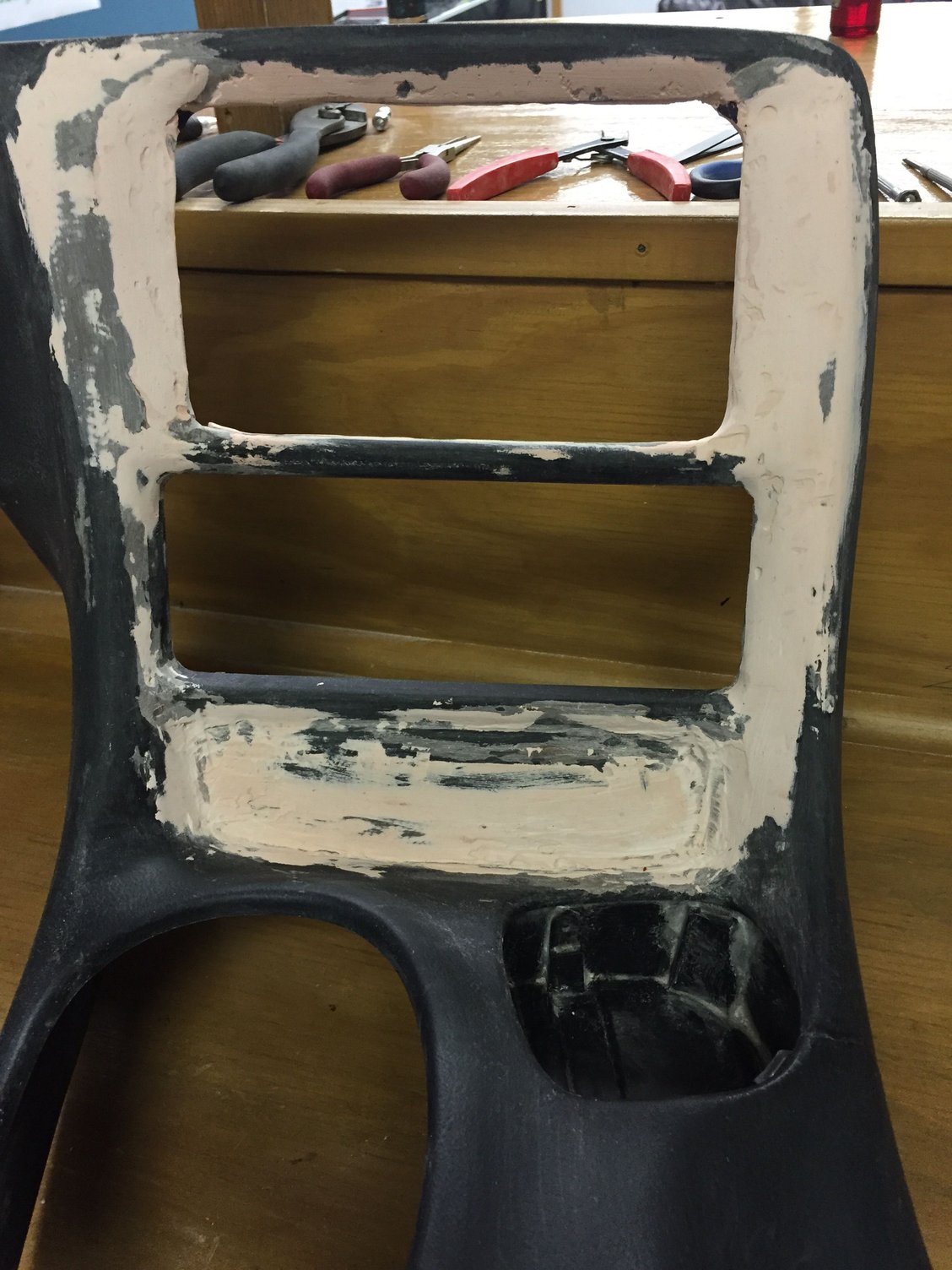

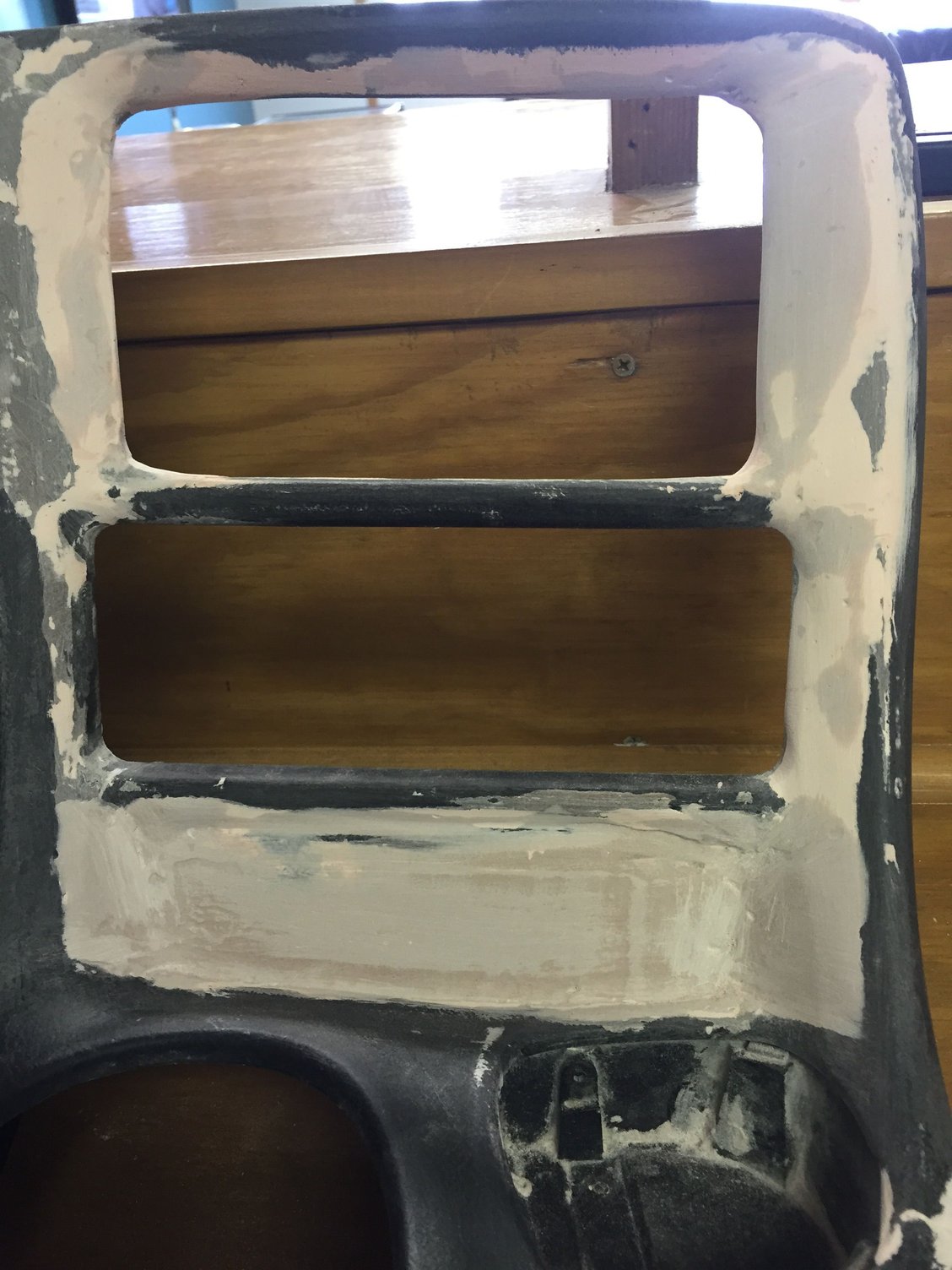

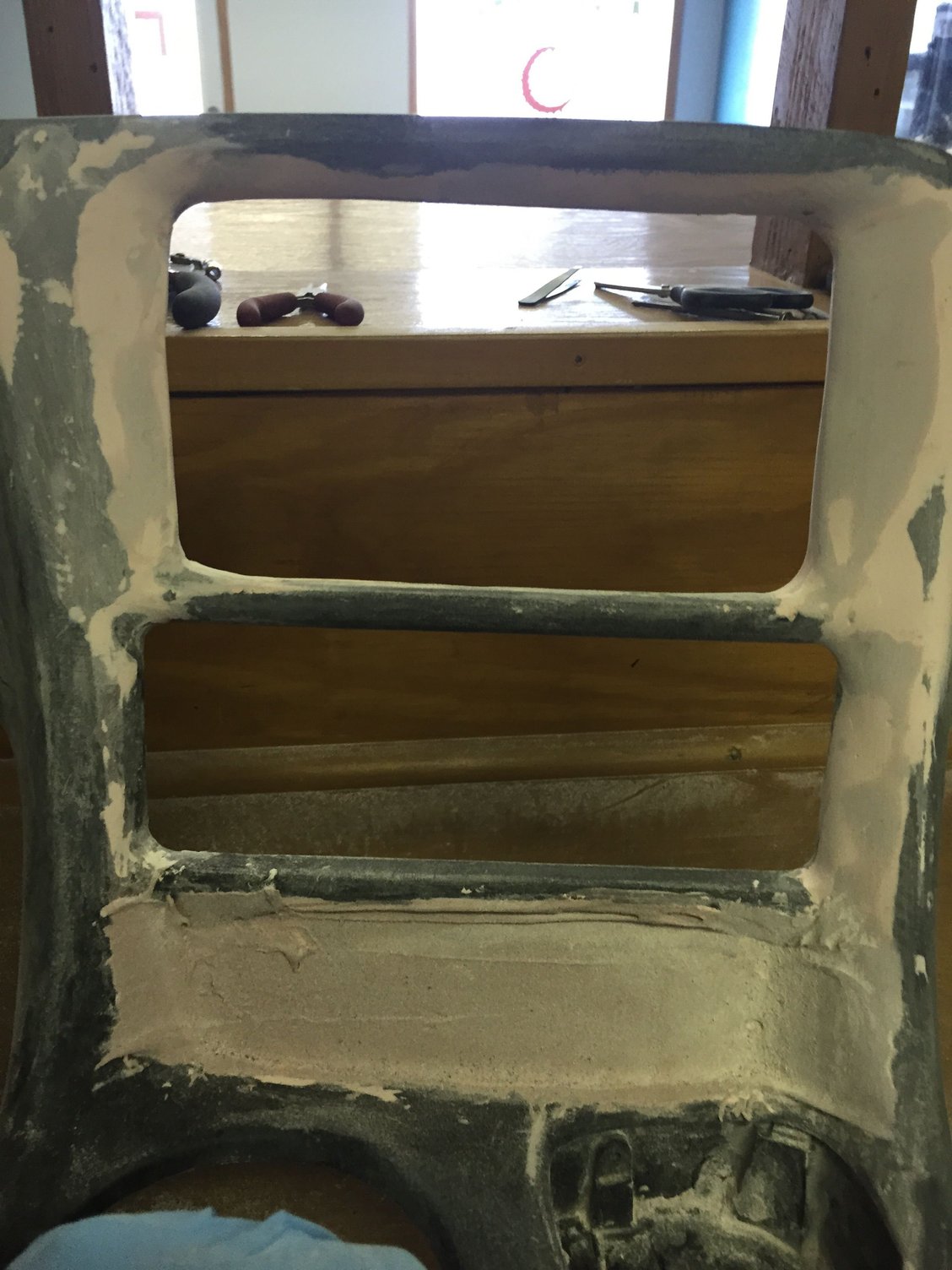

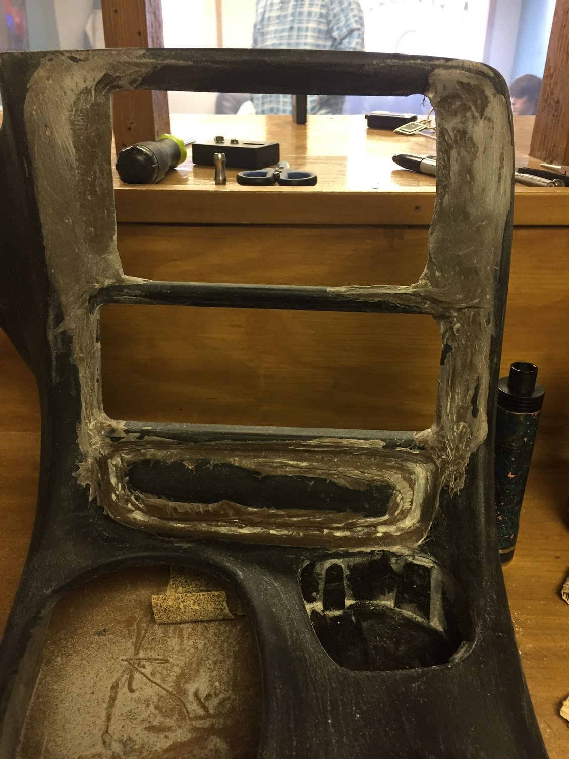

Figured Id give myself a project to bring the c5 into 2015.
Bout to dive in

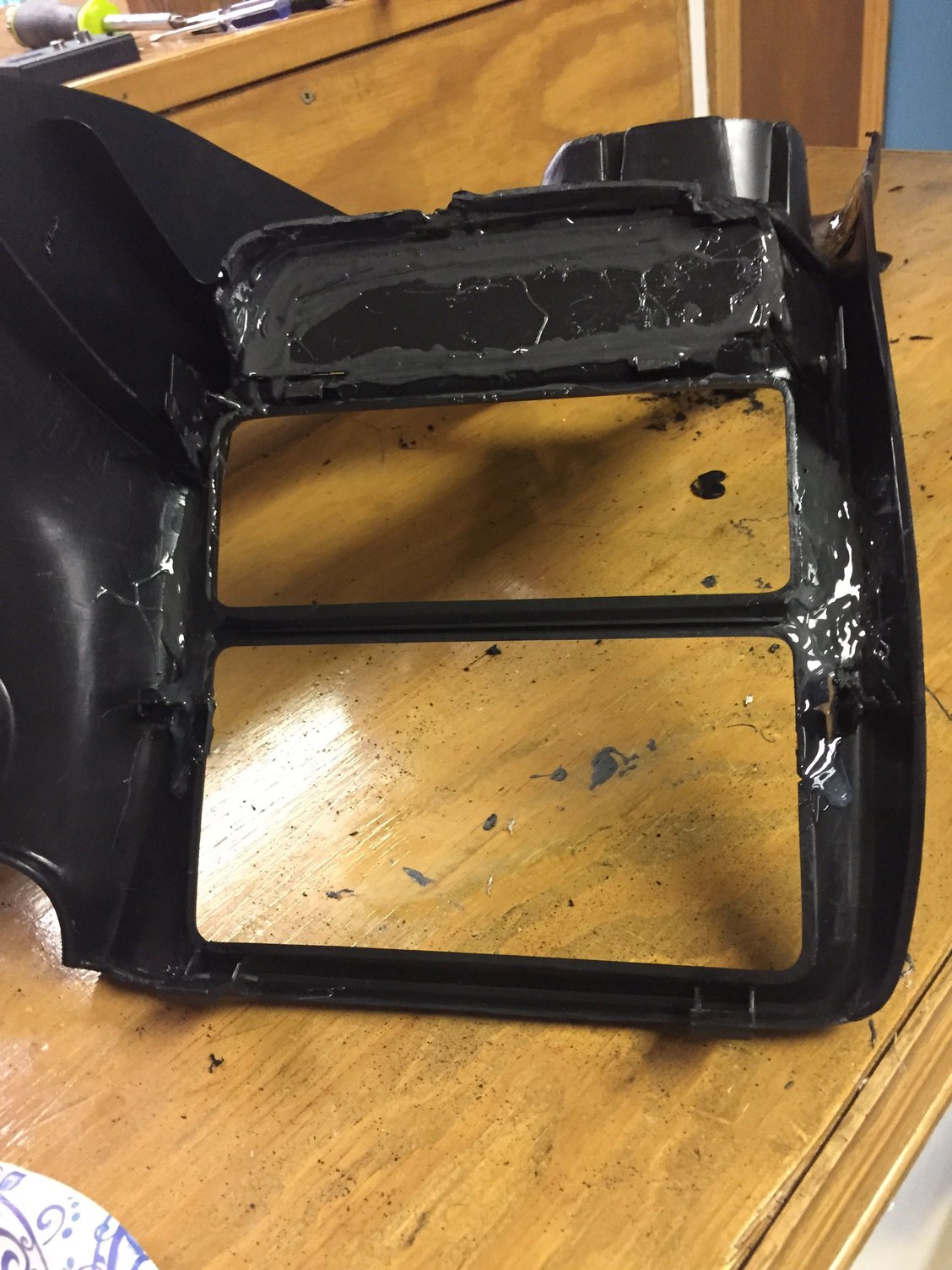

Ash tray cut out.
Cut the hvac bezel out.
Sliding down the hvac controls to make room for the double din
Everything glued into place

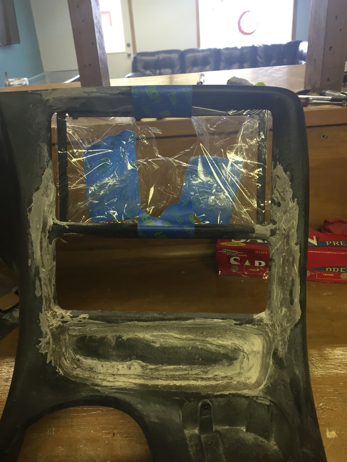

Old Jan 28, 2015 | 03:12 PM
bstrang6's Avatar
Joined: Feb 2012
Posts: 56

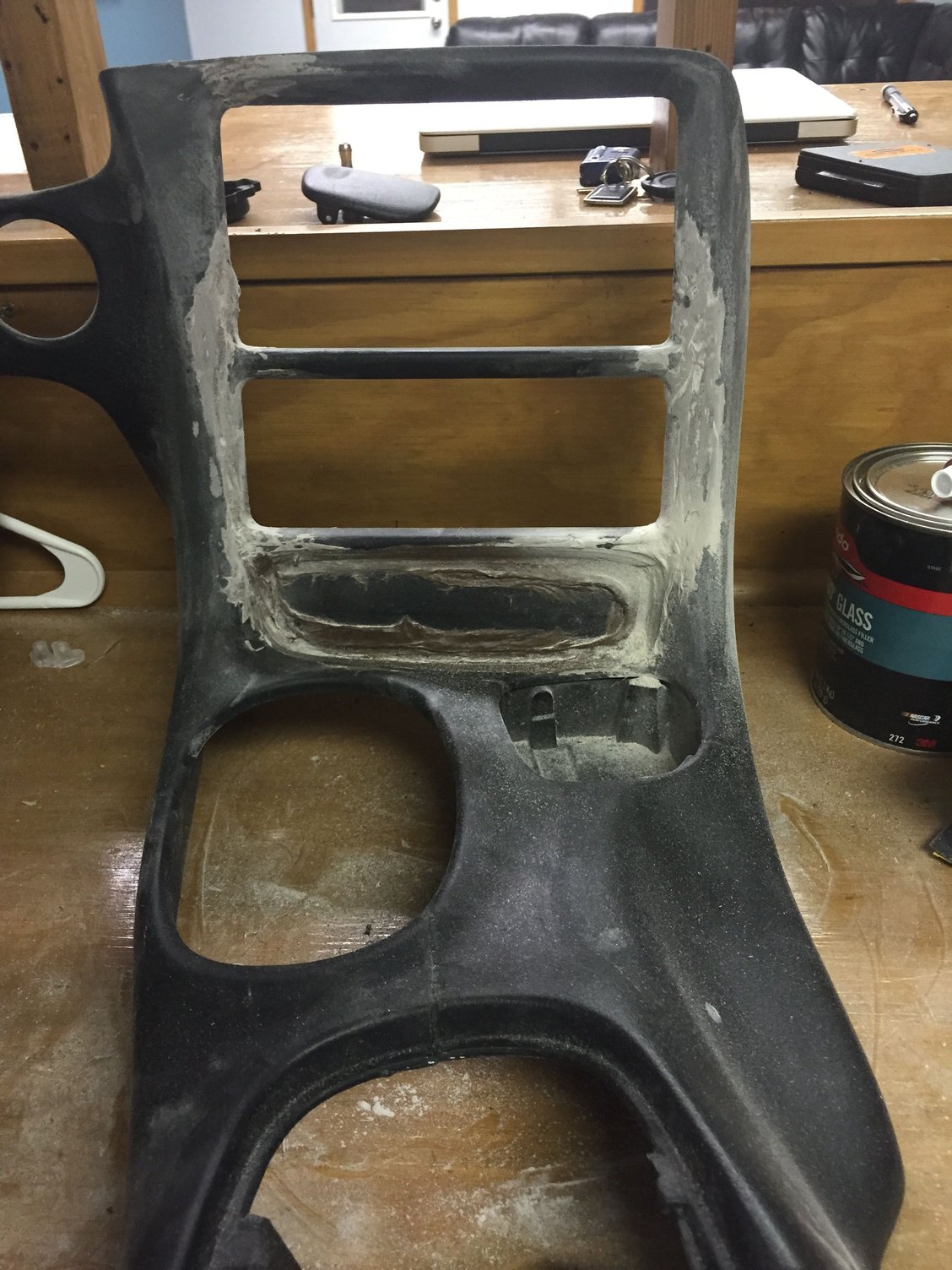

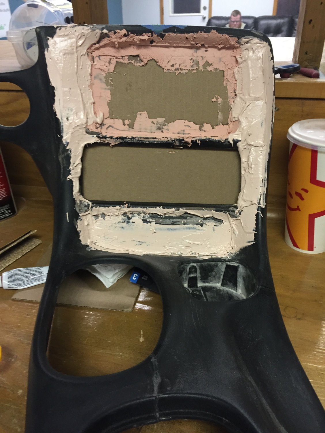

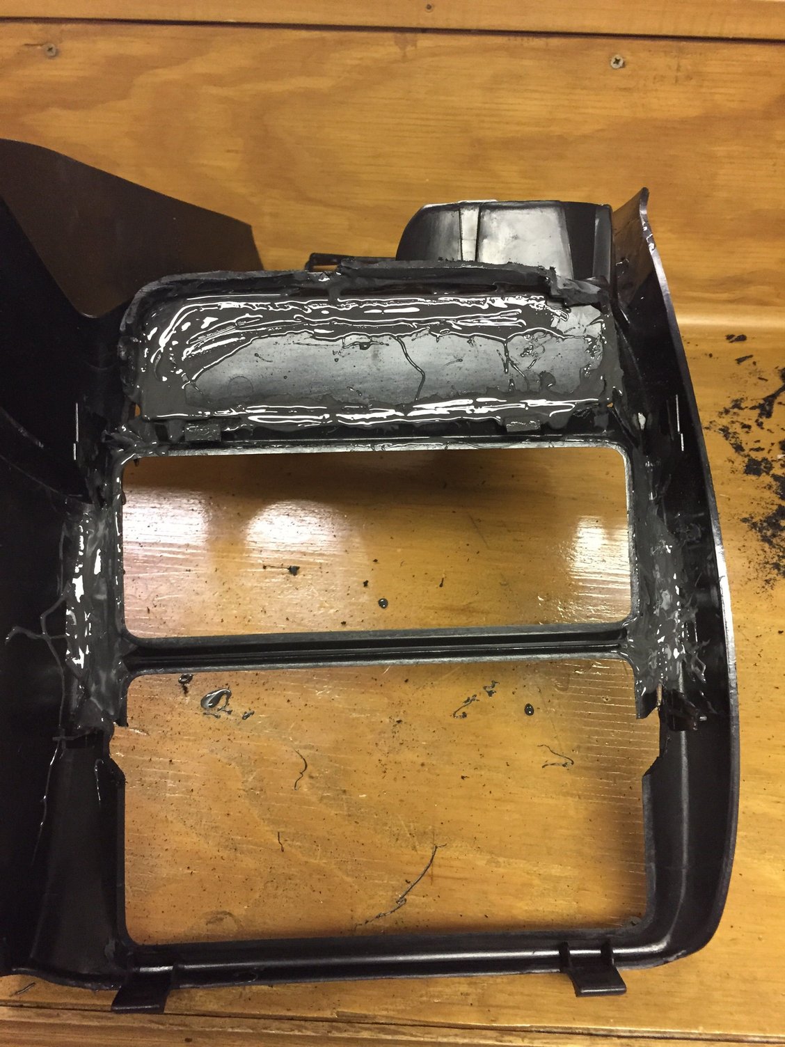

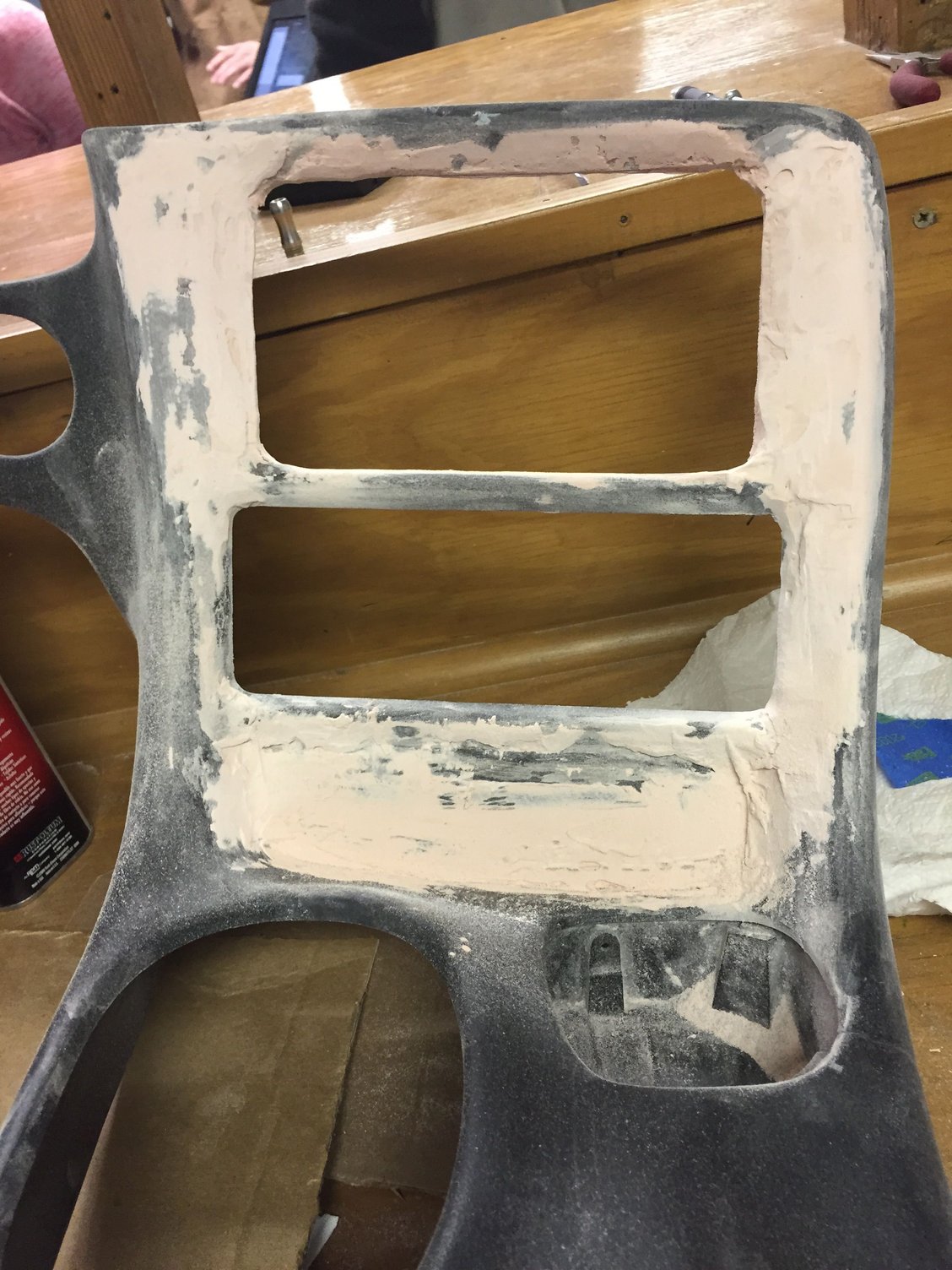

Probably have two more coats of plastic to go, and then final sanding. Have some SEM texturizer coming, I'm by no means a pro at fiberglassing and bondo, but I think it's coming along nicely...

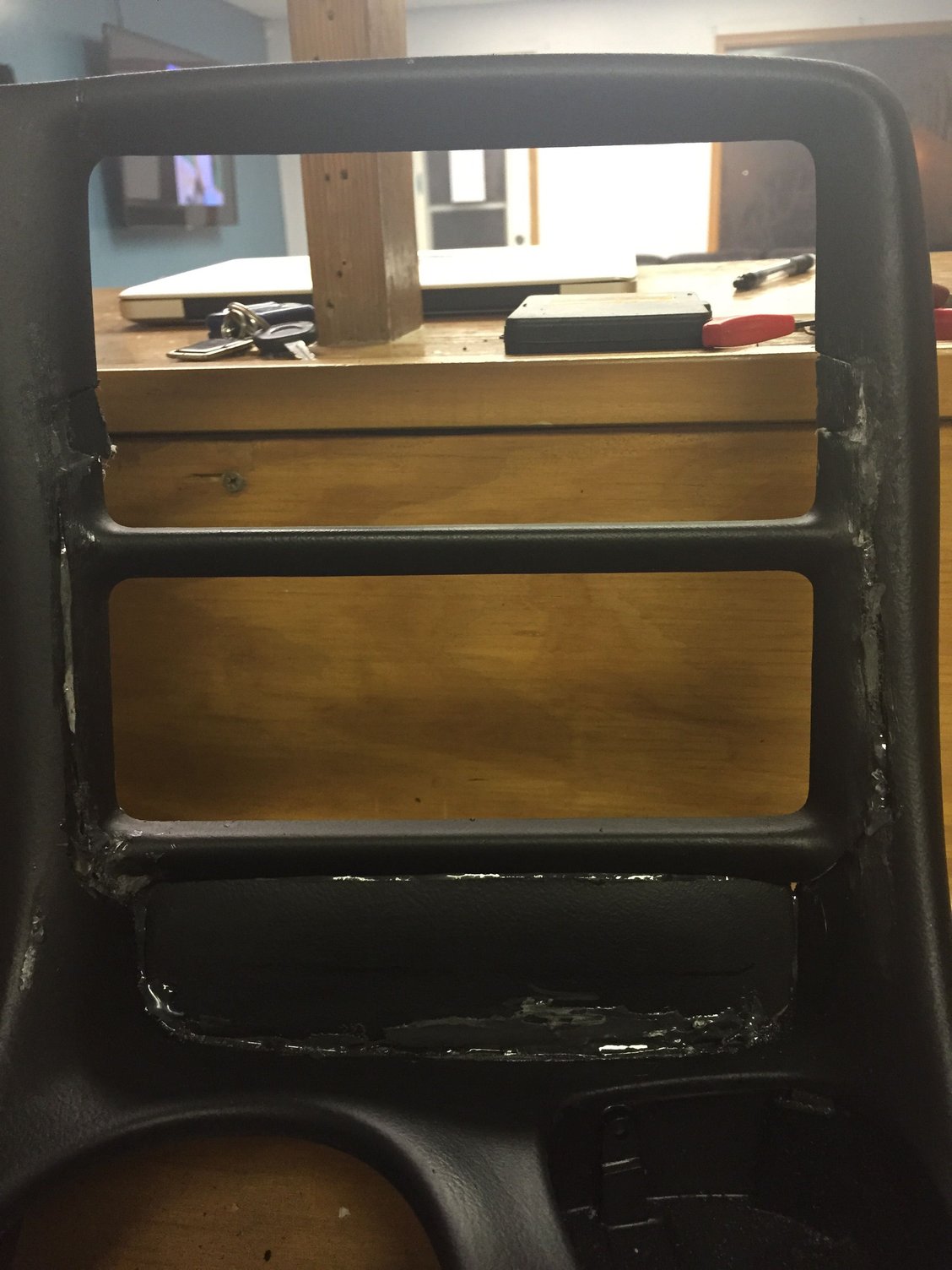

Hope it won't as long as it's not pushed on again, I fiber glassed it and the put a lot of jb weld on the bottom side, may see if I can figure out a spanning support for it. My other bezel isn't craxked there, just along the top most section above the radio

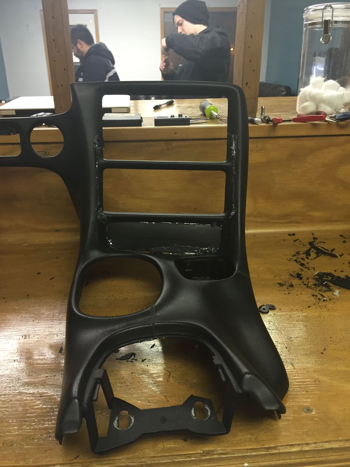

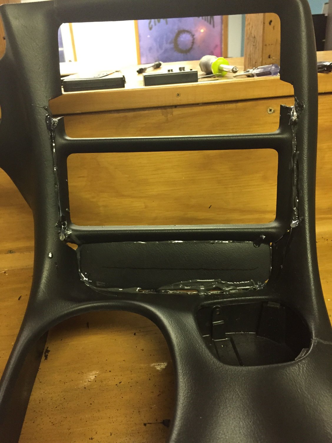

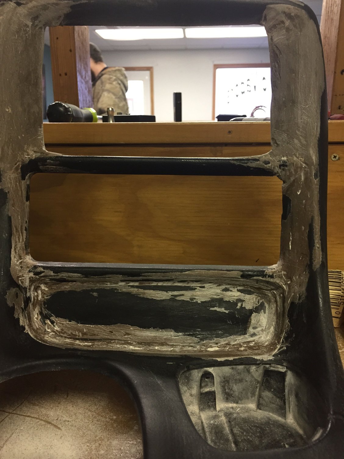

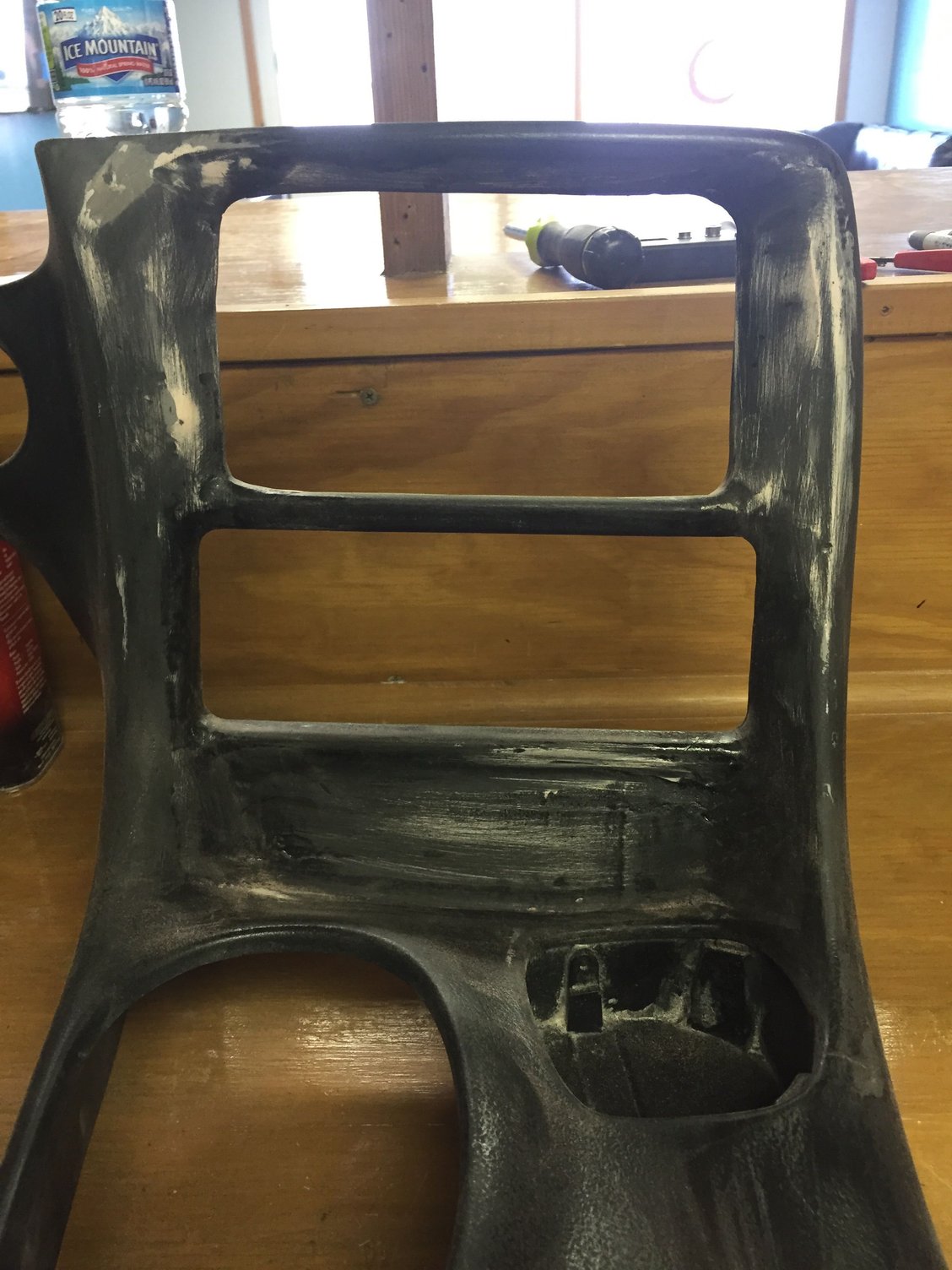

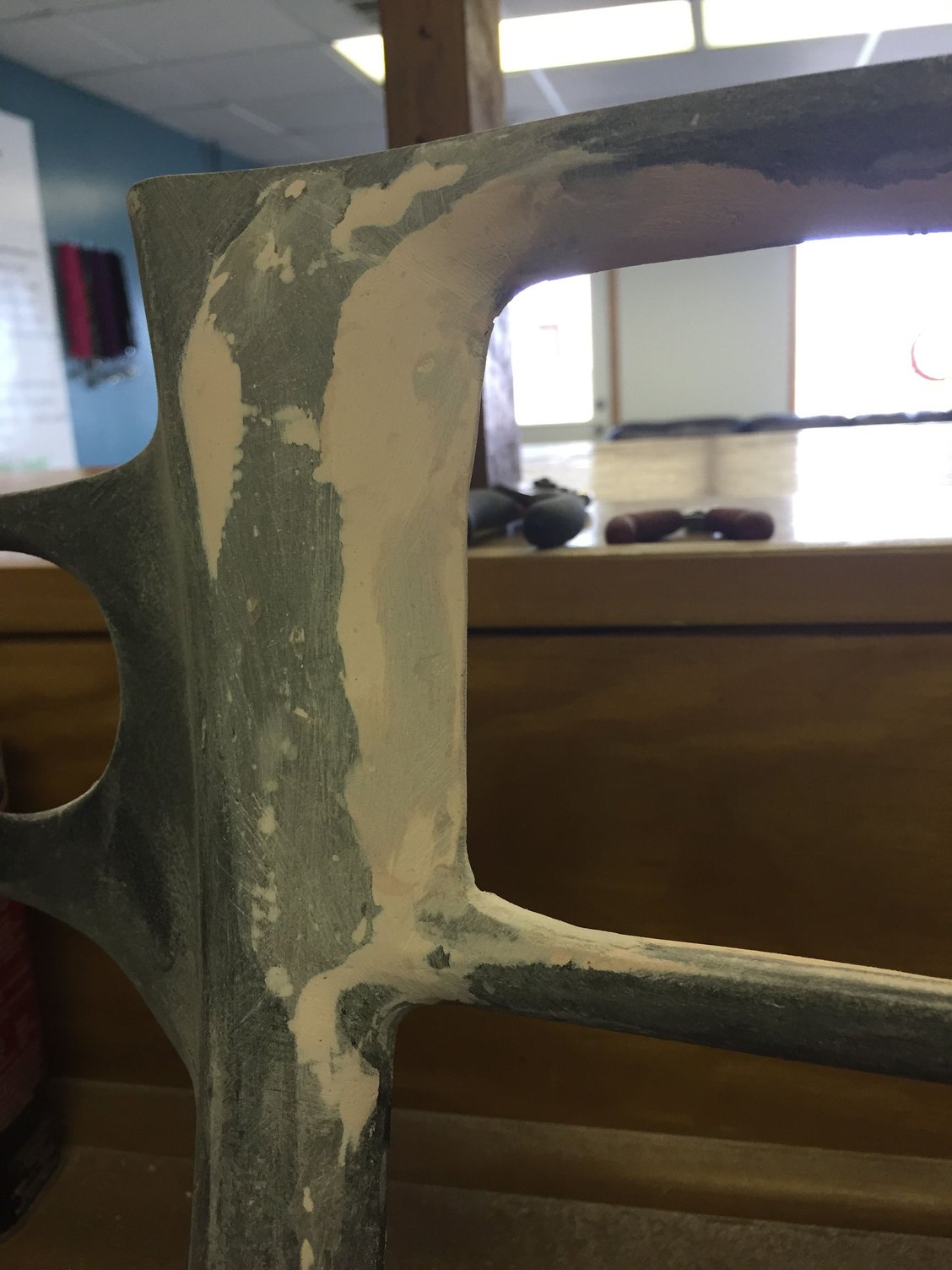

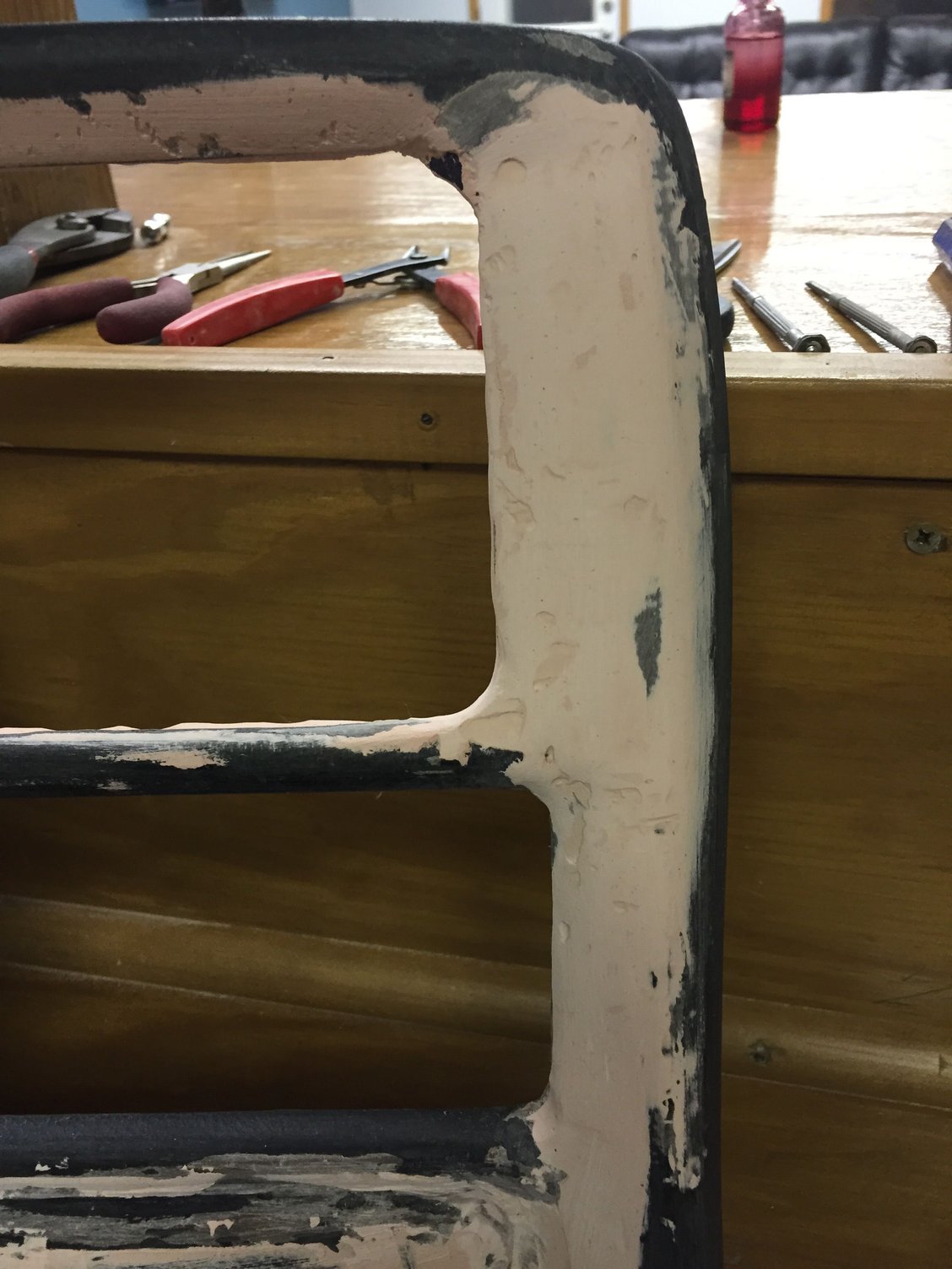

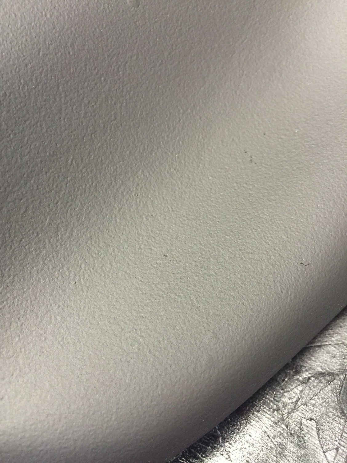

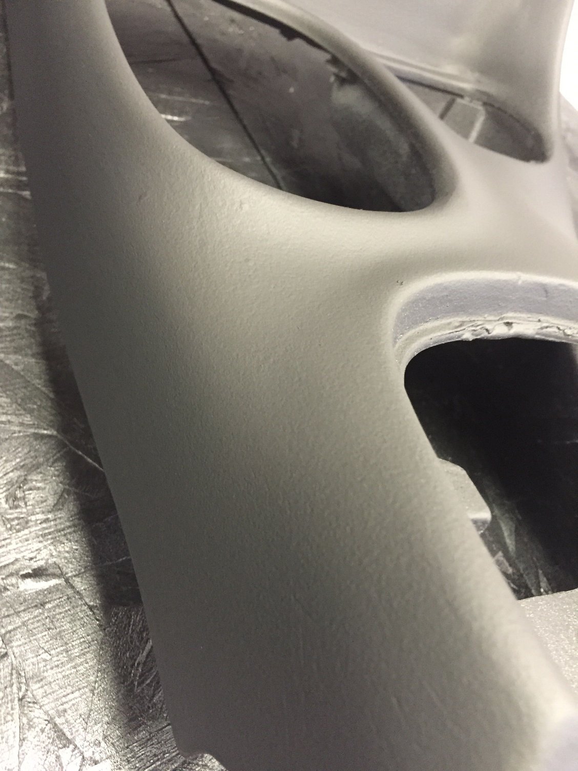

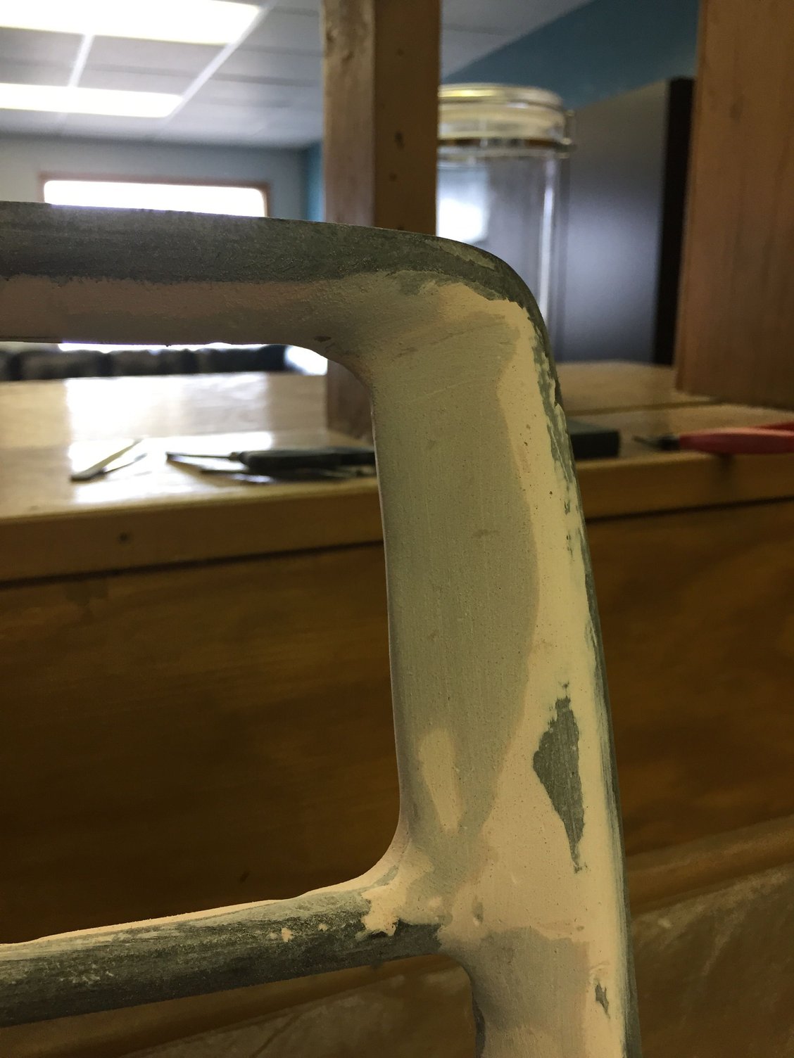

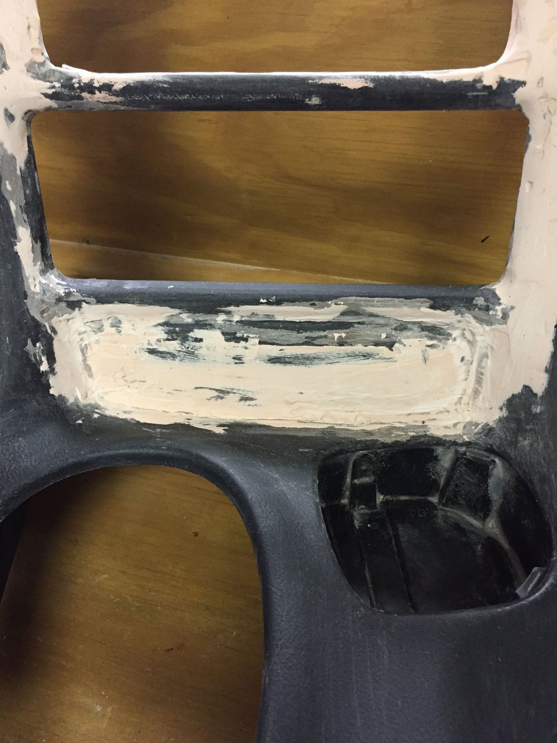

Still not done with sanding the ashtray and radio hole, but my SEM paint came in and I wanted to test its ability to cover small inprefedtions and sanding marks, this product is awesome!
Close up of the finish
Another

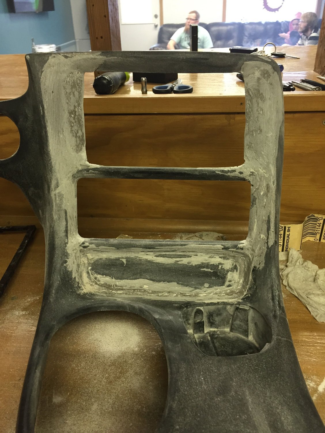

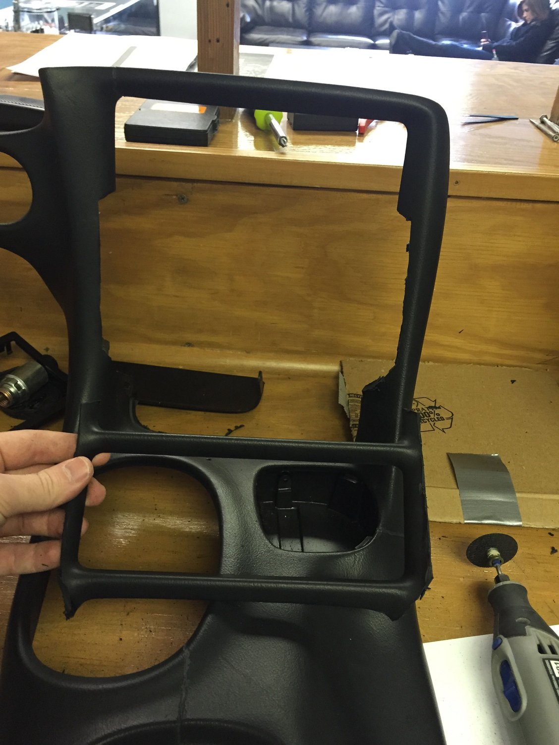

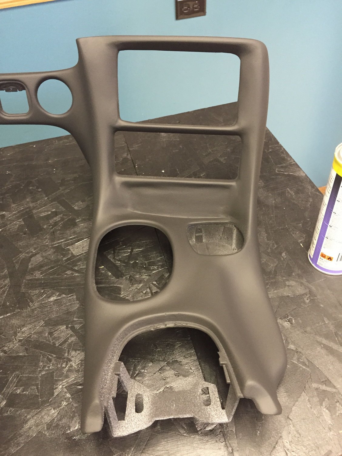

Finished her up, don't have any pictures current with the cupholder door installed but figured I'd post this up
