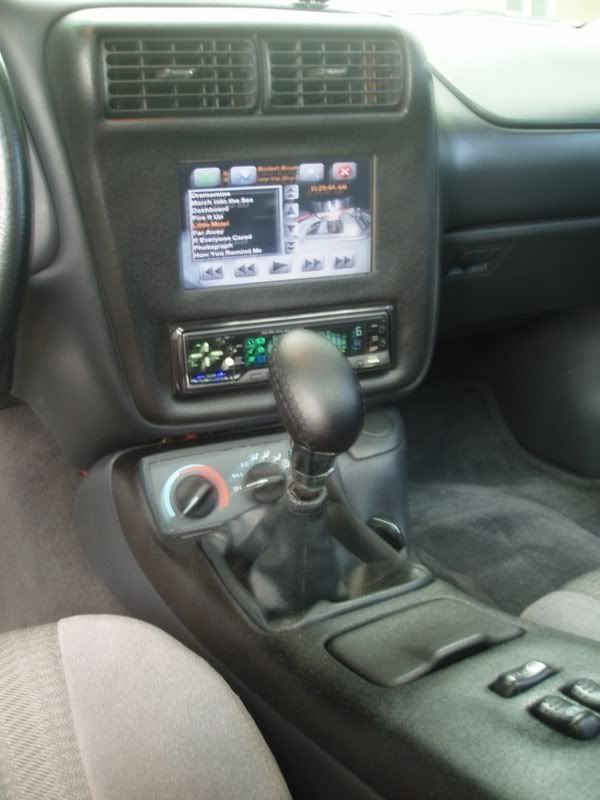

the Nexus 7 is one of the slimmer bezels which is why it's often used, personally I prefer to use a device with a MicroSD card slot so I can ADD additional storage to the device instead of having to buy the expensive higher capacity version of the device, some models have a adapter that allows the use of a USB flash drive, but those often take the place of the USB connection, I just prefer to keep my storage internal, depending on your music collection size you can rip movies down to MP4 format using programs like DVDFab then copy the video files to your device.
instead of trying to mess with a bunch of strange wiring the easiest way to set things up is to install a regular single DIN radio using a wire harness adapter (so you leave all stock wiring alone).
basically like what this guy did, if you read thru the thread, except for all the extra amps and subs that he added and maybe hiding the HU https://ls1tech.com/forums/stereo-el...reo-build.html

I was using Dementia's build as an example, you could move the headunit elsewhere (like the glove box or center console for example) so you keep the HVAC controls, or those could be relocated slightly (some guys have moved the HVAC to the glovebox), you don't have to do a carbon copy of what he did, just use the concepts of it which are:
from tablet to HEADUNIT to stock or aftermarket amps.
having the HEADUNIT (aftermarket stereo) allows you to pick one with the features you want like bluetooth calling, FM and Satellite radio and all those types of features, give me a little bit and I'll skecth up a basic diagram of how things would go and add it to this post, remember the Headunit doesn't have to go in the stock location.
Edit: Attached is the basic diagram using the headphone jack method to aux in on the aftermarket radio, you get power from a cigarette lighter adapter that puts out the required AMPS (tablets take like 2 amps to charge and most of them do at best 1 amp per port so you have to find one that puts out the proper amperage), the headphone cable goes to the aux input on the radio, the radio has it's wire harness that gets wired to a metra or scoche ( or whatever brand of choice) vehicle specific wires harness adapter you buy then that simply PLUGS IN to the stock plug that came out of the back of the factory radio (not shown is an additional add-on unit to retain factory steering wheel controls for the HEADUNIT) then your basically done IF you keep the stock amp and just upgrade the speakers which you can do with the level 2 setup from KeeAudio.
