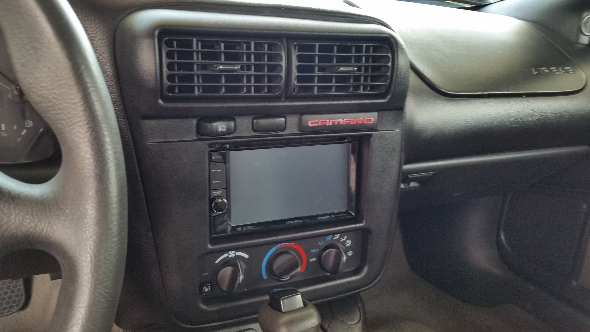

So I finally decided to upgrade the headunit. I went with a kenwood ddx372bt that I got on amazon for $200.

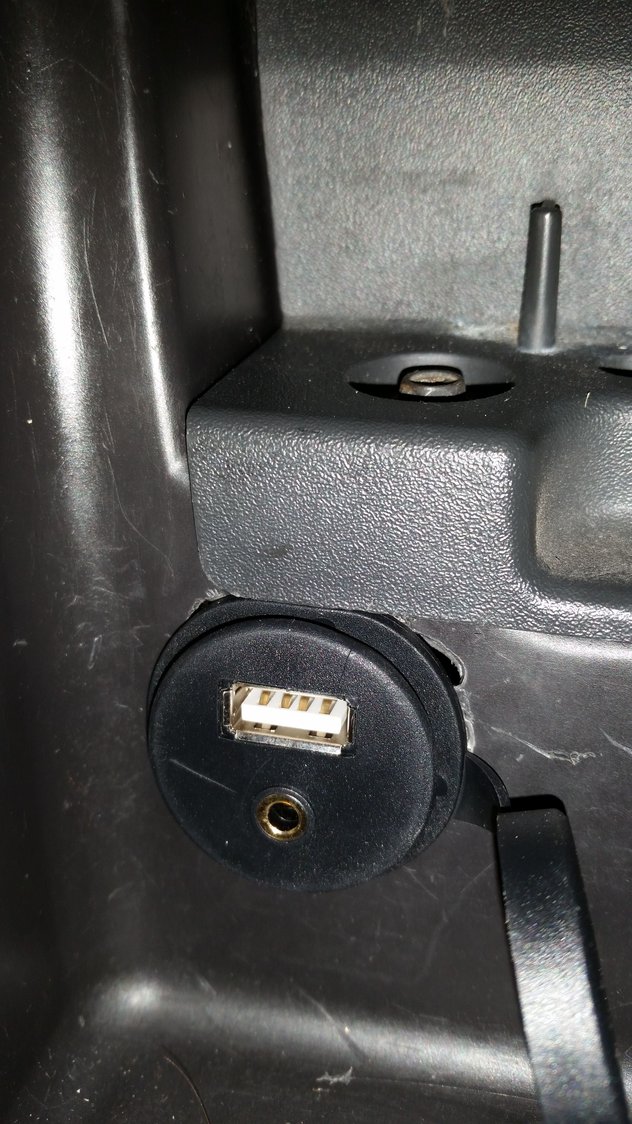

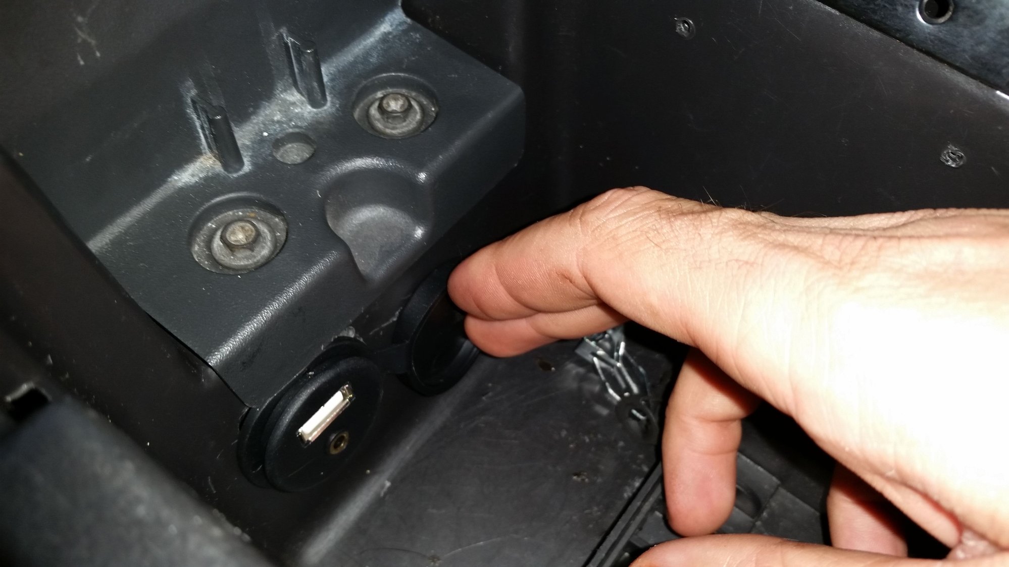

The unit has both the usb and 3.5 aux port in the back of the head unit. Rather than run the cables into my glove box I found this.
This cable was 15 bucks on amazon. I used a hole that was drilled by the police agency that had the car before me. Ran the cables through the console and behind the dash ( which turned out to be quite an easy job actually )
If you want links to any of the parts I used I can post those up.

Here is the cable I went with, although there are plenty of others out there. I liked the clean look of no cables exposed yet easy access.
Amazon.com : Rerii 1 Meter 3ft 3.5mm & USB AUX Extension Dash Flush Panel Mount Cable For Car, Boat and Motorcycle, FAST Delivery Guarantee : Car Electronics Amazon.com : Rerii 1 Meter 3ft 3.5mm & USB AUX Extension Dash Flush Panel Mount Cable For Car, Boat and Motorcycle, FAST Delivery Guarantee : Car Electronics

I just bought the metra kit and a sony double din, i'm having trouble getting the dash vents out of the original bezel. any advice? i haven't found anything online and i'm scared of breaking them. Thanks!
Old Jul 20, 2015 | 08:33 PM
FraziaFraz's Avatar
Joined: May 2014
Posts: 64
The vents just snap on. You can get them off with a flat head screw driver from the back side of the bezel. Slide the screwdriver in between the vent and the bezel and then pry space in between the 2 pieces and push it out. Don't put the screwdriver on the nibs where it actually snaps on. The break easy.

Hey OP, did you have any issues with that HU fitting into the metra bezel? I ordered that same bezel and i'm trying to fit a Pioneer AVH-X2700BH but the bezel is just a hair too small. It looks like i'll be using a file to sand the edges down to get it to fit. I noticed in your picture that the HU is not flush with the edge of the bezel, just curious if that was by choice or if it was due to the depth/mounting of the HU? Any help would be much appreciated.
Old Dec 15, 2015 | 05:25 PM
FraziaFraz's Avatar
Joined: May 2014
Posts: 64
It was slightly too small. I didn't want to file it down so I left it not being flush.

Turned out ok. Like you, I did not file down the bezel and left it alone. It's for sure too small for the HU but it's sits perfectly in there and I like how it's tucked back a bit. Seems like it's less likely to get hit by something and still looks like a factory piece. I looked a buddy's double din this morning and it's flush with the console, it just does not look as good. Thanks for your reply, this was the push I needed to just do it.

Looks great. I think it's better being tucked back in like the A/C controls just below it. Looks more factory.

There you go, that's the best way to describe it. It matches the HVAC stuff and just looks more factory than a flush mount.
