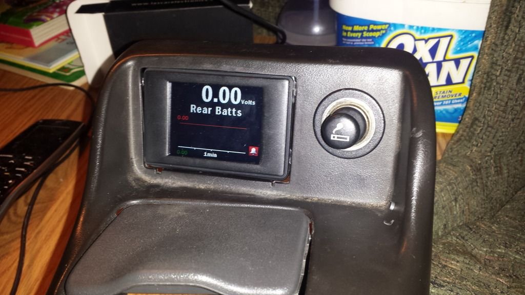

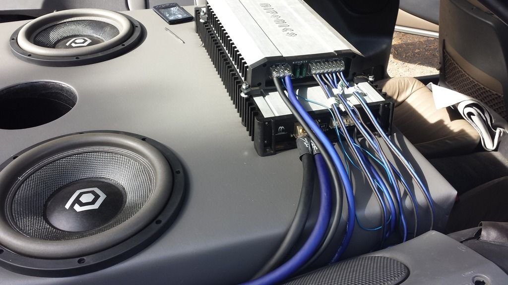

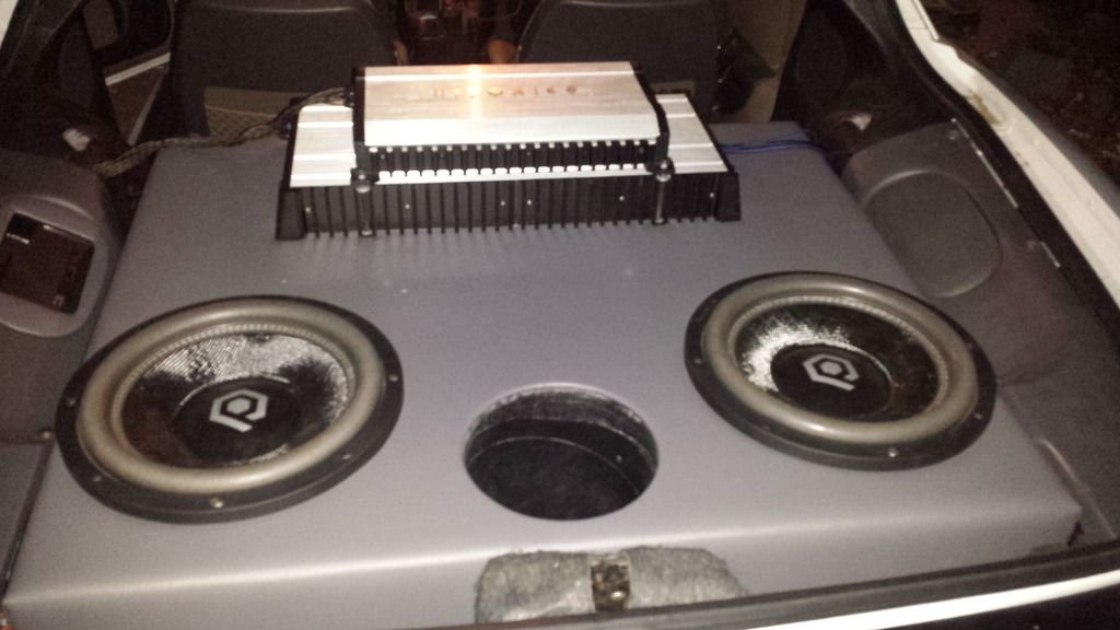

System consists of:
Pioneer head unit
Lascar SGD-24m voltmeter
Excessive Amperage 300 amp alternator
2 75ah agm batteries
SHCA 2/0 power/ground cable
Rockford Fosgate 3sixty.2
Hifonics Brutus BRX640.4
Hifonics Colossus
2 Soundqubed HDC3 12's in 5.3 cubic feet tuned to 36hz
CDT Components in doors and coaxials in rear sail.

That SGD-24m looks interesting, never seen one of those before. Nice build man, makes me wan't to start my build.

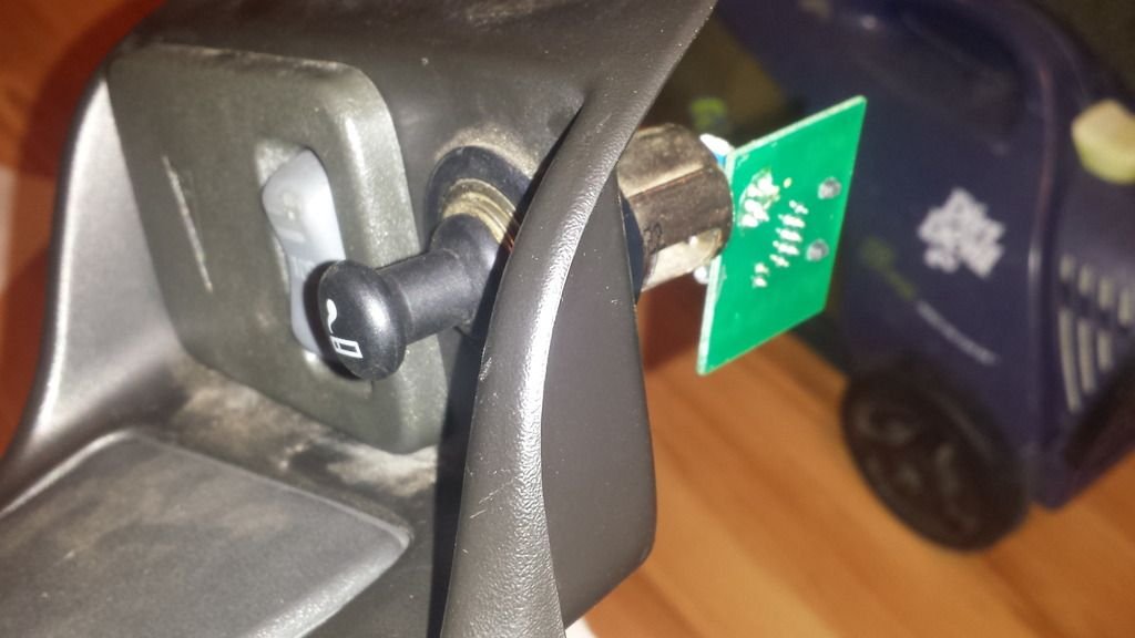

Yeah I am really happy with that meter. 2 inputs, quite a few choices for the graphs. I have it showing a 1min history graph with max and min. I also loaded a trans am logo it shows on boot.

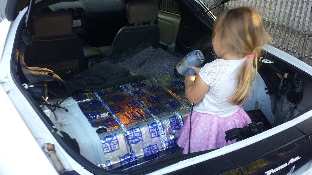

I was looking forward to seeing a comfy couch after seeing the second pic.......
Haha.. I see it now.
