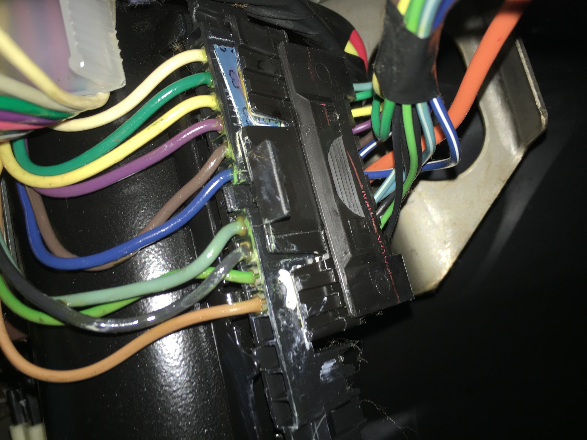

Ok so I picked up a computer safe circuit tester (3-28 volt tester light) I plugged it into a chassis bolt under the dash and tested with a known power source and light bulb turns on.
So now that I know the tester works I did the following:
Checked blue wire on turn signal socket (left and right) no power.
Removed radio to access the DRL and checked input and output (dark blue white strip, solid blue, light blue etc.. With ignition on and turn signal activated. No power ( just FYI the rear tail light blinkers do work) just not both fronts.
I tested the plug under dash that comes from the steering wheel (turn signal switch) I tested the purple (I believe it's input to the turn signal switch) no power.
:/ I checked the fuses again with the fuse checker and I get a solid green light (means it's good). I'm not sure what else to check... Any ideas whitebird?

I thought I had updated this but I guess not. FYI I fixed the problem which was a black plug under the dash that was not making full contact with all pins. I noticed it was loose so I pressed it back in and it make a click sound and was now fully seated and making contact with all pins. It's a black plug under the dash but right on the steering column.
