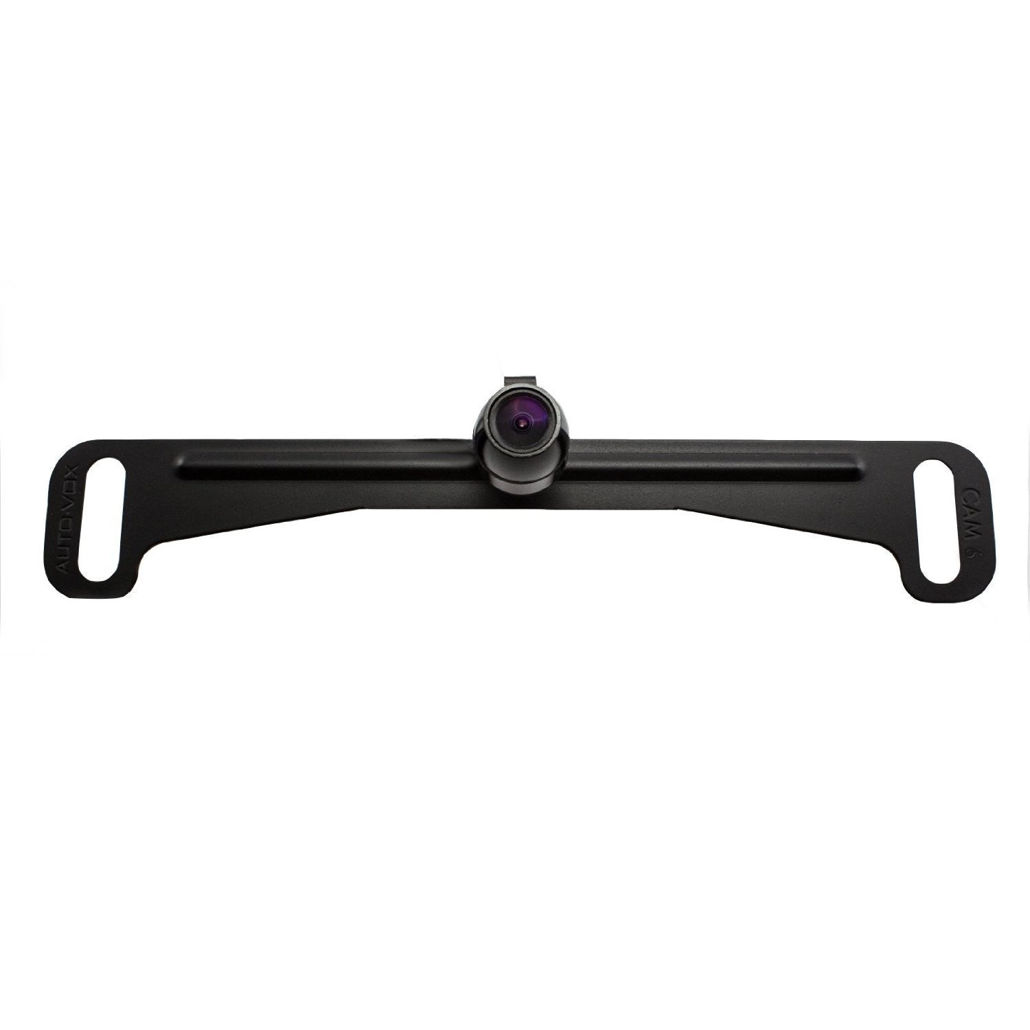

With the tail lights removed, I mounted the camera onto the license plate bracket to run the cable. I left everything loose for now to make sure there was plenty of slack:
As you can see, I attempted to follow the path of the license plate lamps. I managed to push the end of that wire through to somewhere I could reach from under the car.
It is difficult to see, but this is the cable coming through under the car.
After pulling the slack up from the plate, I used a flash light from the top side to find anywhere I could see through on the bottom. There is a small space under the driver’s side tail light that is perfect for passing this cable through. Seen here:
I guess the big fear is “What if you get rear ended??” I suppose if I get rear ended, the first thing on my mind will not be the back-up camera. This is a good spot and the cable has room to breathe.
From there, I shoved it through the existing grommet:
On the other side.
At this point, go ahead and re-attach your tag. This camera is designed to be mounted behind the tag, for some reason a lot of people put it in front. This is how it should go:
Impressive blurring skills, I know.

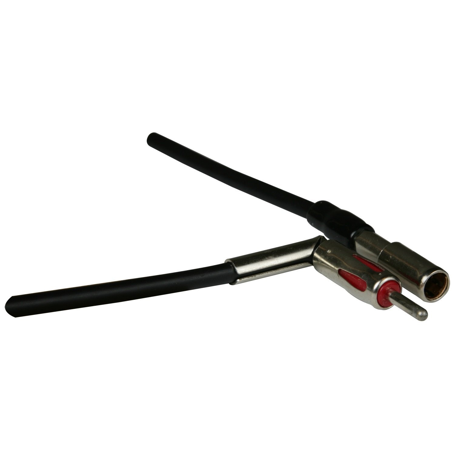

Go ahead and pop on your antenna adapter:
Then, run the cable from the passenger side through the front of the dash. It might get caught because the plug is sort of large, so just look for the path of least resistance. I was not really able to fit my phone in for pictures here. I tried to run the cable with the existing runs to the dash.

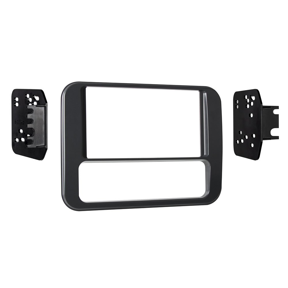

Then I opened up the new dash kit to get it ready:
People mention needing to do some trimming to the sides of this dash kit to fit the Joying units, which are just a hair over a double-din size. A Dremel will make short work of it.
Put the clips on the back side. This was fairly tough on the hands. The clips want to thread/bite into the plastic bits on the back of the face. With much perseverance you will make it happen!

The Metra kit comes with brackets that pig-ear onto the sides to be bolted in. Well, I could only get one hole in either side, which means this would have been held in all flimsy. So, I used a dremel and made a few new holes and widened some of the existing ones, as seen below:
Next, we had to use the dremel on the trim. There may be a better way to do this, I am not sure. I actually needed to trim down on the sides and the bottom, your experience may be different:
