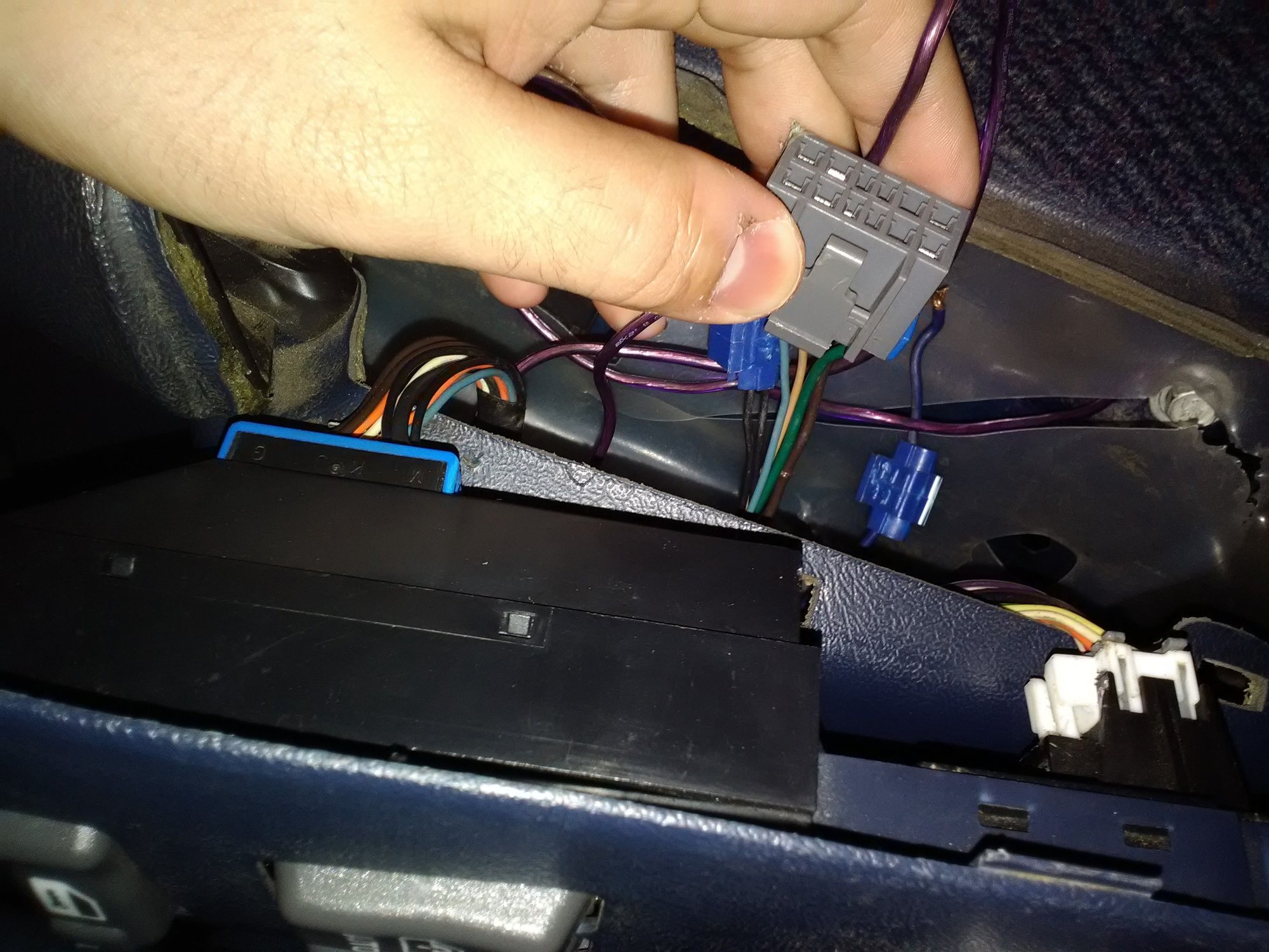

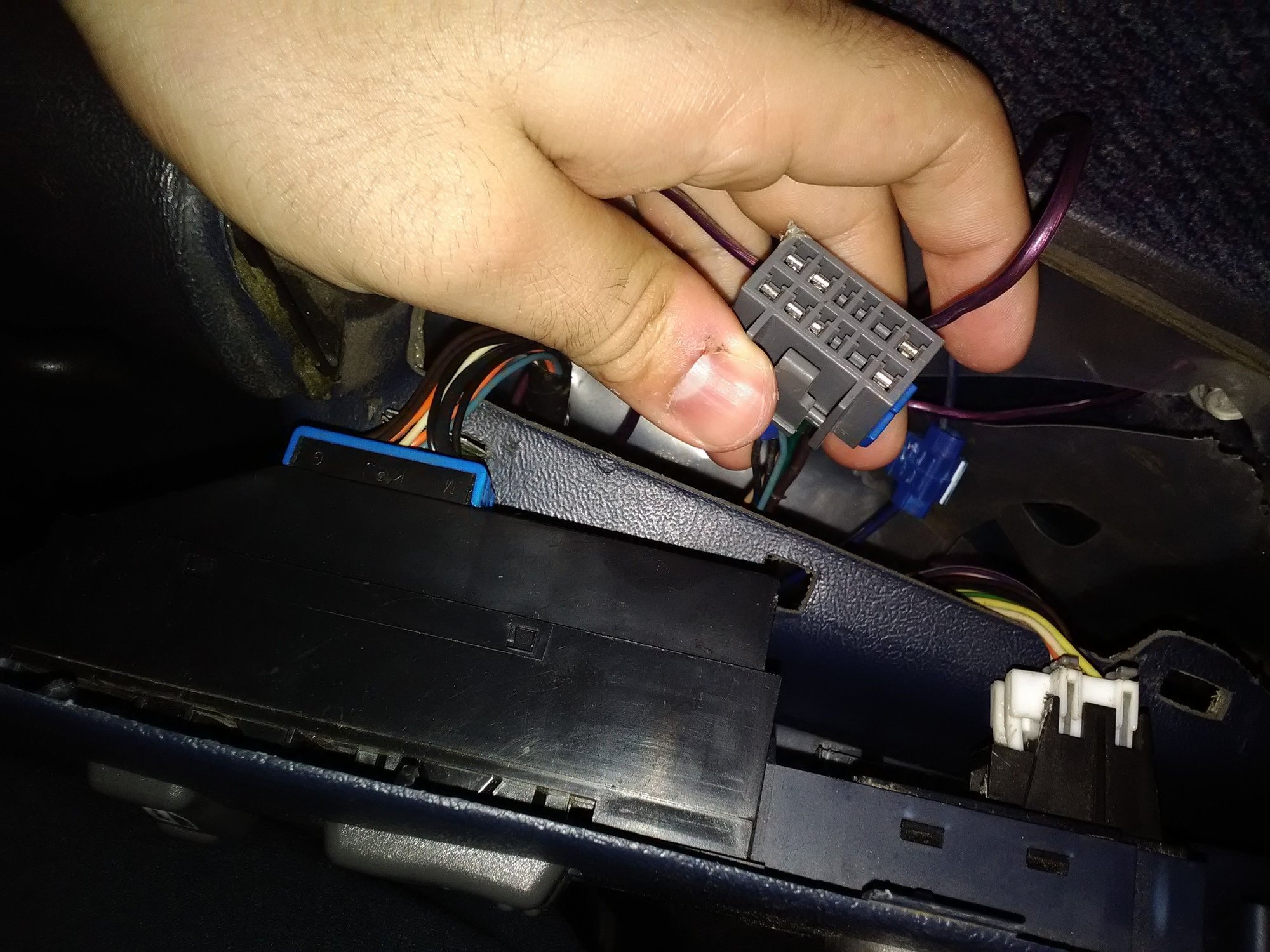

its from the driver side door in my 1999 gmc sierra. it connects directly to the power window switch on the driver side door. theres two of them. one to control the drivers window and one to control the passengers window. the one connected to the driver side, one
of the cables pulled out which caused the switch to become unusable. i want to replace it but i dont know what its called.

If a wire pulled out just get a new terminal crimped on and plug it back in to the connector. The terminal is only held in the connector by a tiny metal tab. Push the terminal into the connector as far as you can and stick a pin or small nail between the top face of the terminal and the plastic connector to depress the tab and then slide the terminal out. It sounds confusing at first but it's really not.

Just remembered, unclip the blue plastic clip that's on the back of the connector first. It's there to keep the terminals from backing out so trying to pull out a terminal with the blue clip still attached will never work.
