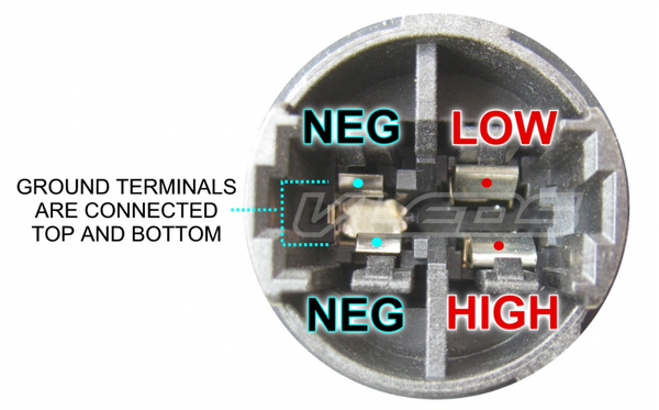

You can't "turn on" your DRLs (Daytime Running Lights) - they go on with the ignition as long as the parking brake and headlights are off - so what lights are you referring to? I would guess you mean the parking/running lights that come on with the headlights. Those use a different filament in each bulb than the turn signals, hazards, and DRLs use. The bulbs have a dim filament for parking/running and a bright filament for the other functions and those filaments are on separate circuits (they're not just reducing power on a single circuit). So your left side is working properly, switching between the bright and dim circuits but the right side is only using one of those two circuits. The fact that they appear out of sync (they can't actually get out of sync since they use the same flasher) suggests that the socket wires are connected incorrectly. Perhaps you have the ground wire and one of the power wires reversed. That would cause one filament to lose its ground connection (both sides share the same ground) making it flash on-off rather than bright-dim.
There are three wires to the front lamps - black, blue and brown. Black is ground, blue is turn signal/hazard/DRL power, and brown is parking/running light power. Use your test light or multimeter to test the socket and confirm that you have ground all the time, power on the low pin with the headlights on, and flashing power on the high pin when the turn signal or hazards are on.
(image courtesy of V-LEDs)
As noted in the image, you can tell which pins are ground versus power by looking for the ones that are connected together inside the socket... you will probably need a bright light but you should see the metal connection at the bottom and/or around the end of the slot (the socket above has both).
Doing those tests should help you confirm which wires are reversed so you can reconnect them.
