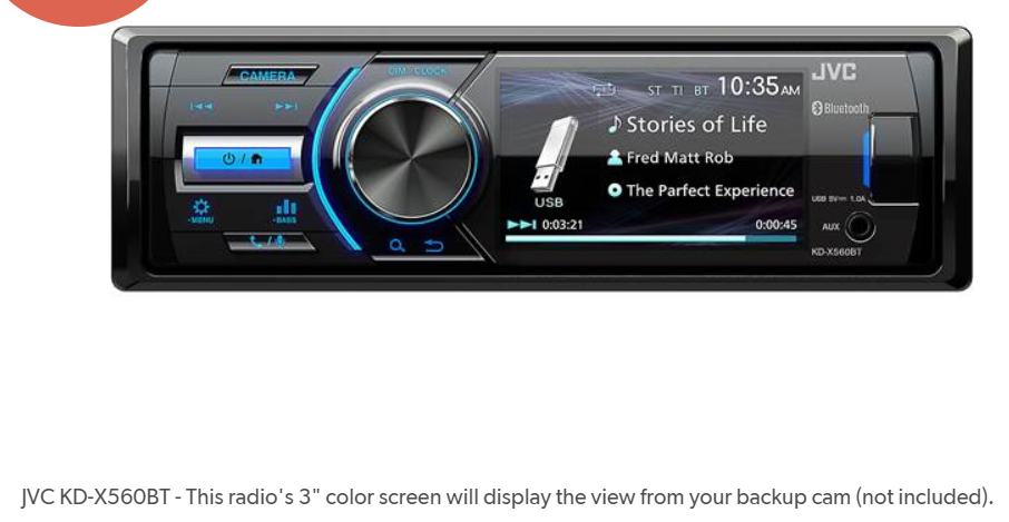

I kind of liked this single DIN JVC with unique 3" TFT display - but then I found out the buttons only light up blue. No variable color illumination.
