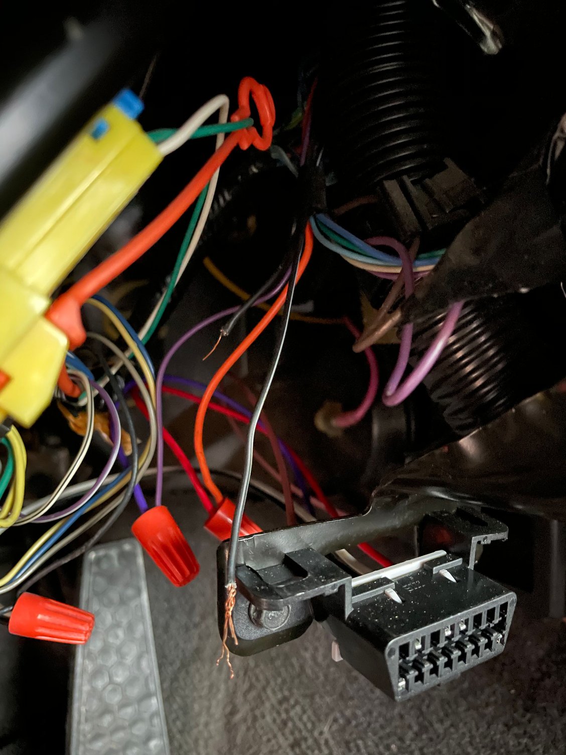

So I picked up a project car and the previous owner hacked it up pretty bad.
the Speedo works, but the tach and fuel gauges are not working.
I took a peek under the dash and he used wire nuts to hack in a new obd2 port.
anyone know what these two black wires should go to?

Update: I pulled the passenger side trim off [side note: there's one screw by the passengers seat where you cant fit a screwdriver in - a lot of cursing happened]
I spotted some corrosion on c220 so I pulled C220 and C230 apart and sprayed some deoxit on it and put them together a couple of times.
All gauges now work expect for fuel level.
Going to see if I can get a scanner on this weekend, and maybe check those connectors again (since the fuel sending wires also use these connectors)

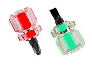

For future reference, to reduce frustration with that one screw next to the seat, this pair of screwdrivers ($6 for the pair) will do the job:
Ultra short screwdrivers.

Nice, I'll pick up a set of those sewing machine screwdrivers for when I am ready to put the panels back on. Previous owner left a lot of wiring that I will need to solder and shrink wrap, luckily I'm good with electronics.
