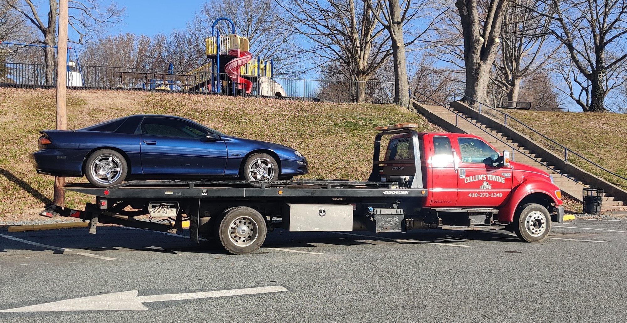

Owned car for 3 weeks.
2nd time stranded.
Key will turn in ignition but nothing. No dash lights etc. Stereo stays on weirdly.
Security light sometimes. I have a Rick's vat bypass with proper resistance. Installed that just now. No dice.
Last time after awhile it just started.
Kept messing with it nothing. Had to leave it there.
Cleaned resistor pellets.
Ignition cylinder feels sloppy. Is that my problem?
Also weirdly sitting there with nothing on occasionally heard a light clunk and once the windshield wipers moved a bit.

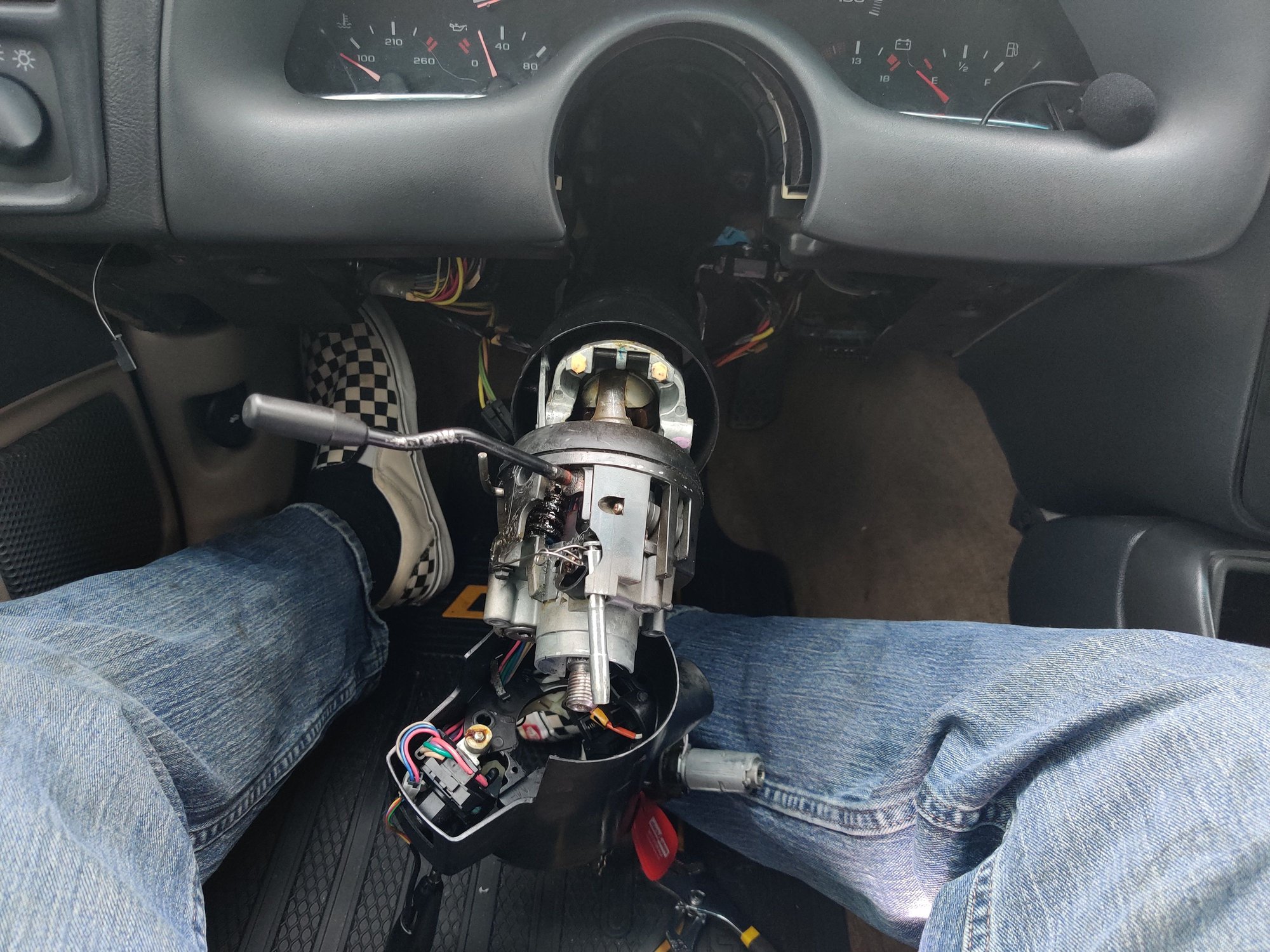

I should have updated sorry.
replaced steering column. Thought it was ignition switch but the connection for the actuator rod was all bitched up at the key end.

You're not kidding. I disassembled the entire column in a parking lot.
