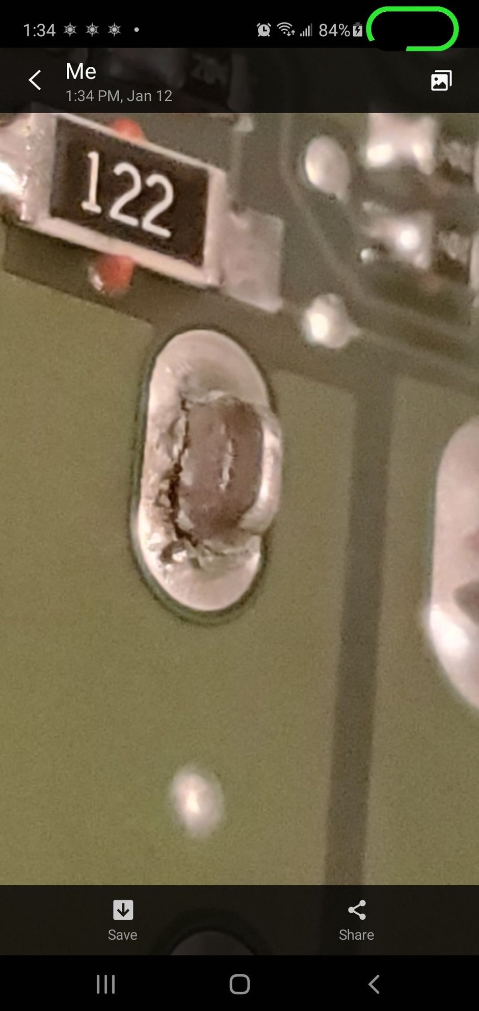

I am not aware of an aftermarket replacement harness for the BCM. But I can almost guarantee that the problem is with the solder joint even if a crack is not evident. Flexing will cause intermittent disconnect of the RAP circuit causing the radio and windows to stop functioning. I'd bet that reflowing the solder joint will get rid of the problem even if it doesn't look like it.

The car is just sitting now, so I'll put out the bcm and take a few pics of the solder joints.

The RAP circuit solder joint problem is the most common problem with 4th generation f-body BCMs. In fact, it's just about the only problem that commonly happens with the BCM so it's not unlikely that a used replacement might have the same problem.
However, if the dark blue wire in the black connector is loose, it could cause exactly the same symptoms. You should be able to tighten it with careful use of needle-nose pliers. I would try that before pulling the BCM for solder repair.

son of a bitch, it's cracked...

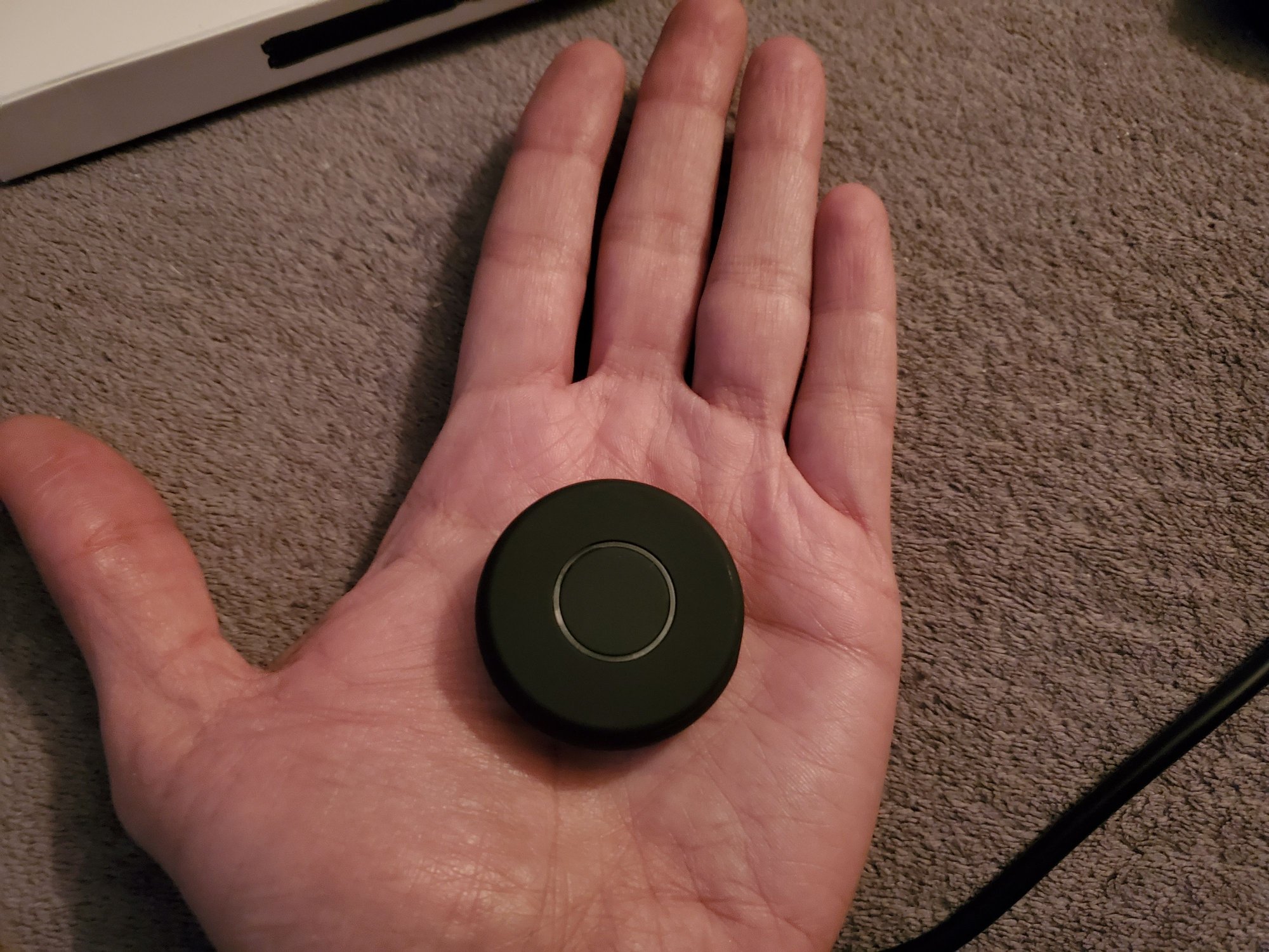

Gonna hold off the head unit. Picked up this bad boy for less than $20. Now I have bluetooth in the car and it's portable. No extra wires for steering wheel controls and I used the same RCA adapter piece I had gotten for my old mp3 player. The RCA cables had to get changed though. Sound kept cutting in and out and I thought it was a loose wire in the back of the HU but it was the RCA wires the whole time. Used the ones that came with the bluetooth and yeah sooooo much better!

dumb question but what is that and how does it make a stock car bluetooth?
Old Feb 6, 2021 | 07:33 AM
Roarin_8's Avatar
Joined: Aug 2002
Posts: 4,578
Likes: 49
From: Kissimmee, FL
Not a dumb question. It's a bluetooth receiver. It hooks up with rca jacks to the back of the stock headunit, you then pair it up with your smartphone. You do need an adapter to get the rca female inputs for this work. I had gotten the GM9-AUX years ago to hook up my mp3 player before it got discontinued. Check the monsoon sticky as whitebird stated another adapter that can work.
Image of the GM9-AUX and you can see the rca connections labeled red and white.
