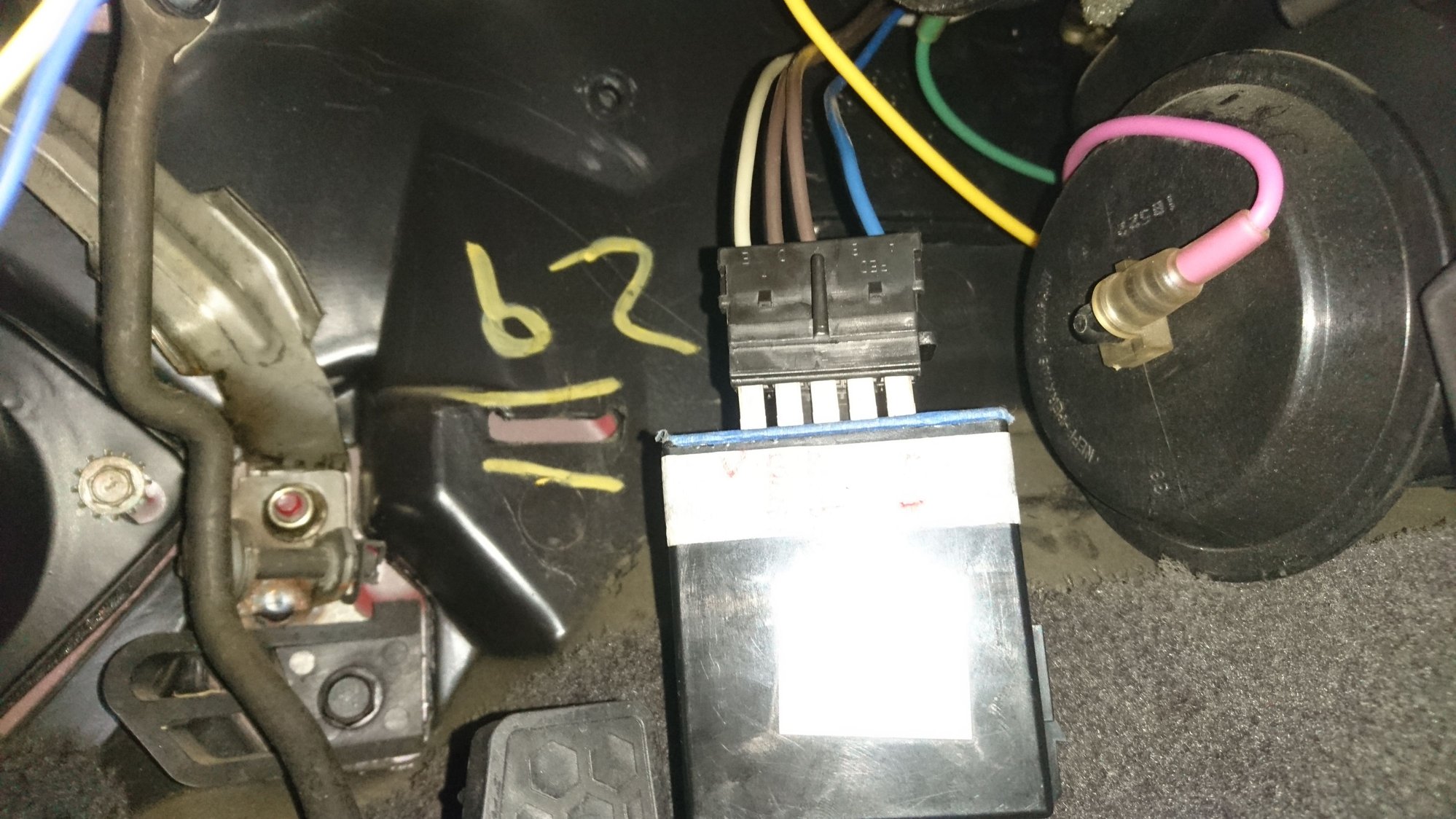

Thanks, Is it possible find a schema for teh Power Window Modul sitting under the dashboord?
See Picture.
Thanks

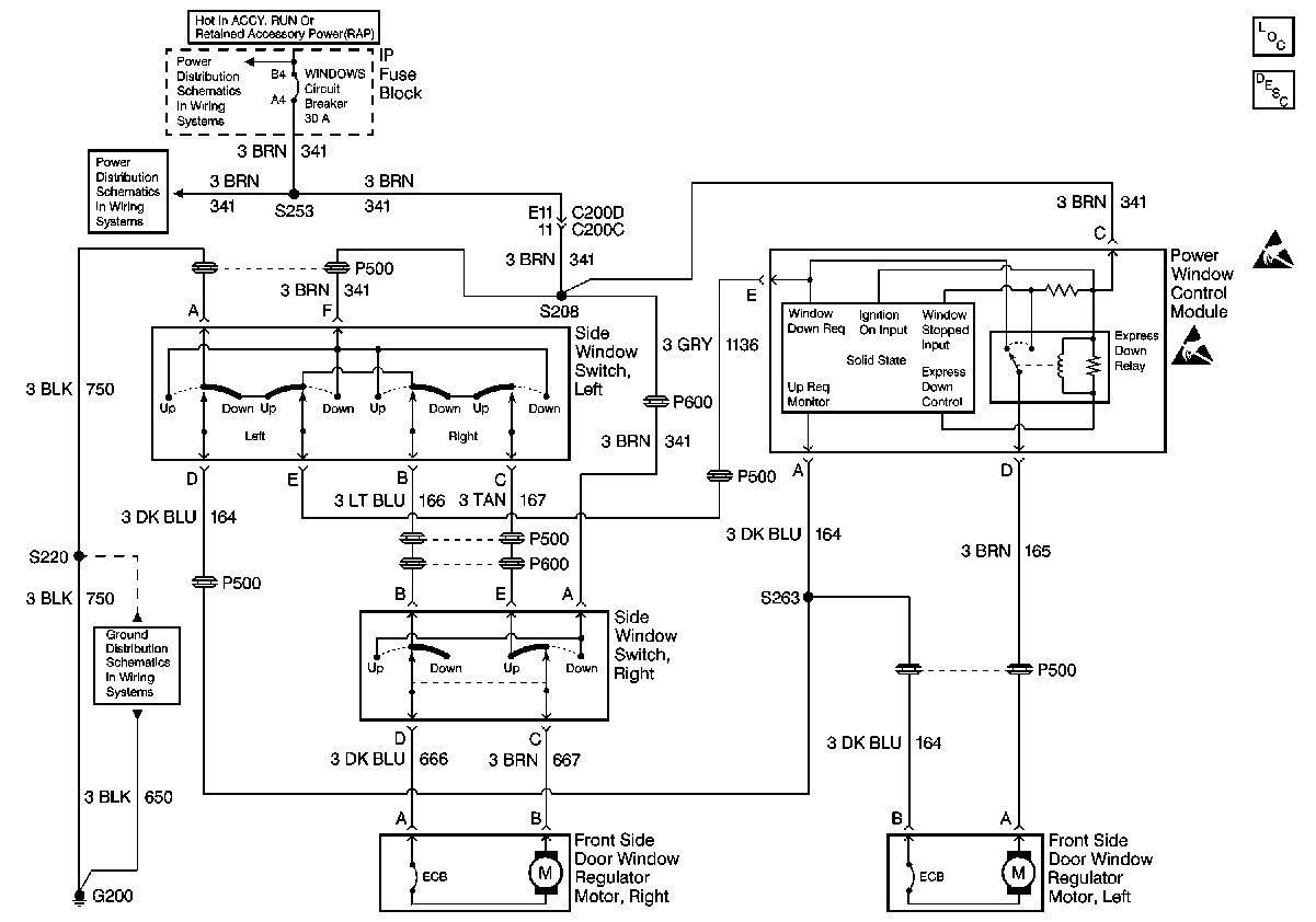

Sorry for the delayed response... for some reason I just got the notification email this morning.
The wiring of the Window Express Down module is included in the posted schematic... labeled Power Window Control Module in the upper right of the schematic.
