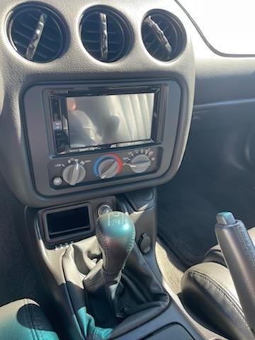

So I'm doing the opposite of what most people are and I am wanting to reinstall the original Factory head unit and amp that was in my 2002 Trans Am WS6. That and the exhaust are the only two things on this car that are not stock, and I want it to be set up just like it was when it rolled off the showroom floor. So my question is how difficult will this be to do? Any tips or pointers will be greatly appreciated.

That's a double-DIN head unit and bezel, so you would also have to get an original bezel (the original head unit is only 1.5 DIN).
It's possible that the previous owner removed the Monsoon amp and installed a bypass connector there to avoid rewiring all the speakers. Not a good idea, but in this case it would make it much easier for you to return to stock... especially if they were good enough to use wiring harness adapters rather than butchering the factory wiring. Then it would be mostly plug-and-play to return to stock. Even if they butchered the head unit connectors, they are readily available in the aftermarket for replacement.

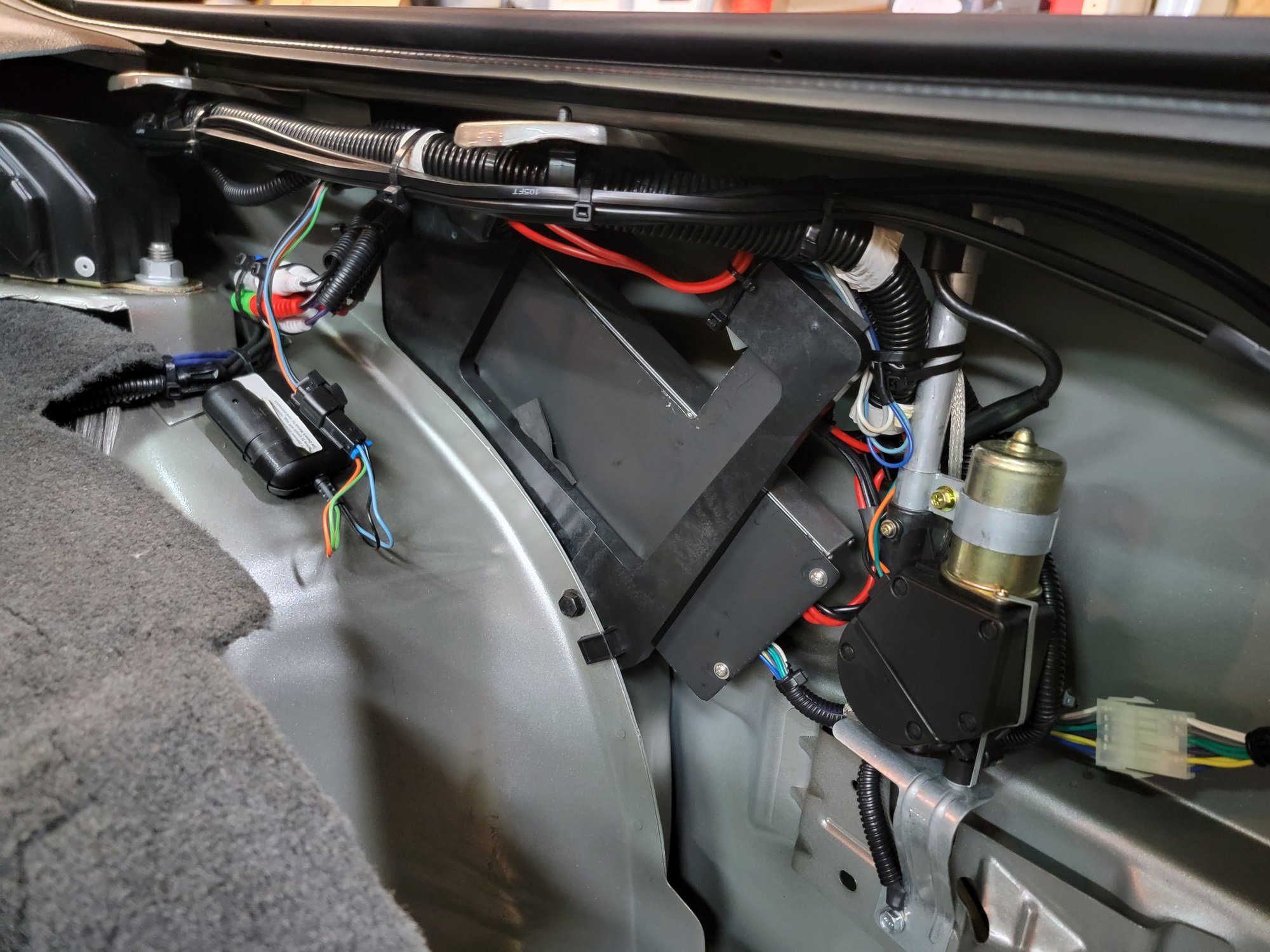

I took the rear passenger panel off and it looks like they rewired everything, so this doesn't look like it's going to be a fun job. I didn't pull out the head unit to see if it was butchered up or not though.

I don't see the factory amp connector there - is it still there or was it removed? The wiring they did looks neat and clean and appears to be separate from any factory wiring, so that's a good sign. Looks to me like they took the time to do it right, so you may find that the original connectors are intact and just left disconnected. That would make going back to stock much easier.

Yeah it looks like they did a good job of keeping it clean, but I can't find the factory connector. I haven't disassembled all of this, but I did feel around behind the amp and everywhere that I could.

I see lots of zip ties there. The original connectors could be zipped up and out of the way and out of sight.
