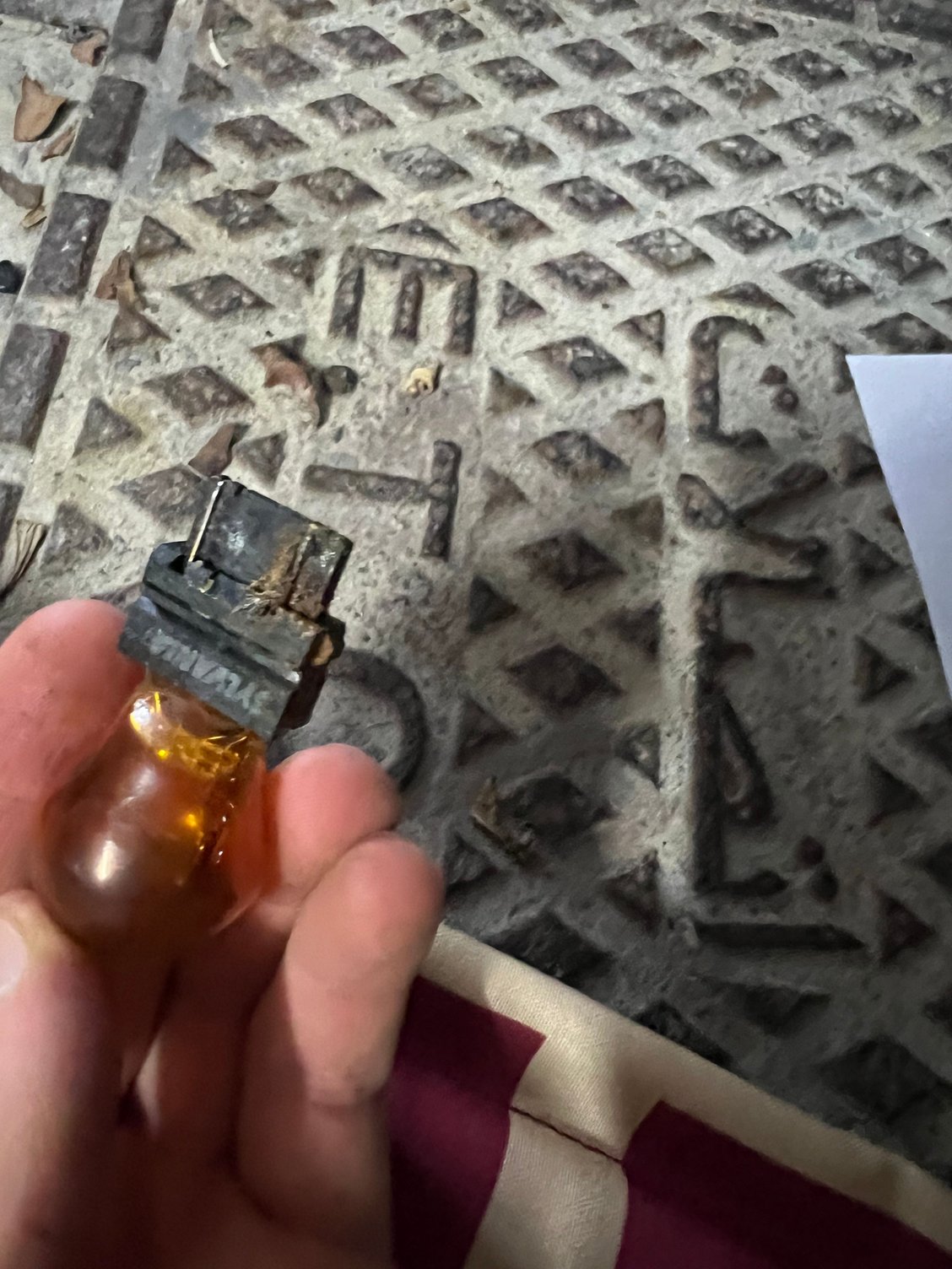

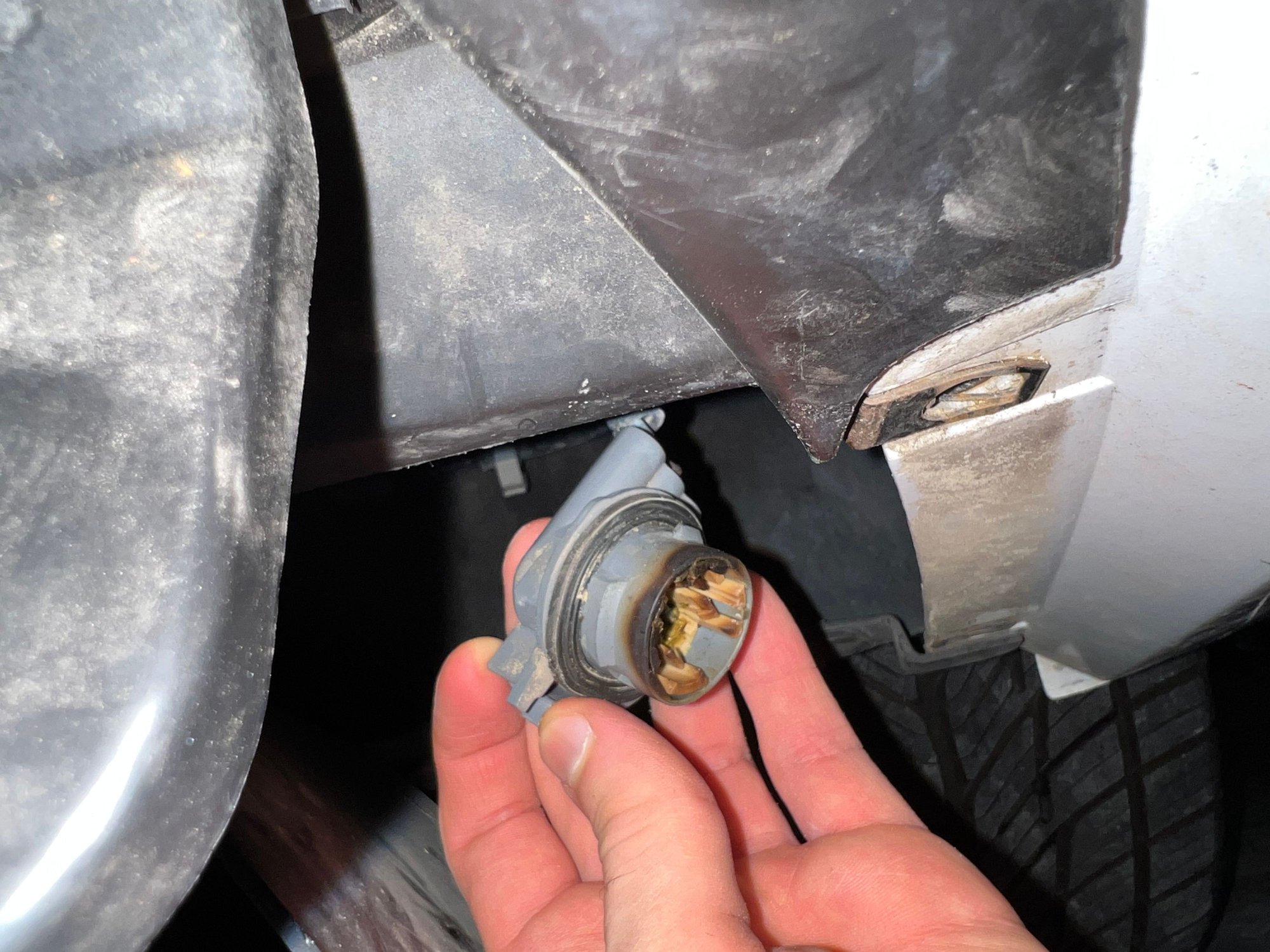

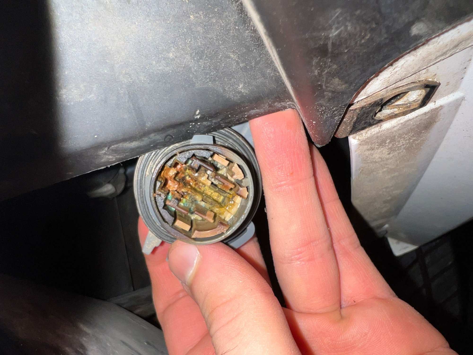

unfortunately, my driver side turn signal (DRL) stopped working (it’s the yellow light), it’s working fine on the passenger side though, I have a set of extra light bulbs and I thought it would be an easy fix, I noticed that the turn signal socket has corrosion and it looks to be charred or burnt, and the bulb it self has the same corrosion as well.
should I just buy a new socket and remove the old one? Which one should I buy? Not looking for a cheap one though, I’d rather spend the money for a good product.

I am not sure on the availability on that bulb housing. Maybe online or ebay.
I would first try cleaning it with electrical cleaner. spray it, let it soak, and clean the contacts and insides with a tooth brush. get it as clean as you can. Let it dry completely. Then install a new bulb, and see if it works. If not, you will have to find a new bulb housing.

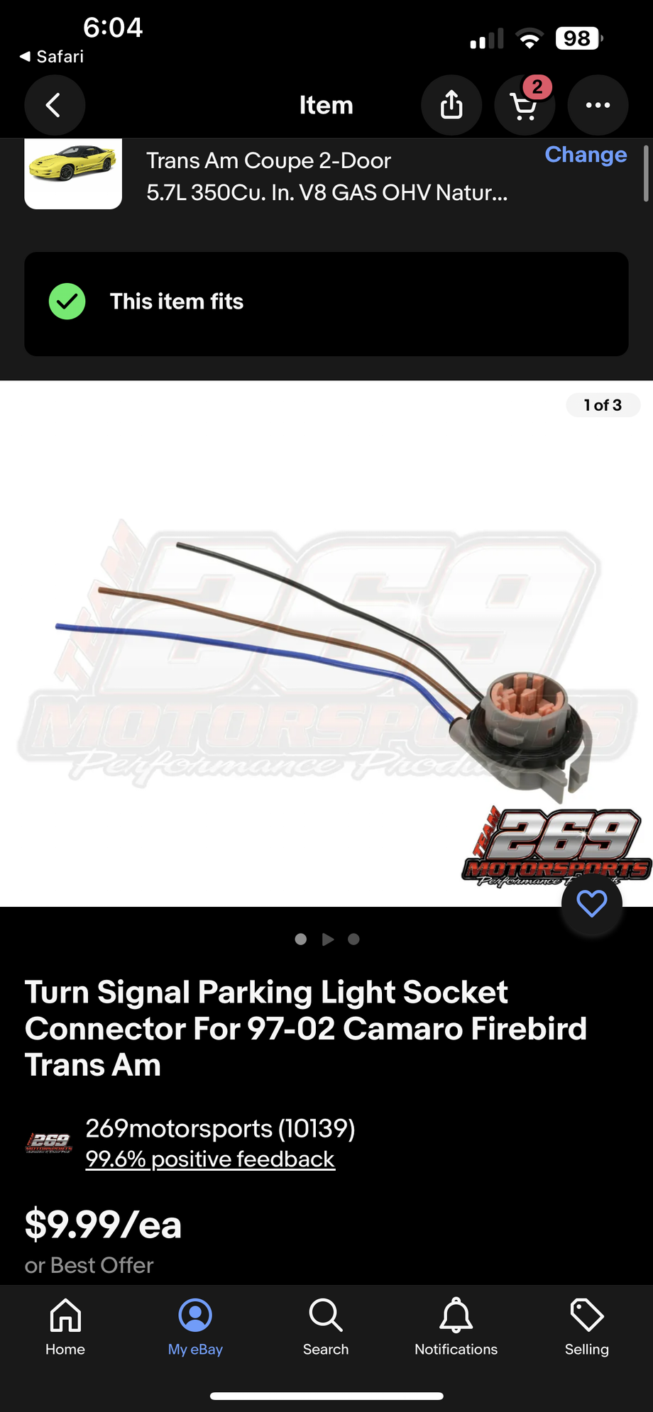

I’m thinking about ordering the turn signal housing (lenses) from Depo, I already have 2brand new bulbs,
but not sure what turn signal socket I should buy, I’ll search to see if standard has them. Or if you have any other suggestions, I appreciate it.
I found one from 269 Motorsport. Has anybody tried them?
thanks guys

I read the above sticky thread, so I can basically use the new socket with the factory wires without any splicing? But does the socket have to be the same part number 85881from Dorman for example, or does this method also works with other sockets like the one below?

I ordered the lenses from Depo on Ebay, and got a pair of 269 Motorsport sockets, they have the same factory color wires as well so that’s a plus.
