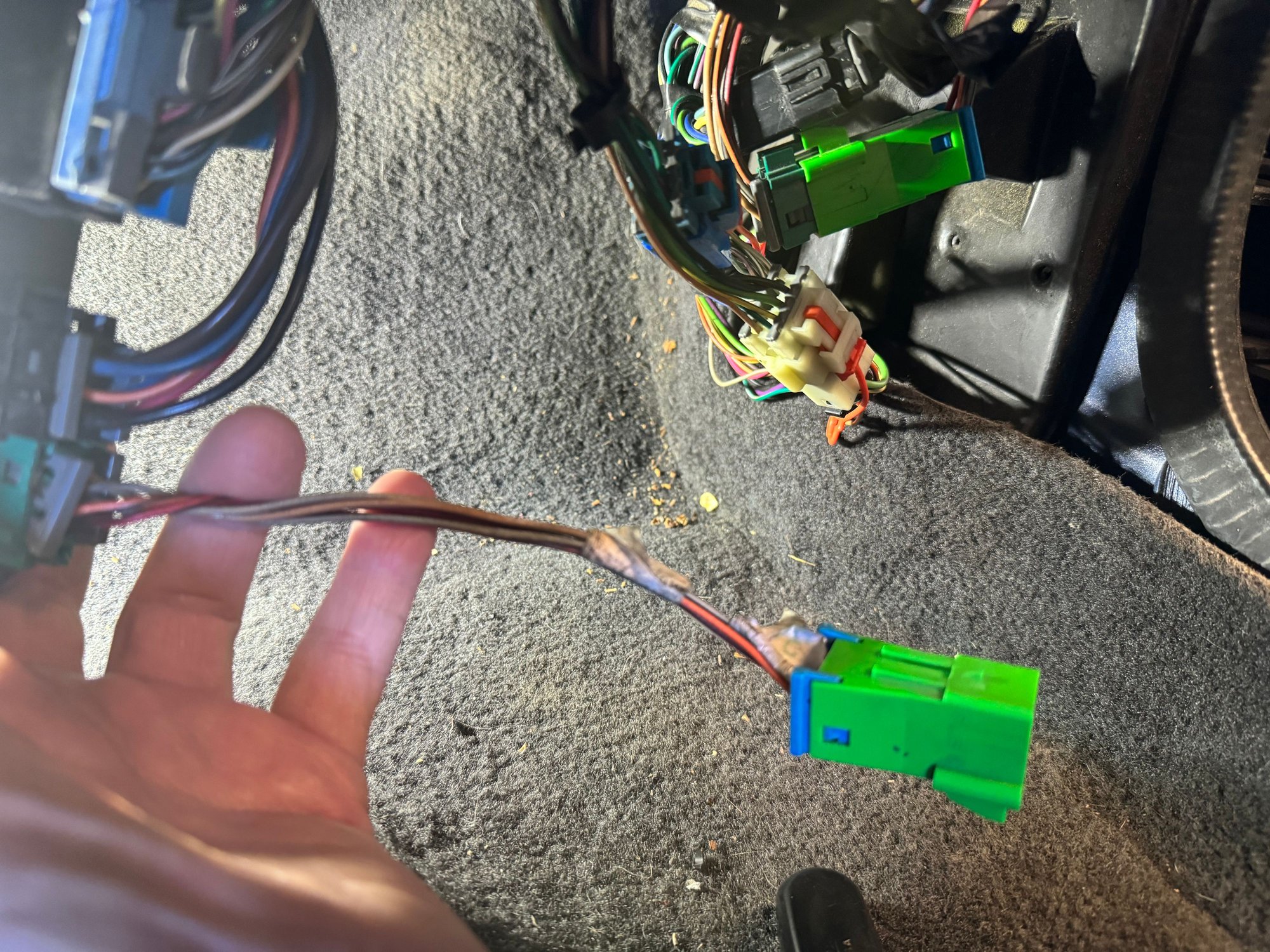

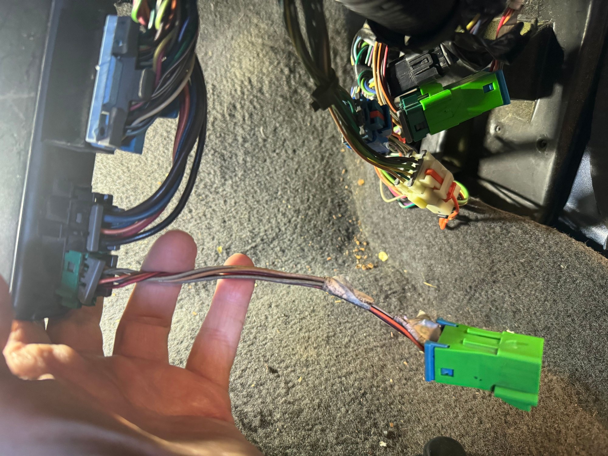

Would anybody know where this short green/green plug harness plugs in? One end hoes into last plug on BCM, other end goes to?

It looks like the connector containing the wiring for the door lock circuits...
Green 6-pin connector
A TAN - Driver Door Unlock
B GRY - Lock All Output
C RED/BLK - Lock All Input
D ORN/BLK - Unlock All Input
E GRY/BLK - Passenger Door Unlock
F - Not Used
