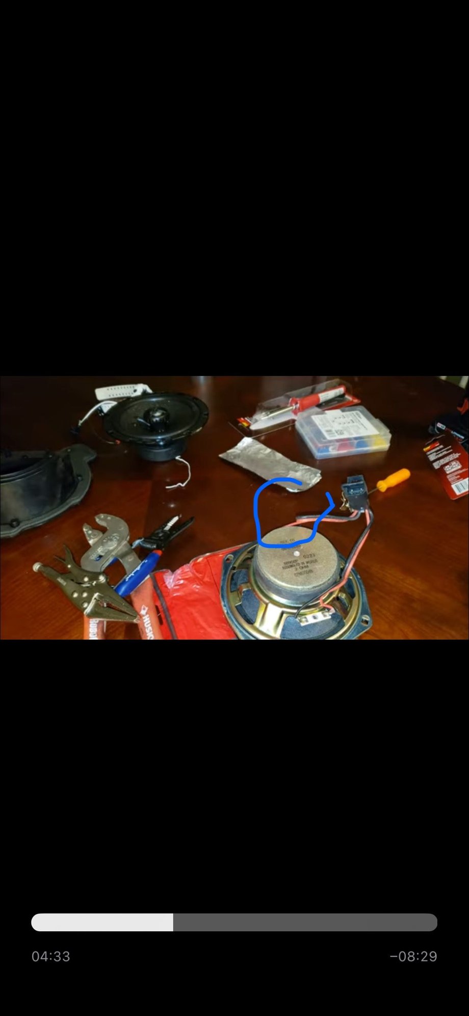

I bought pair from Kee and I’ll be installing them sooner or later.
I know that this probably has been beaten to death, but I have a couple of tweeter questions. I realize this is a simple question, but to wire the tweeters in you just clip the harness off of the old speaker and you tie them into the tweeter portion of the harness? Also, should I use the tweeter filters or not? I’m using the stock HU & amp.
Clip and wire the tweeters to the circled wires?

Yes, use the connector off the original speakers to make the new ones plug-and-play.
No, do not use the high pass filters - the Monsoon amp already does the filtering for you.

Thank you sir.
