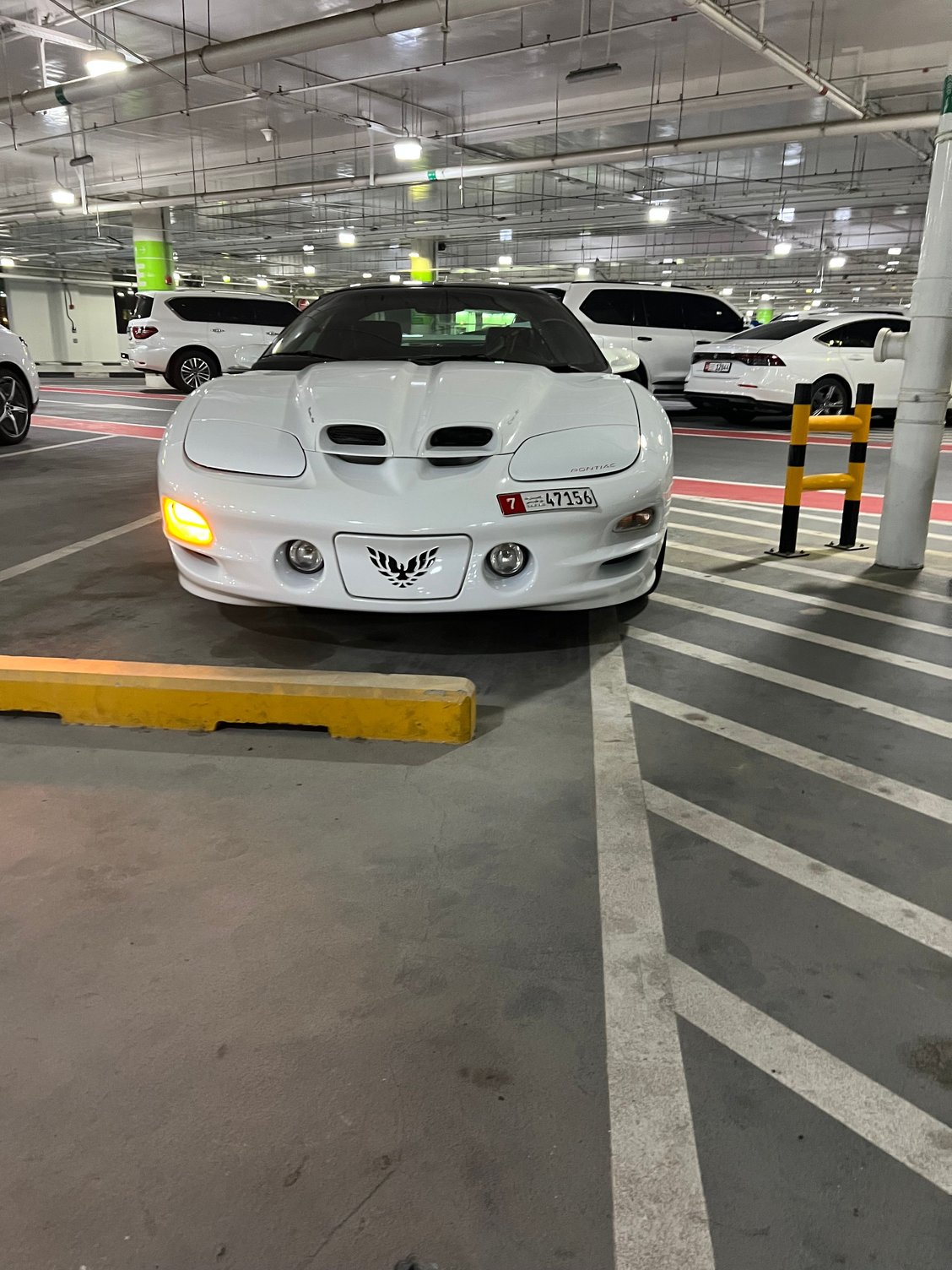

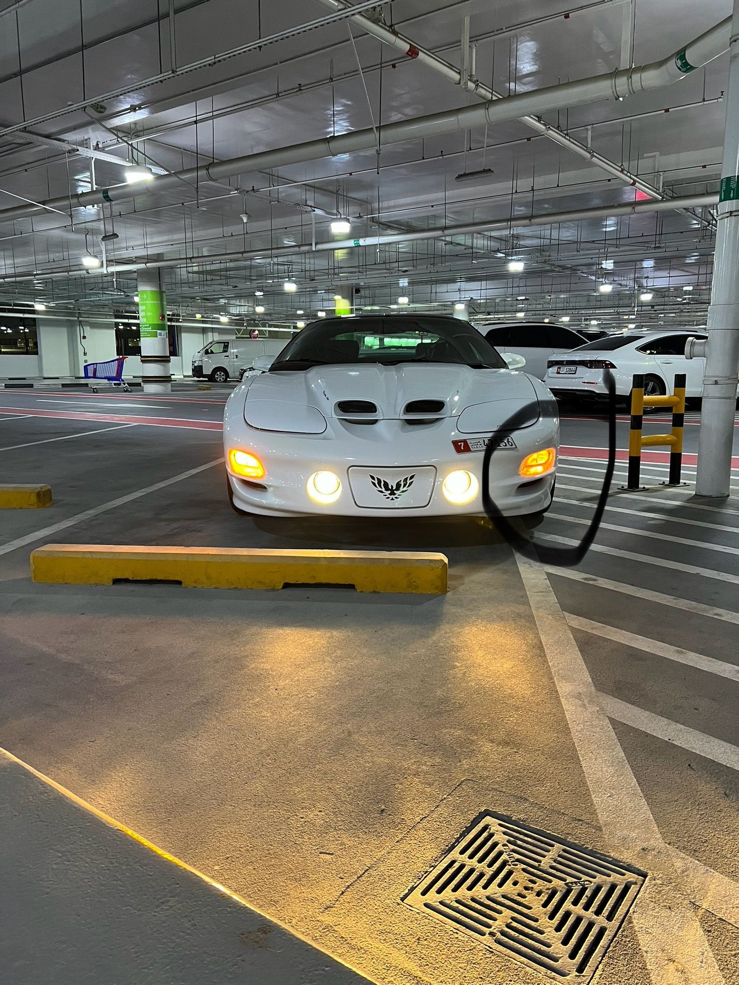

Hey guys, hope you’re doing well. My driver side turn signal is not blinking, and as you can see from the below pic that it’s a little bit weaker than the passenger side, I switched between the driver and passenger side DRL bulbs and it still didn’t work, I then cleaned the driver side socket with some tissue and it worked a couple of times then it stopped again. I replaced both light sockets and bulbs (3157 NA) about 18 months ago. And I don’t think there’s any issues with the tail lights on the driver side either. What do you guys think? I appreciate your help and feedback.

Do your DRLs work? It looks to me that you are seeing the dim circuit on the left side - part of the parking light system (fog lights are on). The turn signals and DRLs use the (completely separate) bright circuit on each side. Check your DRLs with the lights off, ignition on, and parking brake disengaged. If the right side lights up but the left side doesn't then that bright circuit is the problem. It won't be the bulb since you already switch them side to side, but it could be the socket, the blue wire between the DRL module and the socket, or even the DRL module itself.

Edit: thank you for your reply, i tried your way (the lights were off, engine ON and parking brake disengaged) the driver side DRL is completely off now. Please see the below pic, any suggestions guys?
many thanks
edit: when turning on the hazards all the light blink except the driver side DRL .

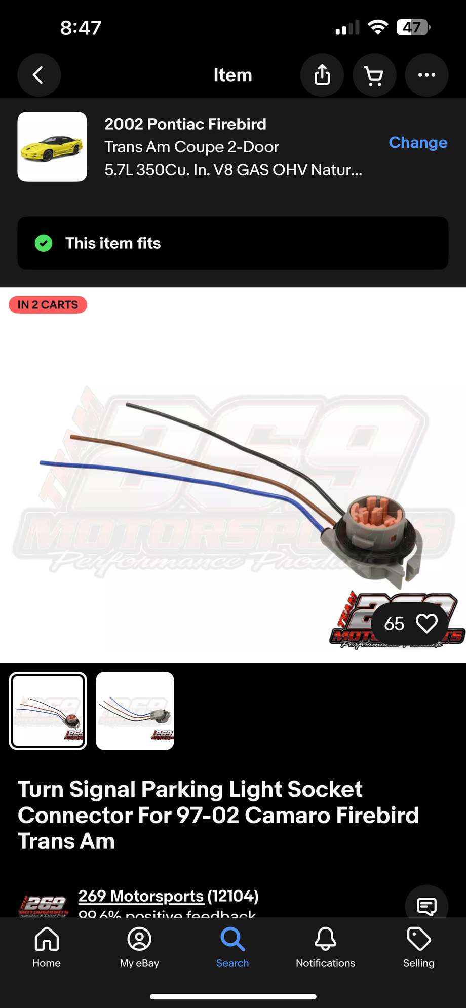

The car has 269 motorsports sockets, they even have the same colored wires as OEM, I installed them about 2 years ago with new bulbs, I still have the OEM sockets, they were in rough shape but I cleaned one as best I could.
Does anybody know what’s the part number for the OEM turn signal socket & what brand it is?
Just incase I needed one in the future.
