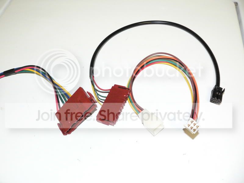

I needed to replace the flat connector with a small square connector to get it to fit under our little "headliner".

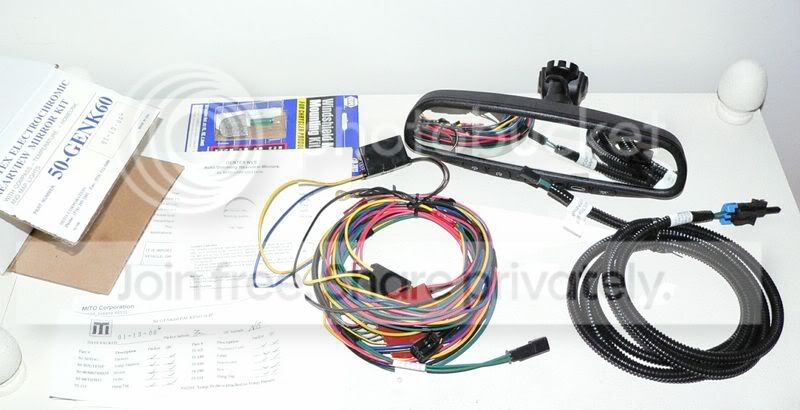

Here's a picture of my kit
Originally Posted by BJM
I was wondering about getting it to fit. What kid of connector did you use?
I got the connector from: www.allelectronics.com Look under "connectors (multi pin)"
Here's a picture of the huge flat connector and the square one I used...
