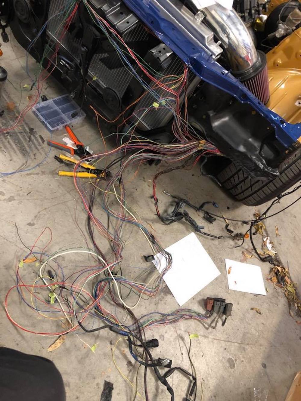

bad wiring
LS Swap Wiring Woes
If finding LS swap installation accessories is easy, wiring may be the most terrifying aspect of any swap. No one wants to destroy a new engine, build a car that doesn’t run or, worse, burn down their ride.
Taking a glance over Zero2Sixty Performance’s social media accounts, you note that David Lampe and his team spend a fair amount of time fixing other shops’ sloppy wiring (pictured above). “We had a Jeep that came in here and the guy says, ‘You know, I need you to look over the wiring, it doesn’t run. I can’t figure out why.’ Came into the shop, we hooked the battery up to it, and the battery literally starts smoking. And so we look at the harness and all the wires are red. So, there’s only so much diagnosing you can do when every wire is red.”

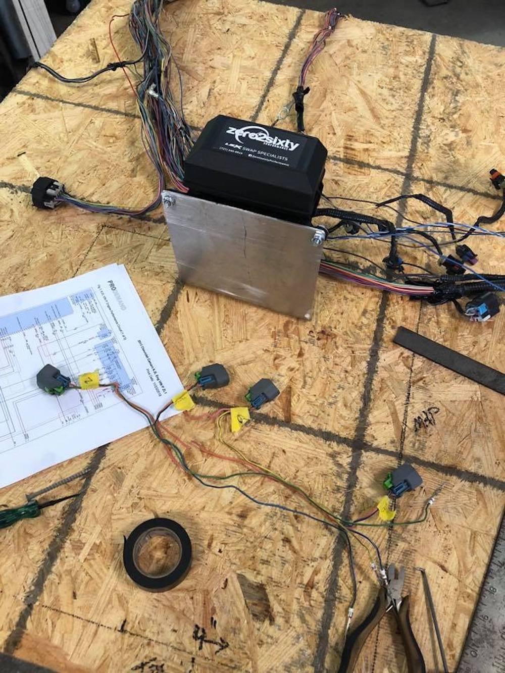

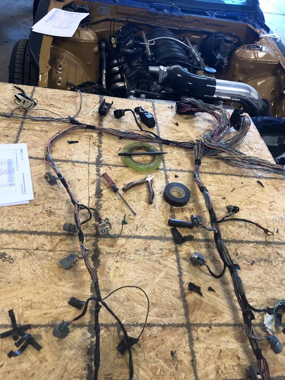

LS Swap Wiring Heroes
When it comes to your swap’s electronics, Lampe says there are a few options. You can “cut down” the OEM harness or buy a universal aftermarket harness. Either way, you’ll have to integrate those into your car’s non-engine systems. “You still have to connect the powers, grounds, and outputs,” notes Lampe. Or, you can contact a reputable shop and order a custom integrated harness that will be, effectively, plug-and-play.
If you’re thinking of doing your own wiring, Lampe recommends, “software like On-Demand, which is what we use at the shop here for wiring schematics. The big thing with these engines is, although the wiring is scary to some people, it’s really very simple to make one of these engines work and all you really need is a 12-volt switch, a constant power, and a ground. And, for the most part, you can connect all the pinks, connect all the oranges, and the thing will run on the floor.”
