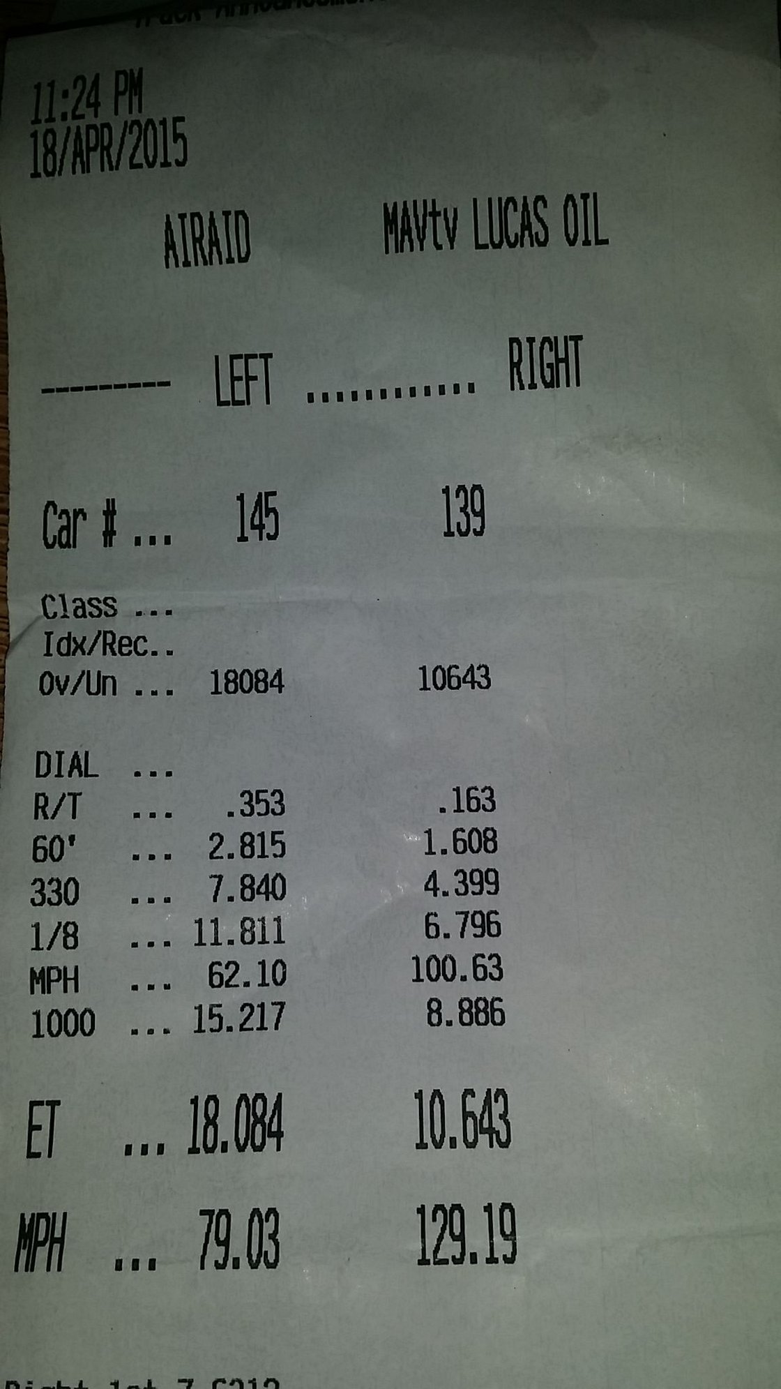

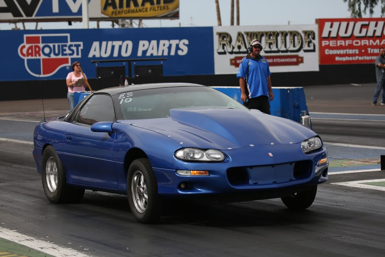

Finally in the 10's!! So happy to have that monkey off my back. I've been testing and tuning quite a bit recently. Made a converter change, beefed up the transmission a little more. Still has plenty more to go, need to work on the suspension, had pretty bad wheel hop on this pass. Combo is a 347 Ls1, Top Gear Motorsports built 4L60e, FTI 3800 stall converter, Quick Performance 9" and a Nitrous Outlet Stinger plate kit.

Nice time!! Car looks mean and clean too!!

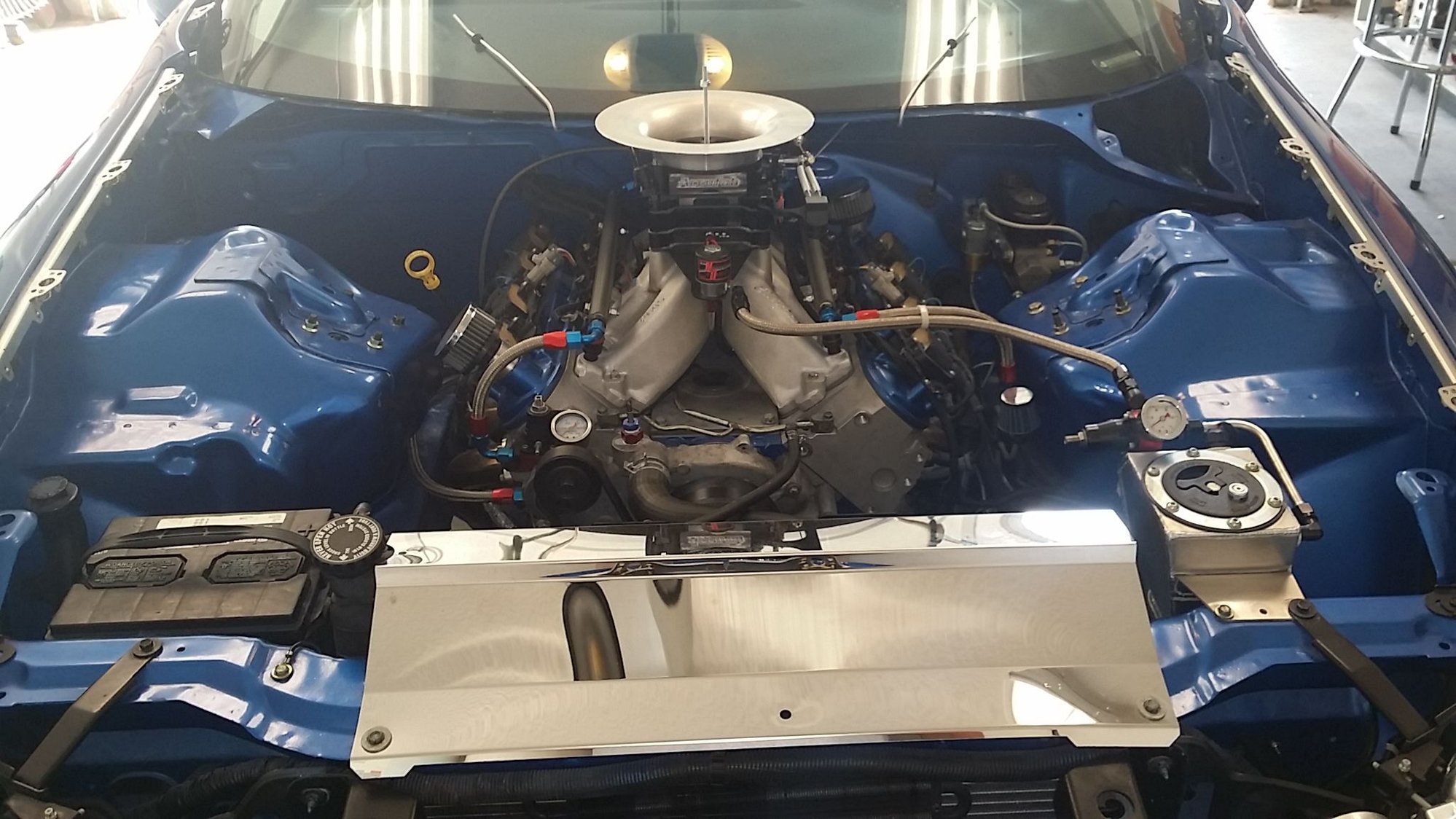

Pics of engine bay? Car looks good and has a ton of room to go way faster if you get that 60 down.

It spun the cars already been a 1.53 60' with some more suspension tuning it will be 1.4x.

Looks good! Yup have faith once you get that suspension dialed in it will be running damn good.

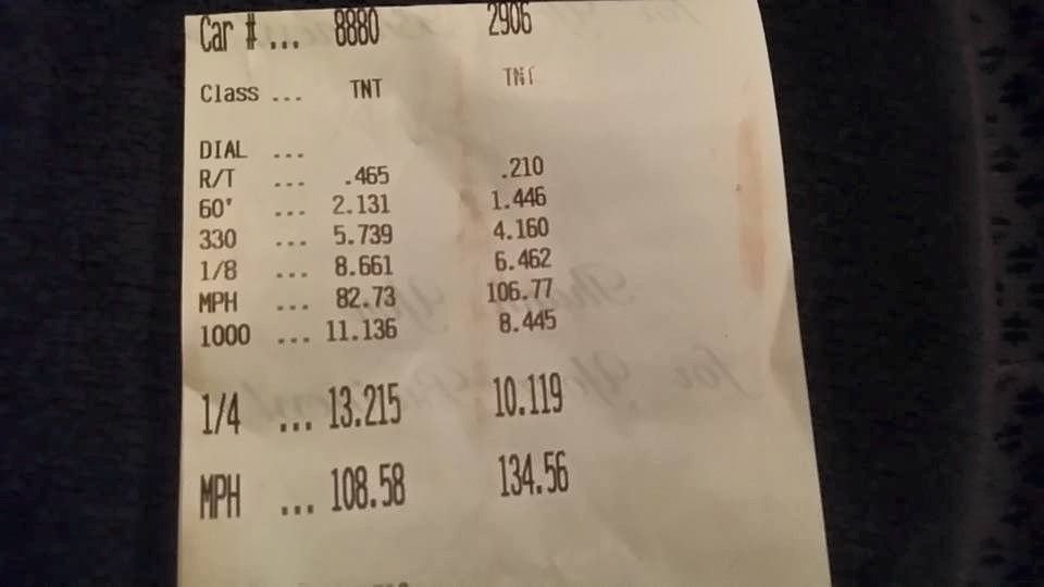

Here's an update, I added a Midwest Chassis anti-roll bar, and I've been working on the suspension, switched from a 325/50 drag radial to 295/55. The 295 fits the car so much better. Stepped nitrous up to .078 jet. Best Et so far is 10.11@ 134 with a 6000'da. Once the weather cools down it should be solidly in the 9's.

Great job! That car is moving for 6000 DA.

Thought about moving battery to the rear or light weight battery?
Car's running strong. Race weight?

I have thought about moving the battery, but it's still a street car so I need tunes while driving around. Nitrous bottle is in spare tire well which leaves no room at this time to put the battery in the back.
Thanks, The car weights 3078lb and 3402 with driver.

One fast street car very nice
