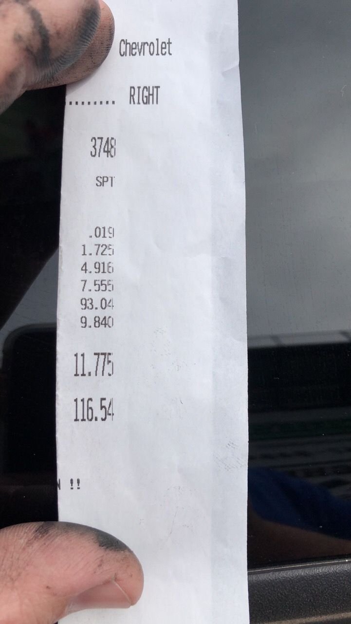

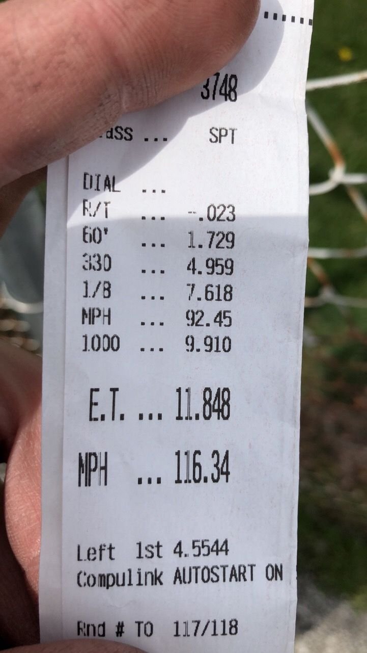

Finally made an 11 second pass.

tq v2 cam
headers
th400
moser 9in 3.90 gear
28 in et drags
3600 stall
aerospace brakes front back viking doubles in front and double shocks in back
left around 2k shifting around 6200

Not bad. Judging by your parts list, it's going to primarily be used for racing. Needs more gear and stall! 3.90's and the 28's are hurting you. As is the 6200 rpm shift points and low stall

yea i plan on upgrading the stall and rear gear...trying to buy a house so gotta watch what goes out

What intake are you running? 6200 shift point seems a bit low

Ls6 intake

Yeah you should shifting more like 6500 at least
