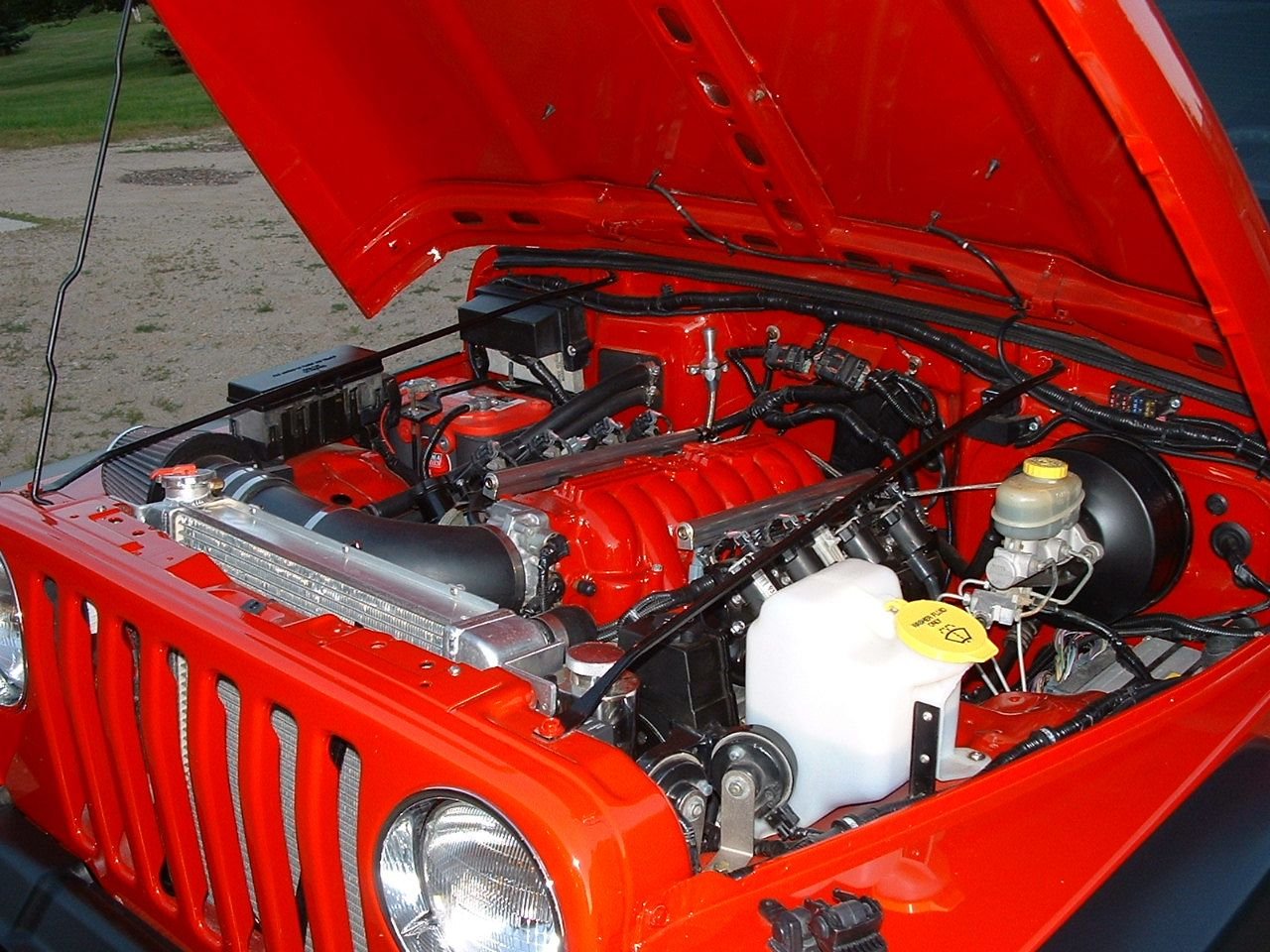

So I have never re-oiled a K&N.
So my long time LS6 swap in a 98 Wrangler last summer I washed it in Dawn dish soap and let it dry. Did not re-oil. So basically a dry filter.
Chasing a misfire so just trying to not to at throw parts at the misfire.
Going to clean the mass air tonight. With "real" mass air flow cleaner. In the past I used brake cleaner which I find out is not correct.

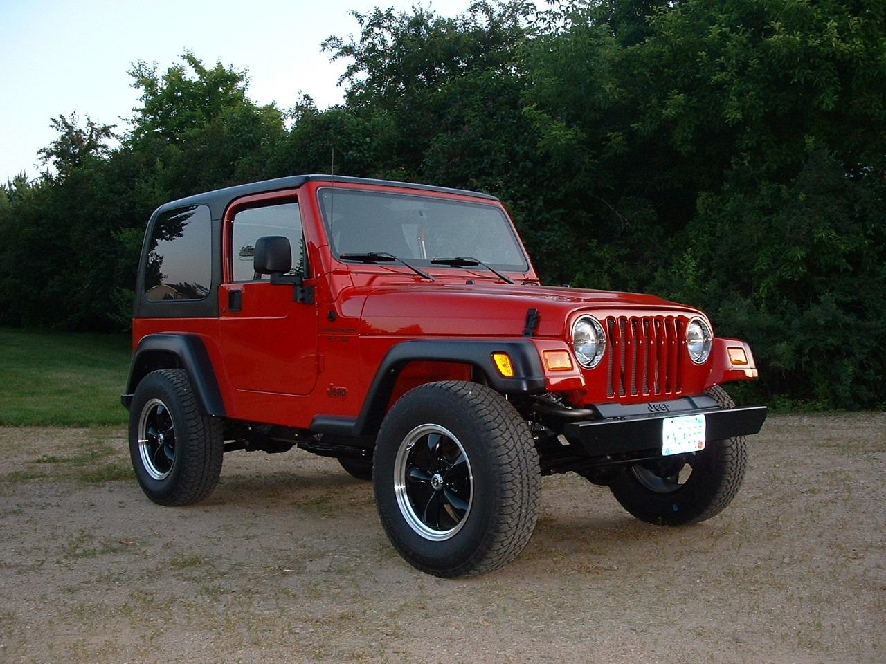

So my Wrangler is not a a off road type hot rod. It's our summer time around town cruiser and short distance car show rod rod. Although saying that we've had it on the Power Tour a couple of times. I did the LS swap in 2008. It has been flawless until late last summer. Just wasn't running like it always has. My code reader says rich on both exhaust sensors.
Folks ask me how is it off road? I say I've had the Wrangler on a couple of gravel roads as long it hasn't rained lately. No mud for me. LOL.
So I'm not worried about any rocks or even any dust.

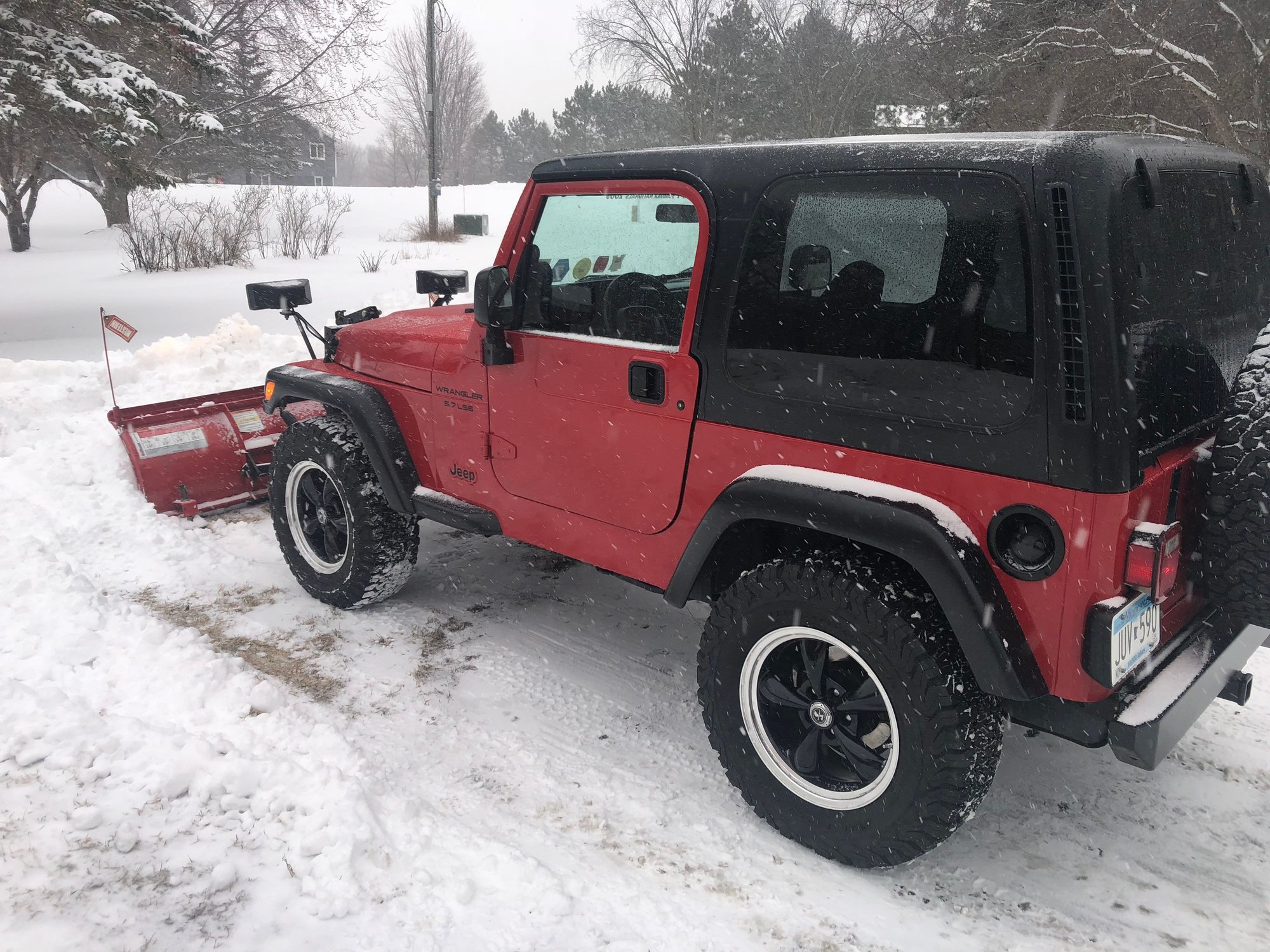

But it does plow snow quite well. No rocks or dust in the winter. LOL.
