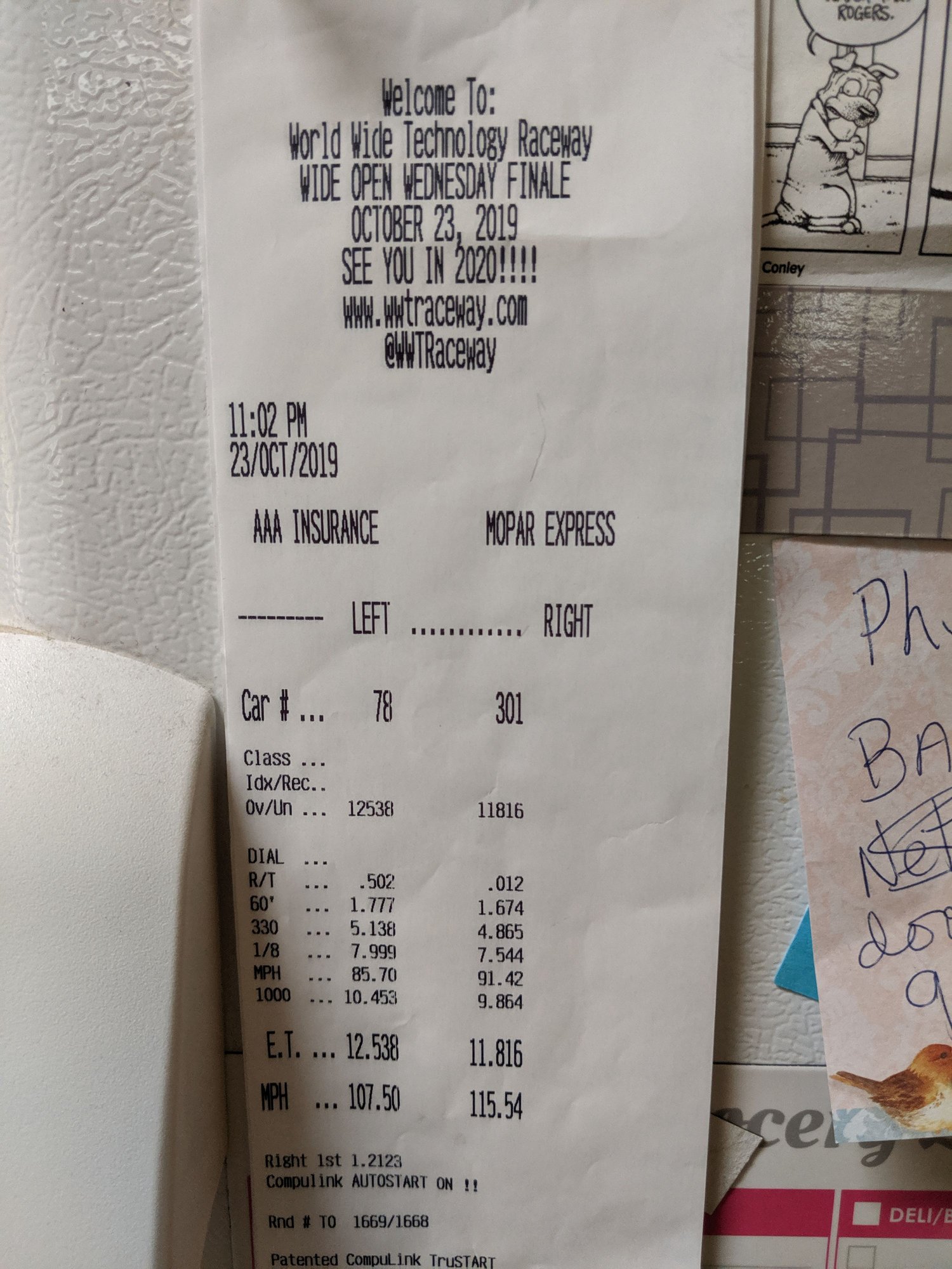

Here we go I finally have real track Data! That's me in the right lane on both all three of those runs. So... I wanted to race last week when the da was in the negative like last year, around -300ft so for a more accurate comparison of my best time ever with the BTR stage III truck cam (11.87@115.3mph) I included a higher da run with the BTR stage III truck cam, (around 2000ft IIRC please check the date and correct me if I'm wrong) but they closed the track because it got too cold last Wednesday. Still, I got to go this past Wednesday instead October 23rd with 65 degree air but the Da was much higher, between 800-1300ft I think according to gateways weather forecast online but the car still got a new best time and mph!
compare the first timeslip of this post (a typical run with the BTR stage III truck cam with the only change being the new summit racing 8714 camshaft) to the other two, note of course all my runs are in the right lane, also if you look at the ones at the top of the thread you'll see that there was still a solid improvement in the cars performance and my reaction time lol. Before I needed really good sea level air to touch 11's and in similar conditions with the old cam (+1000 da) the car would have been running between 12.0-12.2 @ 112-113mph, as I have plenty of old time slips to demonstrate this so I am very pleased with the results of my cam swap, the summit 8714 is doing work in my LS1 Z28 with only ls6 springs and a great tuneup however now I wonder if summit would send me something even more strip oriented lol as it's so tame I've been driving it everywhere! then I can put the 8714 in my wife's 6.0 camaro street build lol (thread is in internal engine section)

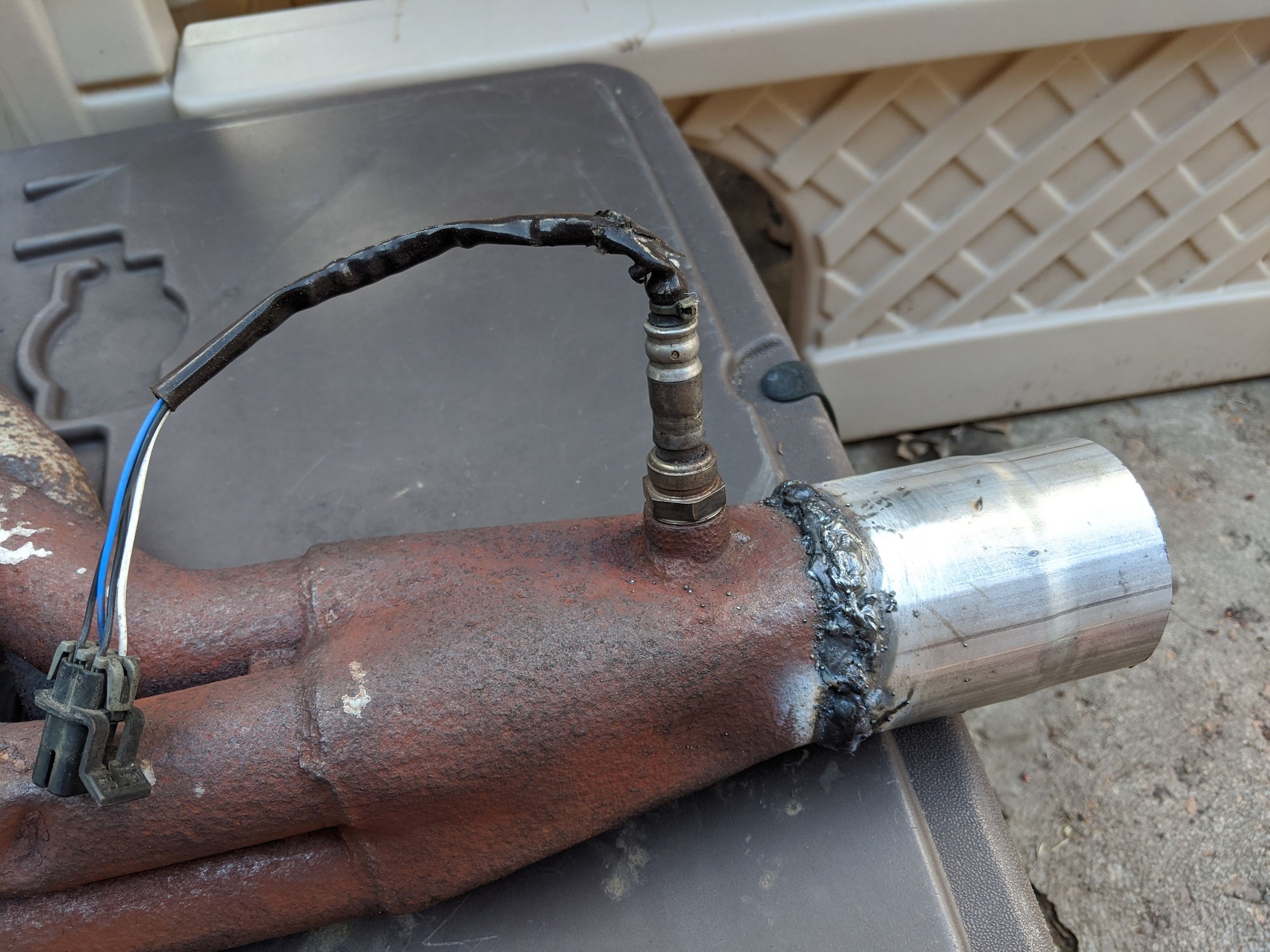

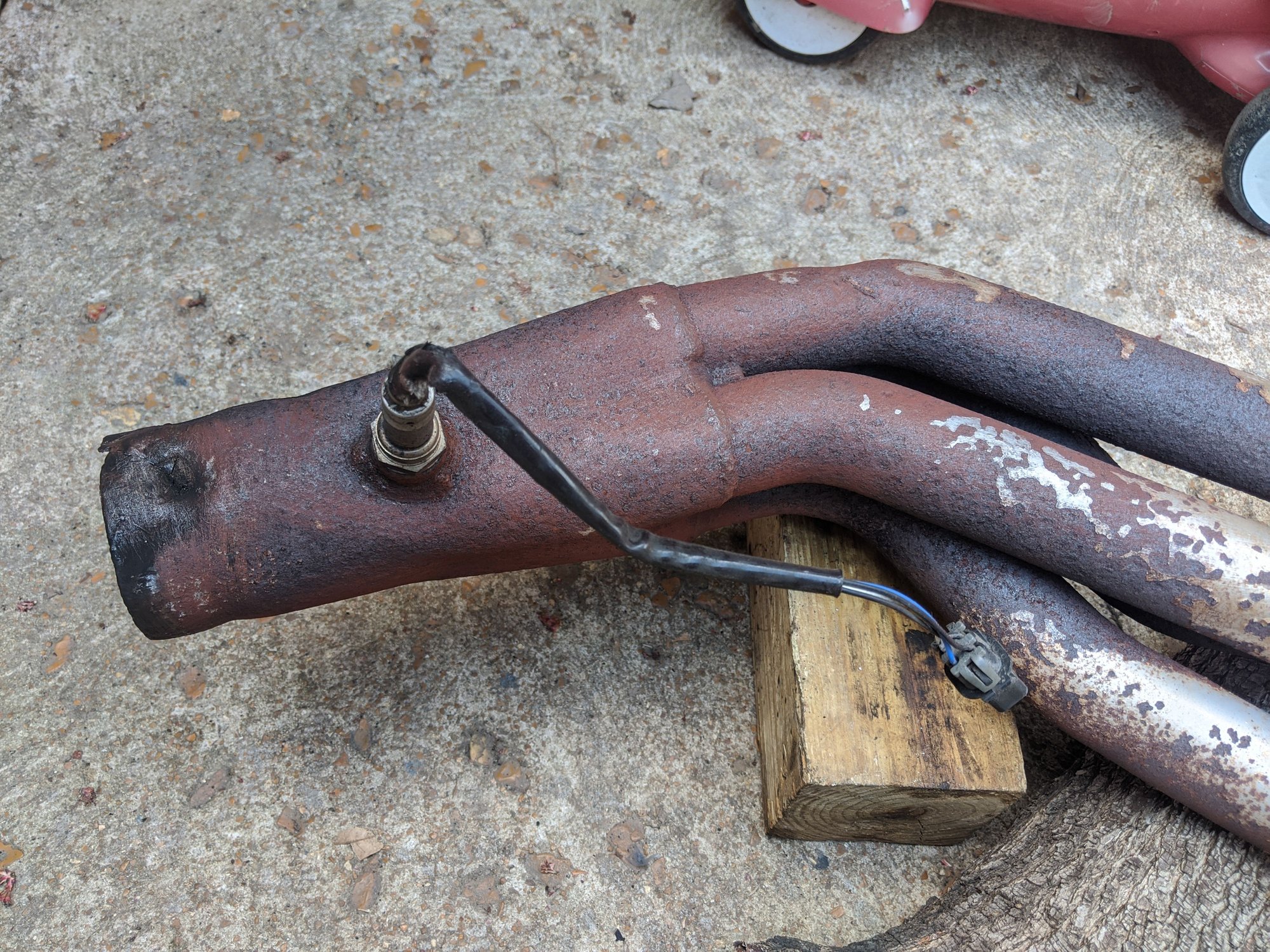

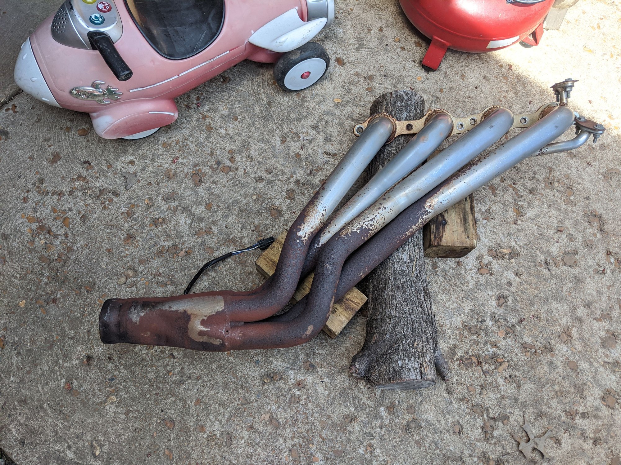

Driver side header has gotten pretty rusty and leaky at the collector, these coated pacesetters have been on this car since 2006!
Nice hole in it and it's all bashed up
Theses things have seen some ****

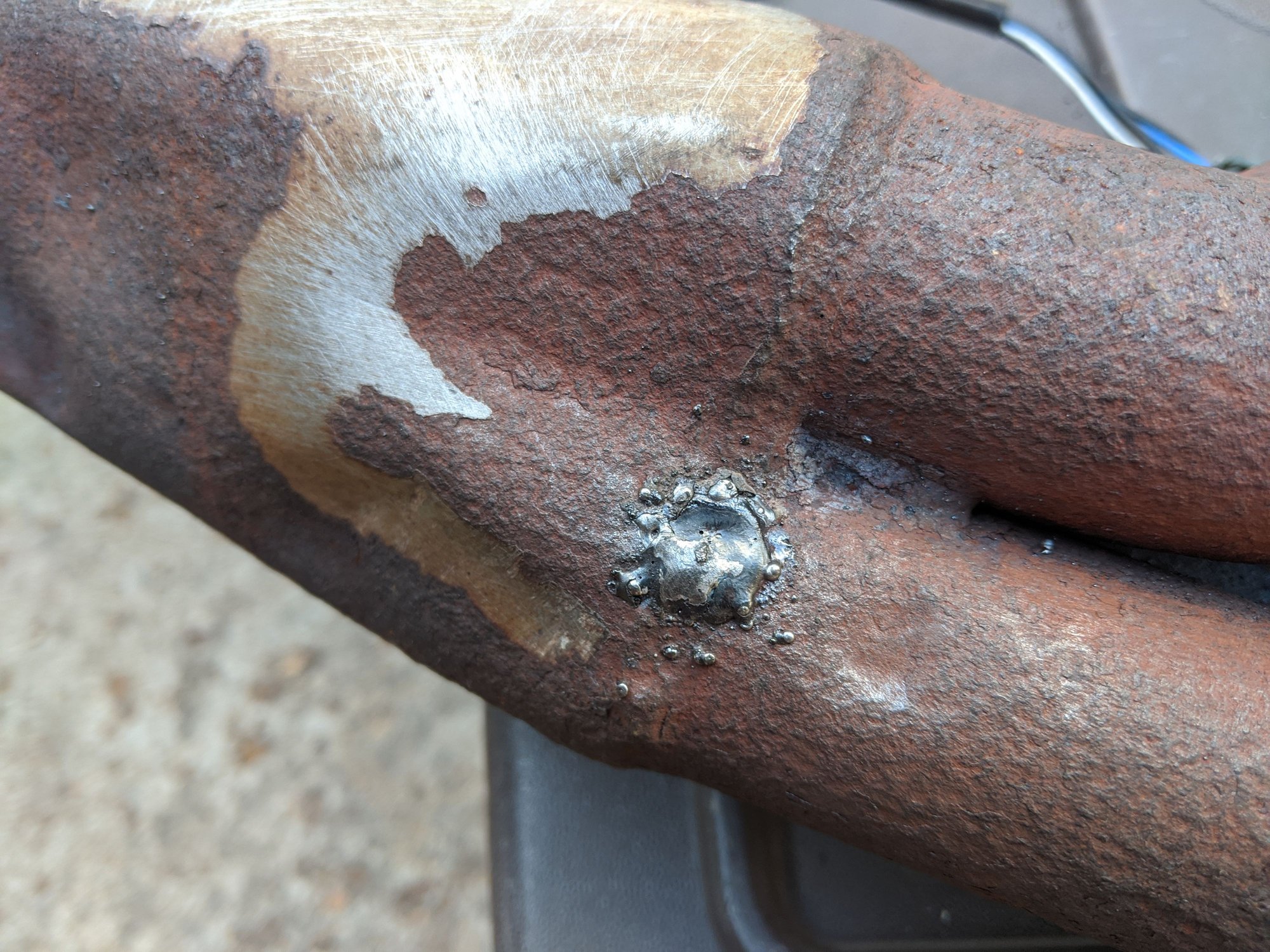

"Ta Da" it's all better now. I fixed it with my stick welder!
Plugged for good, no more fumes I hope!
New collector extension slathered on there and she's ready to go run a new best e.t.!

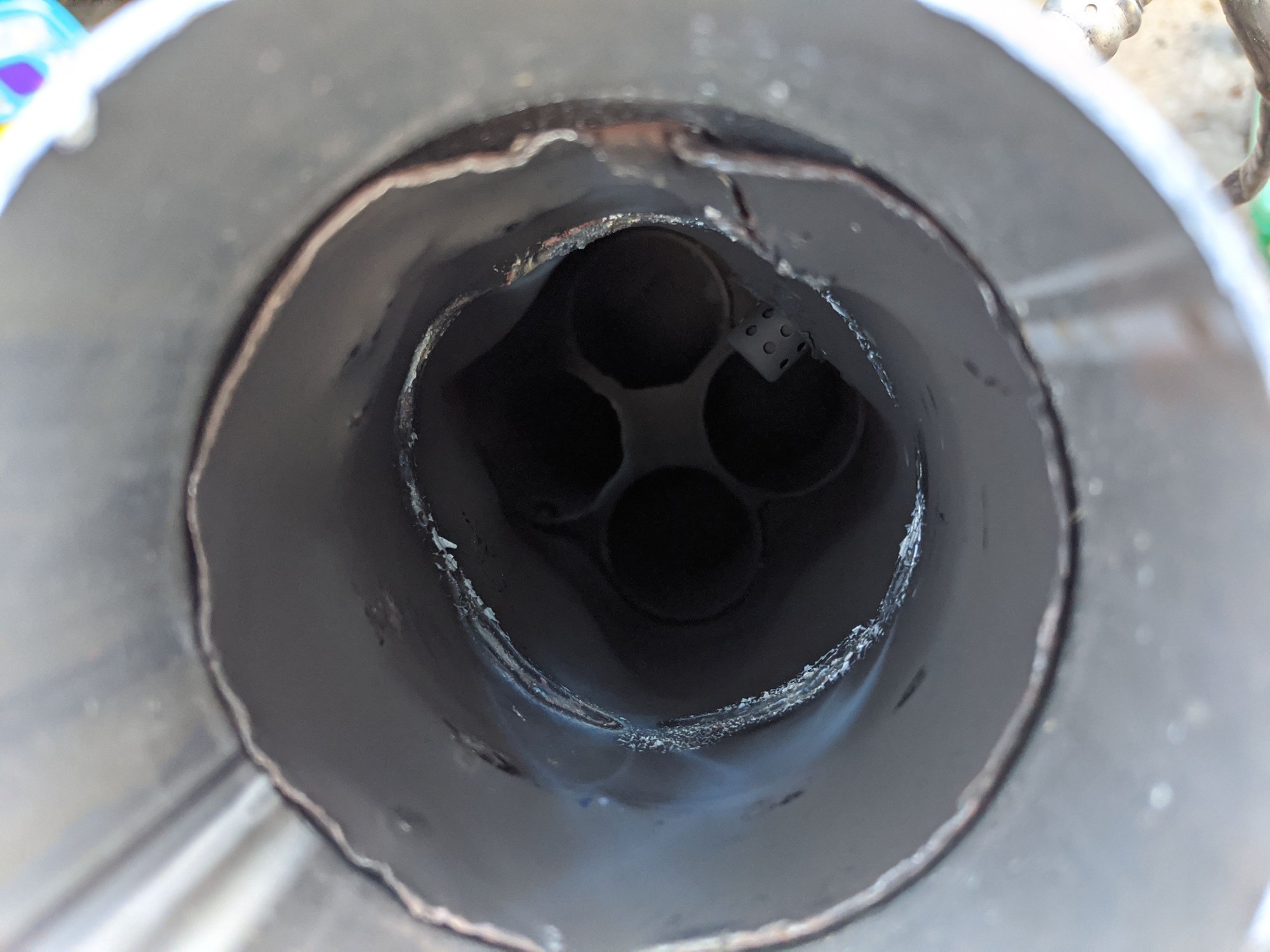

don't look in there, I saw that Hotrod header "test" lol

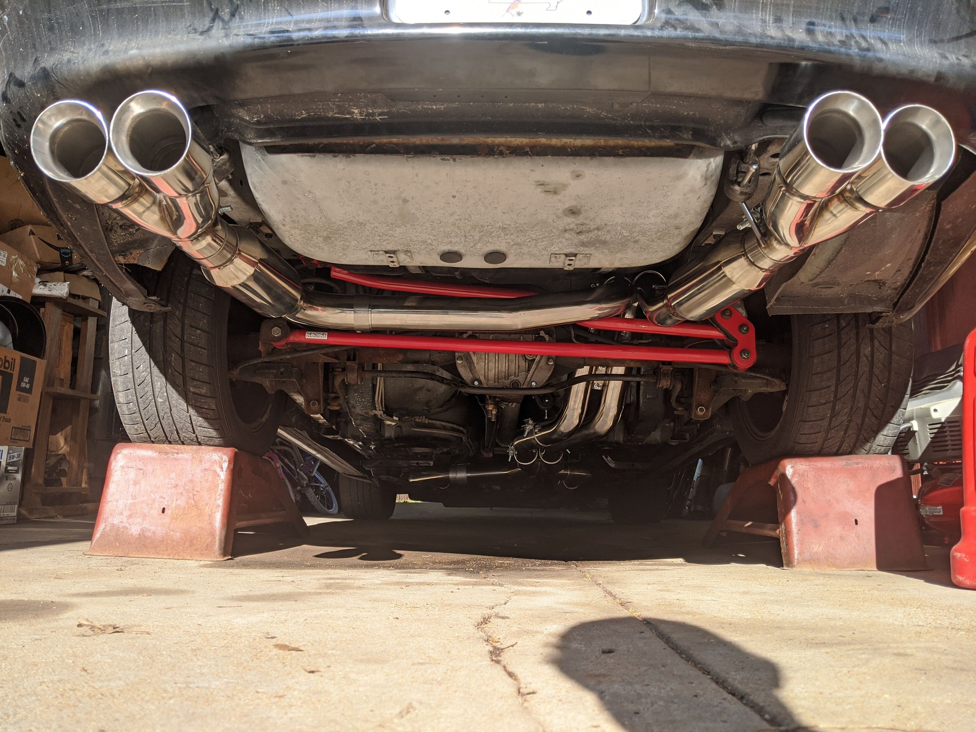

Well I guess if the dragstrip opens this year we'll see if she's any quicker with duals!
Old Apr 25, 2020 | 10:46 AM
  #51
jhshnh's Avatar
Joined: Oct 2014
Posts: 898
Likes: 71
Nice. Kooks?
Old Apr 25, 2020 | 04:36 PM
  #52
stockA4's Avatar
Joined: May 2016
Posts: 1,292
Likes: 435
From: St. Louis
Originally Posted by jhshnh
Nice. Kooks?
Pacesetter headers and those are the $340 eBay duals!!!

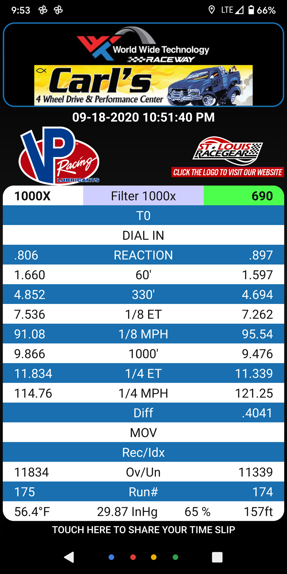

My best et so far this year, left lane of course. disregard the horrible reaction times it was instant green lol
