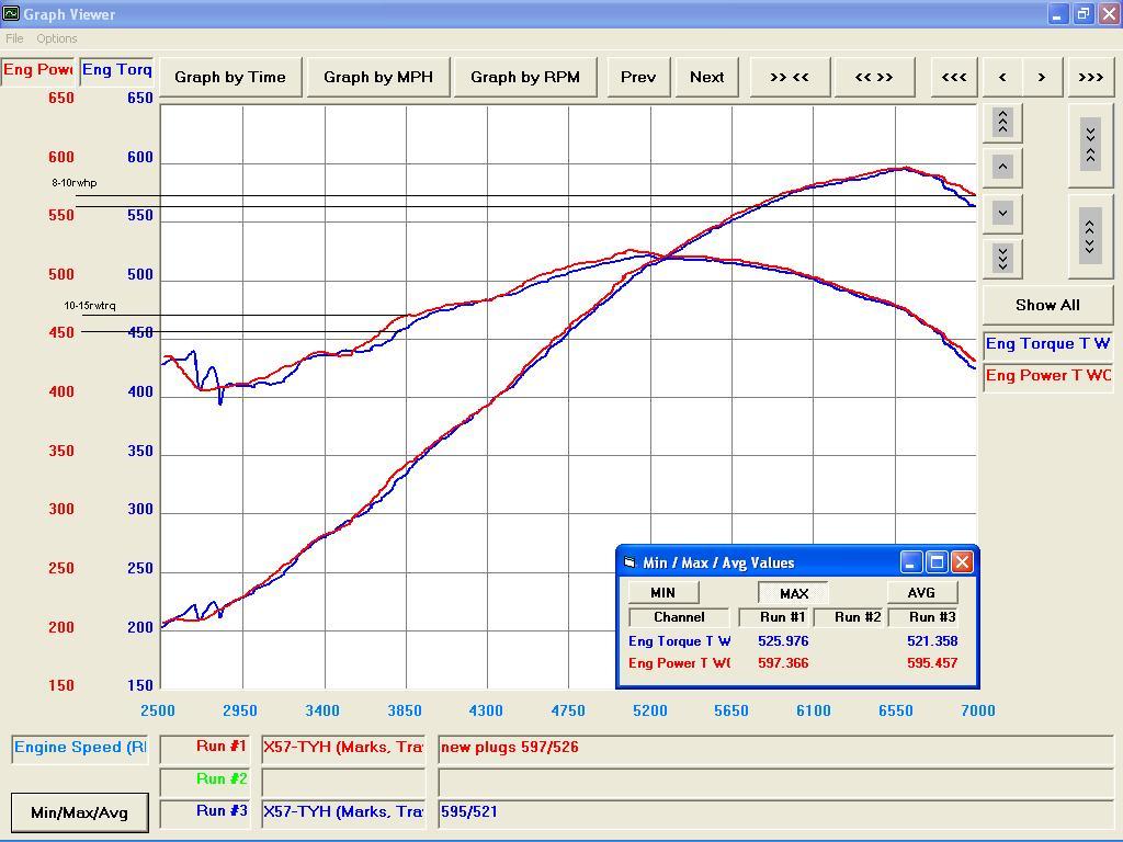

Typically we have noticed the following on LS engines :
- slight stumble most experience at idle is eliminated
- throttle response is instant
- engine smooths out across the rpm range
- clean performing electronics
- reduced system resistance by 99.9%
- power improvements by a few rwhp and rwtrq (dyno attached of our plugs alone with OE wires) To note.. This would be improved on with our ignition coils and wires. Also, this dyno is a third party dyno done by the moderators here at LS1TECH.com in a fair side by side comparison with new standard NGK plugs vs our ExtremeX Iridium 0 ohm plugs.

I guess the next best thing is to compare some of the subtle differences between our wire and a quality competitor wire.
Firstly, as seen in the dyno above reducing system resistance about 10000 ohms by removing the resistor in the spark plug nets a few hp with some respectable numbers at redline. Reducing system resistance 1000 ohms in the ignition wire may give you 1/10th that, or about .4hp across the band so what we needed to accomplish was energy recovery where it made the most sense to gain the highest power possible.
