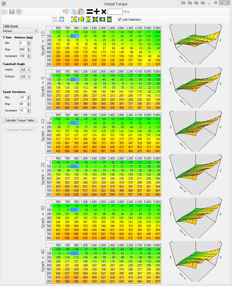

Every LS and newer gen engine from GM for the past 15 years or so has had this information available in the ECM. Just have to open up a file and look at it.
GM was even kind enough to provide the effects that varying spark advance, cam position, E85 and even EQ ratio have on it. Run the old TQ*RPM/5252 and you're on your way...

Originally Posted by Dian
interesting, although i guess these are calculated numbers from a model. where does that come from? i havent seen it in efilive on any ls1 OS (on ls7 i havent looked).
Those specific numbers are an output of a response surface model, but the torque values used to generate the response surface coefficients are from thousands of hours of engine dyno effort.
