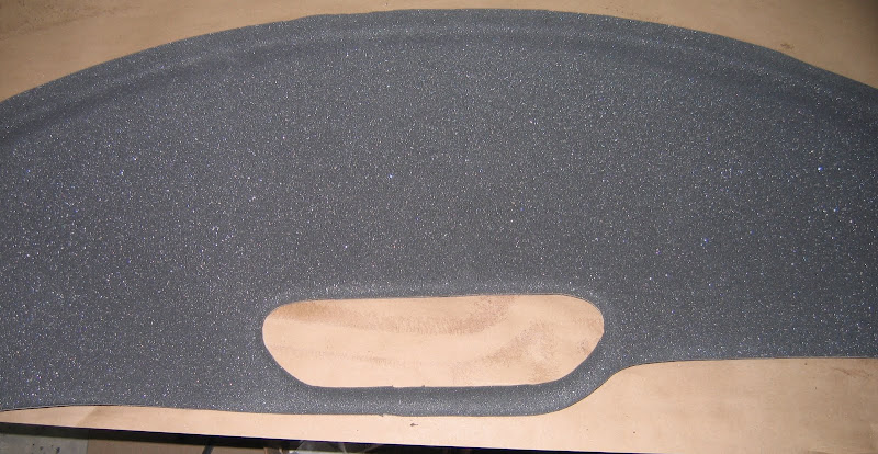

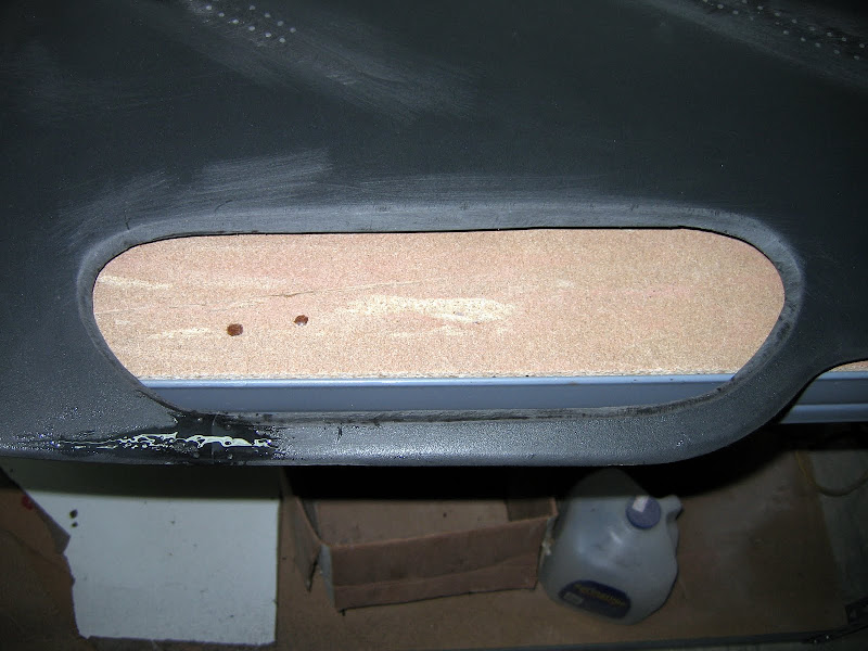

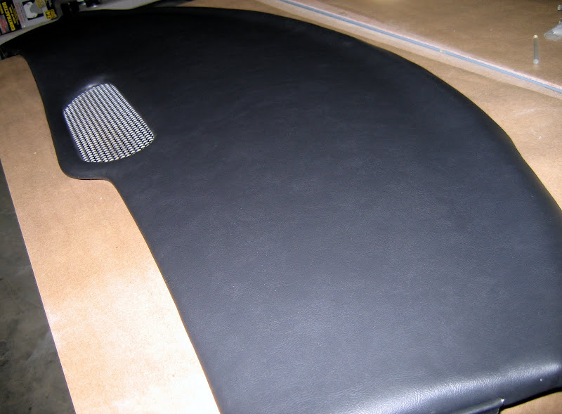

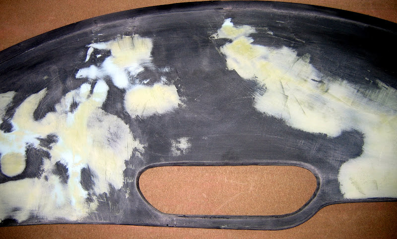

Yup, that's my handy work. Guy got a real good deal as I would probably charge twice as much the second time around. Padding is optional the way I repaired it, but does give a better feel to it. Several options on the vent area, but club member wanted polished aluminum to match other things in the interior. Epoxy I used failed to hold the clips in place once mounted, but the velcro hold it well enough.
Dash was really too far gone when I got it, and the act of removing it caused chaos. But a deal's a deal and I saved it.
Super glue with accelerator to piece it back together:
Drill holes on either side of every crack:
Scuff the entire back side with 3M pads:
Tape the front side of cracks and fill the back side with two part 5 minute epoxy. Lay fiberglass strips into epoxy:
Layer back side with high weight fiberglass cloth:
Resin it up and let it cure:
Fill in holes that didn't get full:
Cut and shape defrost area:
Sand top side and smooth it out with some lightweight filler:
You could wrap it at this point, or cover it in upholstery foam:
Wrap it up:
Tuck it under and glue:
Cut and shape the desired vent. Glue it on and reinstall:
Kevin D.
