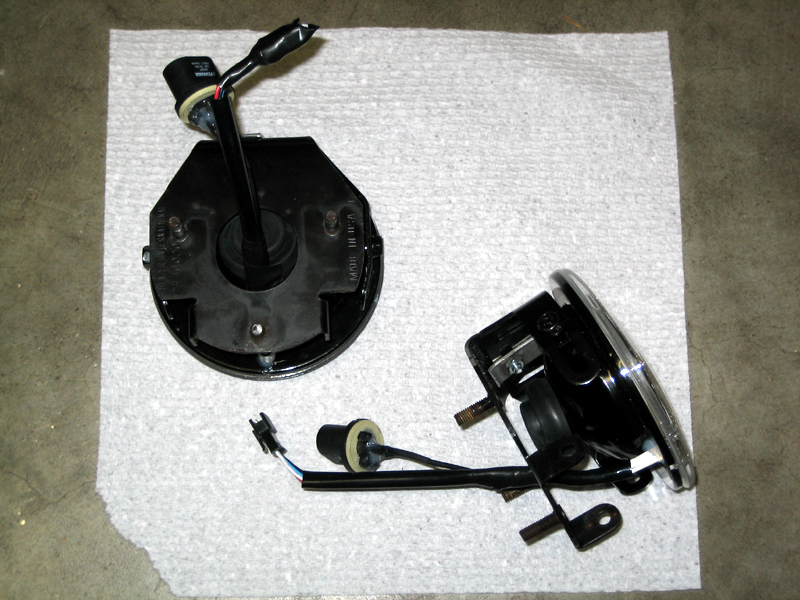

I have those fog lights too, although with a different brand name on them. The same thing was sold through a few different brands.
Here is my install on my 2001 Formula:
http://www.fadingarrow.com/FogLights.htm
Here is Blue2KTA's install on his 2000 Trans Am:
https://ls1tech.com/forums/pontiac-f...og-lights.html
Both of the above write-ups are also in the Lighting FAQ.
https://ls1tech.com/forums/appearanc...hting-faq.html

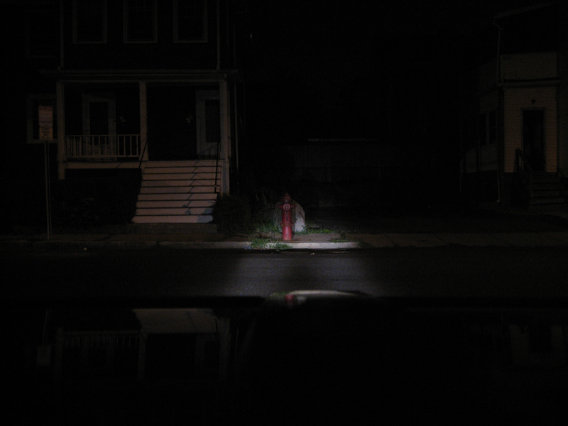

Although brighter than stock and more durable, their beam pattern is not a fog light. It is closer to a driving light, but still misses that too. Its just not good. A fog light is supposed to have a low wide beam, not a conical pattern with bright center. These are not fog lights. I leave mine off.
Definitely don't put HID in those. You will blind everyone with that beam pattern.
Actually, I'm tempted to move the stock LED Grill Fog Lights from my 2013 Mustang GT to my Formula if they'll fit. Since I was thinking of changing them to a set of projector fog lights in the lower valance.
This is how a fog light beam pattern should look:
(I found this pic on Google)
