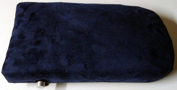

Originally Posted by countryguy1717
Do you think mdf is better than regular wood? I have some scrap mdf. Id just need to find the right foam and vinyl
depends what "regular wood" you are speaking of. If comparing it to say plywood, then HELL YES, it is much easier to sand and can be "shaped" (sanding to create a form) better then plywood ever would. The only comment on MDF is to "seal" it with a coat of fiberglass resin if it would be placed in a position to get wet.
Ideally for something like this I would try to get my hands on a solid piece (13"x8"x2" just a bit oversized) of like white pine or douglas fir or oak and then shape it with a sander and stain it, but the MDF would be a cheaper "trial run" for a proof of concept.
you could even add a magnetic latch where the old one was to hold it shut.

I like the attempt and it is a good temporary fix, however this is one of those items where I just suck it up and pay for OEM or similar replacement. It sucks that they're expensive and are still poorly made, however I don't see how I could make anything that looks half as good as the stock piece.

The factory lids SUCK, they're expensive and not designed to have any weight applied on them, so they don't last. I've bought 2 replacement lids over the years and finally made one with 1/2" oak plywood, with 3/4" of closed cell foam rubber glued to it and covered it with speaker box carpet.
http://i523.photobucket.com/albums/w...ngwheel002.jpg
http://i523.photobucket.com/albums/w...rapdoor013.jpg
I don't think it looks as smooth from the top as countryguy1717 lid does but it looks better on the bottom, I also re-used the factory lid hinge. Mine was originally only going to be a temporary, but has remained on my console for several years now. Hell... if I could find someone to build a sturdy and nice looking one for $200 or less I would of bought one by now, but that hasn't be the case.
Anyway, my hat goes off to you countryguy1717 for posting up your functional lid, because I knew you would get flamed.
