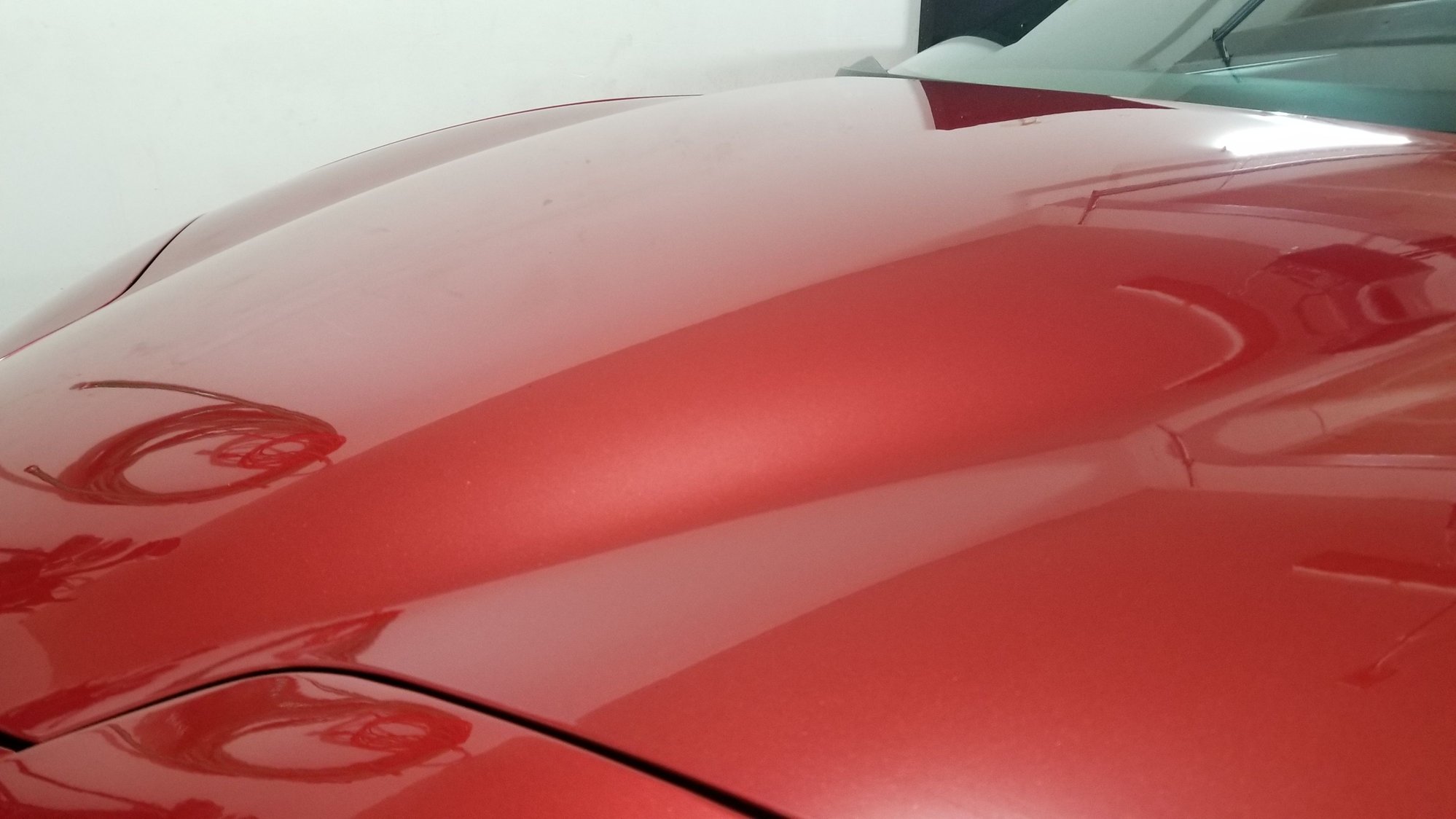

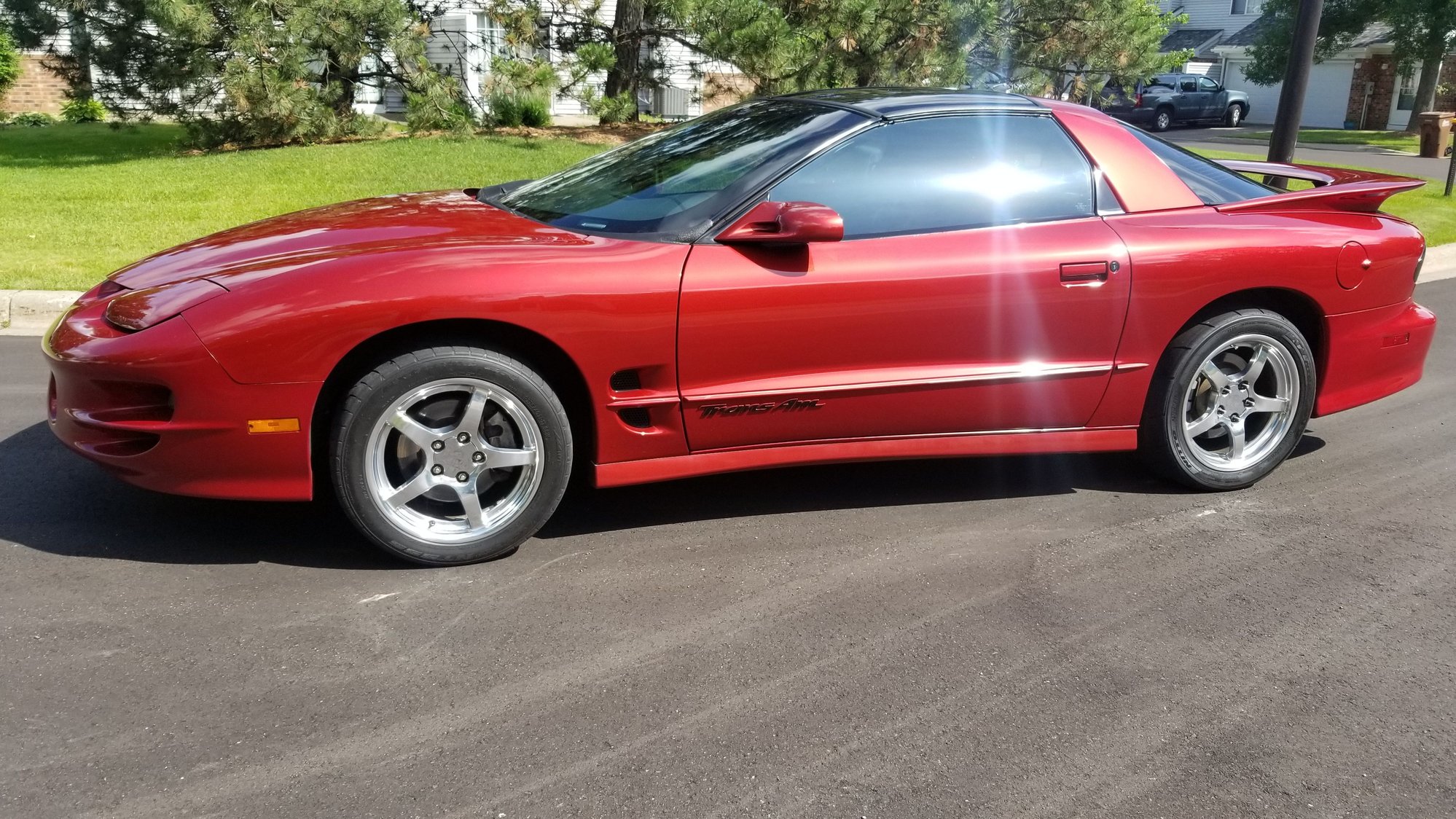

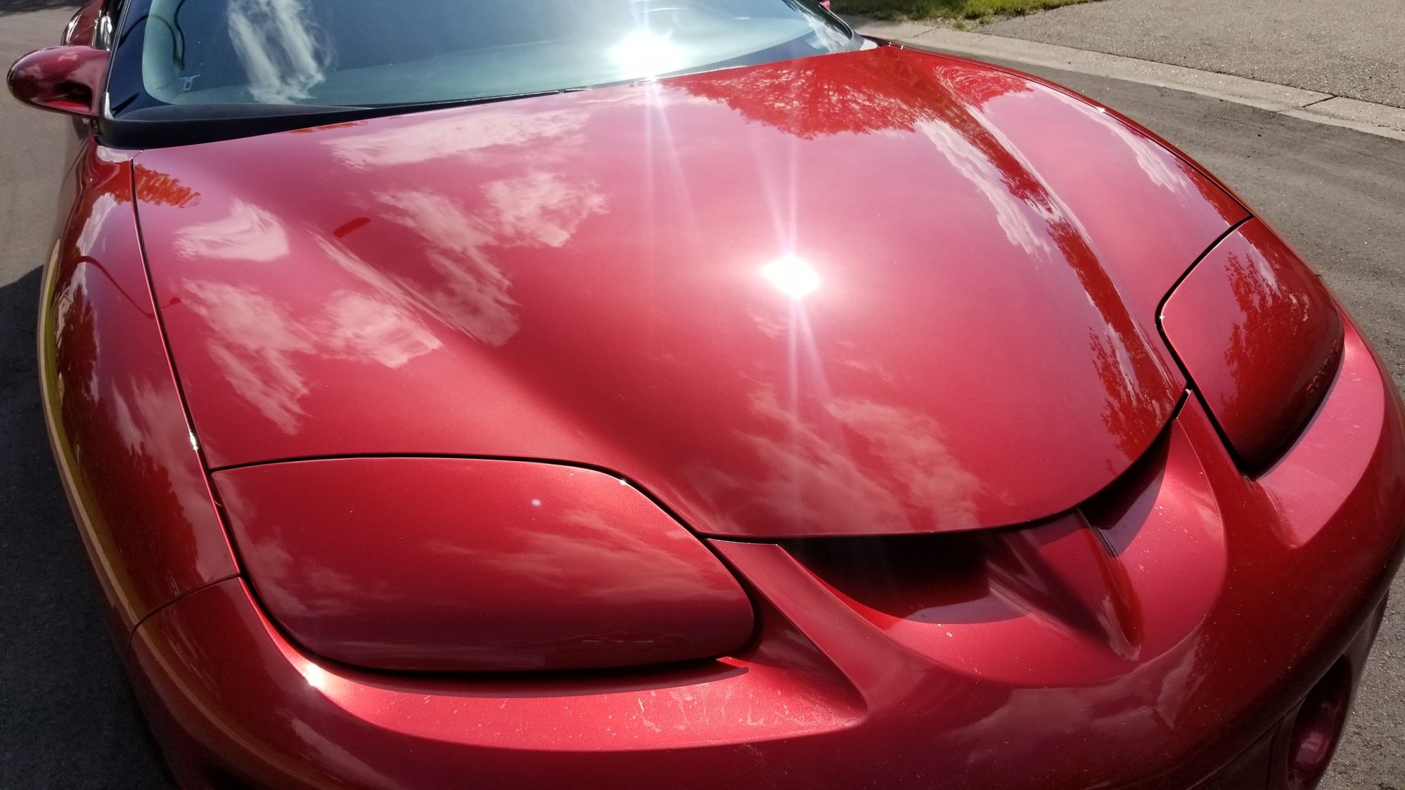

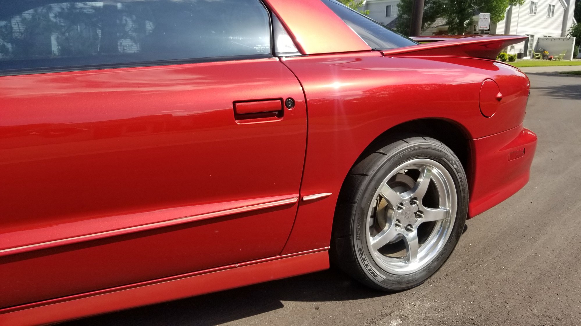

Loved the Kamikaze Zipang so much I stripped off the Cquartz U.k and applied it to my car.
Stripped it down with Menzerna 3500 then wax and grease remover then applied the gold.
