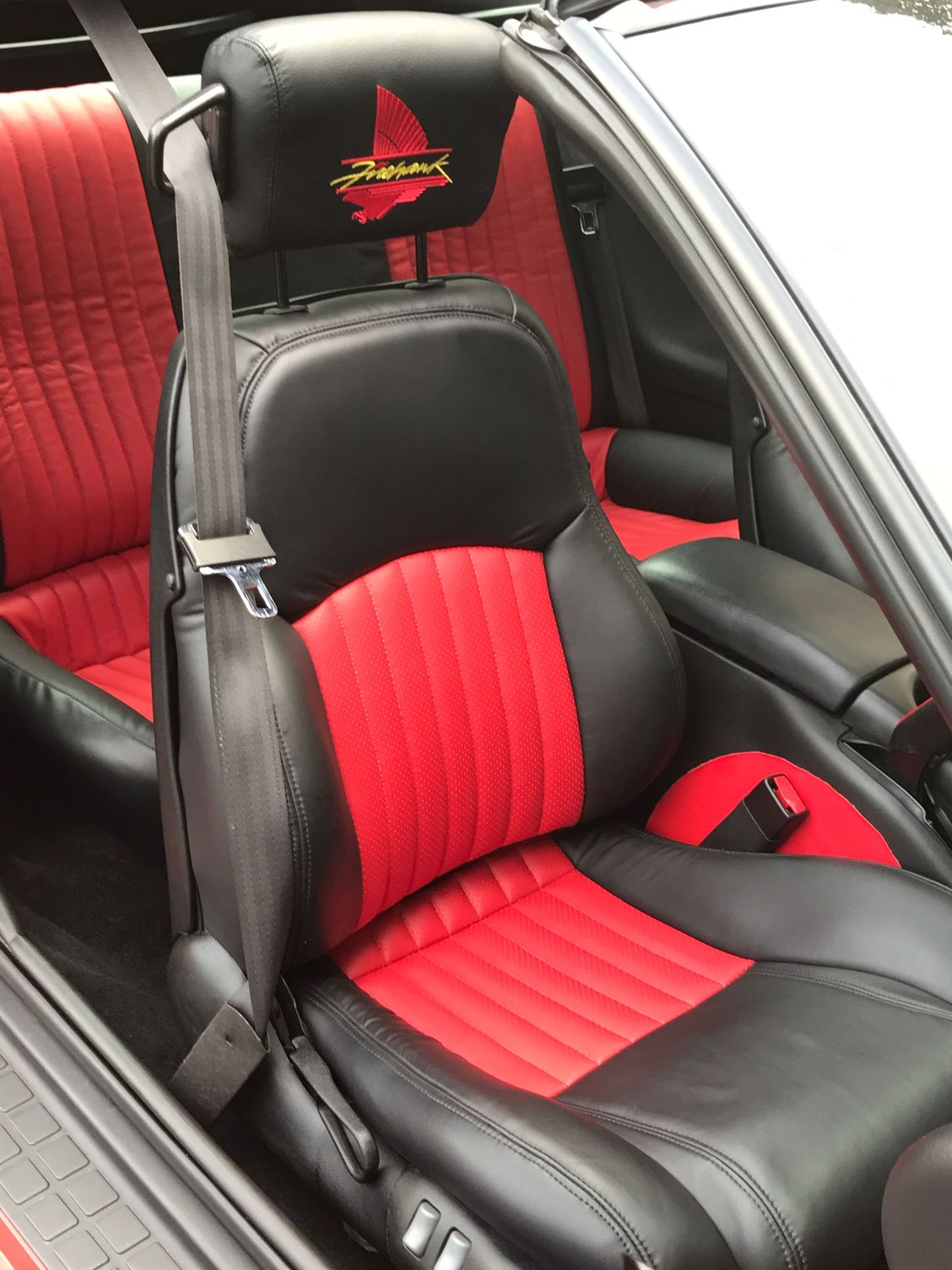

Nice set for the camaro style seats @Chrisingermany
Here is a full picture of mine installed, im happy with them!

Looks good! Is that red fabric between the seatbelt and center console to stop chaffing between the two?
That's the idea. The 1/2 circle (on each side of course) is glued to the center console to protect it from the seat belt.
I'm not 100% happy with it, but it serves its purpose for now.
