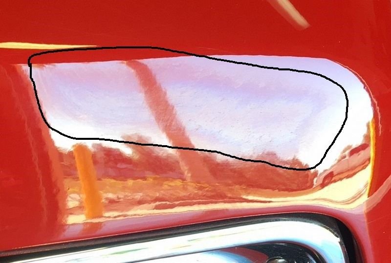

You can not wipe it off properly and have high spots that look like dog **** and is a pain to remove.
Here are two examples of high spots. In the first picture circled in black you see that rainbow look, that will not fade or ware off any time soon....as in years.
The second picture the high spot will also look like a rainbow in certain light but also gives the paint a cloudy un-clear blurry appearance

I can only really speak of CarPro Cquartz Uk 3.0 but the work time depends a bit on the moisture and temperature. With that said I do not leave it on for more than around 60 seconds. You will feel a very slight resistance when wiping it off. If left on a bit to long you will feel a lot of resistance with your micro fiber.
Most high spots are the result of just straight missing or forgetting to wipe a certain area. Like those pictures.... those were just total misses when wiping clean. Most colors you can see your work but light colors like white, pewter, silver can be very hard to see your work. As long as you are thorough, patient and give yourself visual borders you will be fine. What I mean by visual borders is say... pick half the fender and go to the body lines stopping at the hood gap, stopping at front bumper lines ect. then wipe off. Move to the right and do the right side of the fender again stopping at the hood gap and stop at the fender to door gap, wait then wipe off. Organized and you will be fine.
If a high spot is left it will stick out like a sore thumb in natural sunlight. It can be removed by hand and some compound but is a work out due to cquartz uk being a very hard coating. Best way would be to remove it by machine and some polish/ compound.

To add a little to this, the best way to see high spots are with indirect lighting in most cases. While I'm wiping a coating off, I usually have my LED lights shining on the wall to reflect on the car rather than focus the light directly on the surface. For the lower panels I typically will shine the light on the floor to reflect back up. Certain lighting conditions will lie to you, so be aware to test lighting from several different angles and conditions both in the garage and outside.
